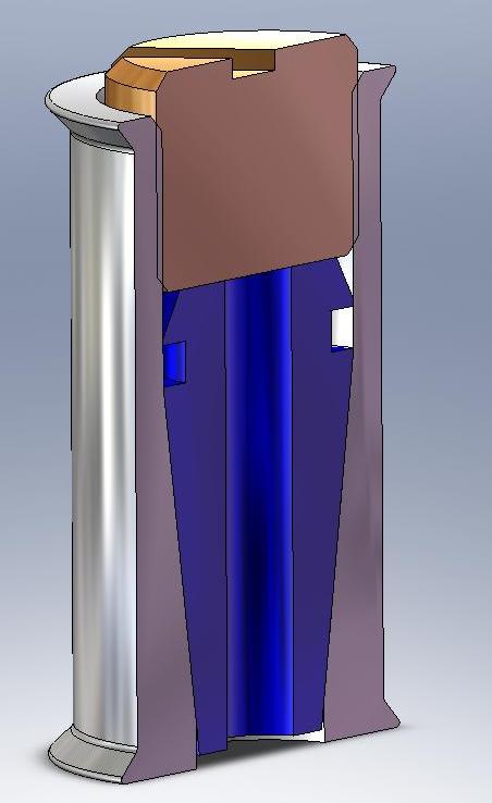

Greg Nuspel said:ER collets are spring steel so up goes the mass. Also collet are about $25.00 each. One would look something like this.

The brass pulley was 80 grams. How much would this weigh? This would be a cinch to remove. Hex bolt on top might be nicer.

Spring steel, especially in a collet will work against the "less resonant" approach. It may sound or look cool but I'd stick to your original design.
A threaded hole to remove the pulley is a simple feature that will help everyone. All of my pulleys use opposing set screws and work perfectly well too, no runout and easy to remove. I shy away from press fit on these motors because of the small 3mm shaft, too much pressure installing or removing could damage the shaft or motor. Forget about crowning the pulley for use of tape, doesn't work.
I've made upwards of 50 pulleys for these motors and none of them have failed (perfect concentricity), simple to make with the right process. I believe you have the right process to do the job so good luck.
BTW, large brass pulleys create too much side load on the motor shaft and cause vibration, even with perfect machining since the shaft doesn't extend far enough beyond the housing to give proper support. I have a small, compact brass pulley that works well but I also have a larger one that doesn't. Personally, I don't see any benefit using brass anyway. I've made pulleys from Delrin, Vespel, Aluminum, and Brass, and Aluminum works perfectly well, YMMV.
That seems heavy; calculated weight is 8.5 grams, I just checked a ER8 3mm collet and it tips the scales at 2.5 grams. So this is most likely a possibility but the cost will be more. Lock screws are $0.40 each the pulley would be reasonable and I am waiting for a reply on the cost of the ER collets from one supplier and will check with another on Monday. I'm sure the same can be done with the string pulleys. Neat thing is these collets can be changed out for sizes 0.5mm to 5mm to match other shafts. They are made to a maximum run out of 0.0005.
I have to check out what size of boring bars I have to do this small of a bore, it's a 5x reach so it will have to be solid carbide. I may have to figure in a tooling charge but over 50 units it should be within reason. I think we are only looking at an additional charge for the collets. I guess the first thing to do is find out how many people would be interested in these over conventional pulleys.

The spring steel is securely clamped against the shaft and the pulley. Spring steel is used to allow the collet to collapse. If you look at a drawing http://hardingetooling.com/imagegallery.asp?ID=2093 of one you can see that there will be a very solid coupling between the shaft and the pulley. Trust me when I have one of these spinning a tool at 30,000 rpm I don't want spring.

I realize that, my shop is well tooled with these type of collets. If you feel good about it, go for it.
I think we should set on the two opposing set screws approach right from the start. It is easy to implement, known to work correctly and cheaper than other alternatives.
