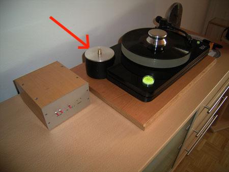

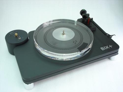

I already found an elegant solution for the motor pod from an other user project. It is a BIX Turntable motor pod. You can buy the motor housing alone, prices are (very reasonable I think):
Motor house 80 U$
Pulley 12 U$ (can be use in this project as well
I got the contact info on how to get these parts. From other user, I got that this pod is nicely done, black anodized. Dimension is 9cm height, not including pulley and feet. Rubber feet 3mm tall are removable.
Then, we only need to have a custom top mounting plate and we have a very professional looking motor pod. This is what this user did. Check the picture. I also have the custon plate drawing for this specific motor enclosure.
I can probably arrange for a local machine shop that I know to build the plate for us. Cost should be around 200$ for 4-5 pieces, so about $40 for the top plate.
