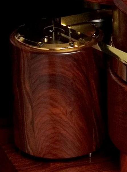

An other user just contacted me, Ed LaFontaine, is a wood turner. He offer to build maybe a wood custom top plate.
I mentionned that maybe not for the top plate that need rigidity and has to be very thin since the motor is very short, plate shouldn't be more thick that 4 mm. But that said, I'm not an expert in mechanic, metal stress and all this questions, so I may be wrong as well.
But maybe some may be interest to cover the motor pod with a nice wood covering as some of the Teres top model, see picture.
That would certainly improve the resonance control of the original BIX motor enclosure. It can also be use to increase the motor base and/or height if needed. Not mentionning the really great look that it can give to the motor pod 😀
An other possibility is a record clamp for the Teres.
I offered that he joint this thread discussion. Feel free to express your interest and comments.
Wow, that's the pod I am looking for! It will be even better that you sandwich the BIX pad, a layer of rubber, then the wood covering. I'd go for that!
A 33/45rpm capable SB definitely will be the choice! 🙂
Don't get too excited yet. I'm not the one that will do it 😉
I'm just suggesting that Ed LaFontaine may do it for some of us, if he's interested. But that may be interesting indeed.
