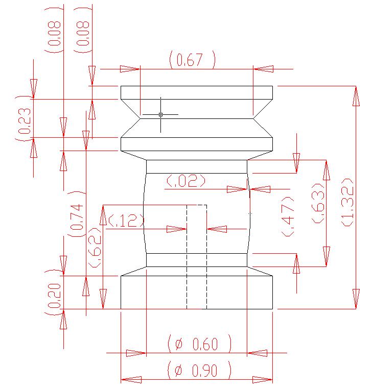

In the meantime, here your original design ACAD drawing with all the quotes. As you mentionned that the crown curve was maybe too much, I cutted it in half on this drawing. Please comment.
If it seems like a sound design, we can go ahead with Greg and get some estimate. I think we can hit for at least 50 pulleys.

The pulley looks easy enough I suggest a 2mm thread from the top so you can use it to pull off the pulley. I may have to order in a smaller micro boring bar to start the bore to ensure concentricity. I can ream the hole .001 under-size which is a tight press fit, it would most likely be better to ream it at 3mm since size on size works as an interference fit. Slight warming of the pulley would make it slip on easy.
I actually would prefer to make separate string and belt pulleys for the people that would want each type. This would lower the mass in both applications.
For something this accurate I prefer to use 7575 T6 aluminum, it is much harder and stronger.

If we are going to use tape we cannot use crown pulleys. This according to Vinyl-Addict who originally designed the pulley for a rubber belt. It has been reported that the crown pulleys cups the VHS tape belt. This problem would be exacerbated by using the thicker McCormick holographic tape. I guess the original GB did not really pursue using mylar tape as a belt as it was only in its infancy.
It has been recommended that we anodize the pulley for higher cf and prevent oxidation.
The design requires a tolerance of .0005".:bigeyes:
17mm is the recommend diameter for optimum performance for 300mm platters, I'll be using a 311mm platter. I would assume that the majority using a tape drive will not be using a sub platter. Otherwise, there is the Teres.

Collet mount is expensive, the easiest size to get that would fit this application would be an ER-8 Collet. I can find out what a large order of 50 would cost but I predict it would be at least the price of the current pulley alone. You wouldn't want to use inexpensive collets as the run-out would be too much and unpredictable.
The reason for the tapped hole to be used for a puller is that everyone doesn't have a proper puller.
