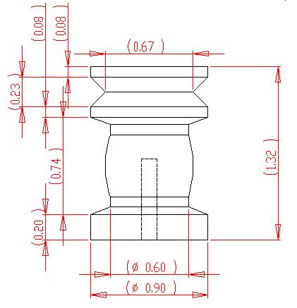

I got the ACAD and Solidworks file of the original pulley, thanks to DaveM. Here it is.
The top section, for string/rubber belt drive is has 0.67" diam or 17mm.
That give a pulley to platter ratio or 305/17 = 17.9, much lower than the maximum of 24 specified by Mark.

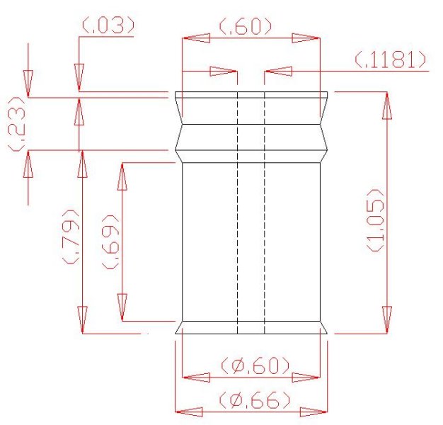

With the help of DaveM, I started to work on an upgraded (ver 2.0) custom pulley. We will try to get a quote for it.
Changes that I suggested:
Some of the original pulley problems, according to some, I don't know myself, I never use it, were:
-Mass. I think it was made in brass and it had also both string and tape pulleys in just one assembly. It seems that the best pulley has the lowest mass. Is it possible to have the pulley made of aluminium instead of brass?
Is it also possible to reduce the pulley dimensions. Look at the included proposed drawing. You can see that the shoulders are much smallers.
I kept the original diameter of 0.6'' (15mm) that was recommended by Mark kelly.
-Blind hole. It prevents the use of a puller to remove the pulley without stress to the motor bearings. Is it possible to have an open mounting hole (thru hole)?
An other advantage of the thru hole is you can mount the pulley in the direction you want for best result according to your drive system. For example, if using tape mount the tape pulley side first closer to the motor bearing for reduce mechanical stress on the motor. If using the string, belt, mount it up side down, to get the string pulley closer to the motor, same advantage :angel:
Just suggestions, I'm not an expert in mechanic.
It is open for your comments as well.

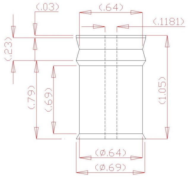

According to Dave, Mark said the the optimal diameter is 0.67" (17mm) to get the best stability at 33-1/3rpm and still support 45 rpm.
I tried to compromise at 15mm instead of 17 to reduce dimensions and mass. Here an increased diameter pulley from 0.60 to 0.64"
The pulley ratio of 24 was an absolute maximum. The optimal is rather 17 (300/17mm).

I am interested in the custom pulley instead of the teres and bix and I like having the option for a string or tape. I think the through hole as you suggested is probably a good idea and aluminum would probably be the best choice for material. Is it necessary to crown the pulley for the tape to keep it from walking around?
Mark
