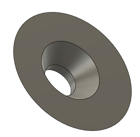

I've no idea whether the amount of diffraction from the ports matters at all, but it struck me that they could be more rounded, as you have low diffraction as a goal.
Me neither and that is a good suggestion having the entry/exit as smooth as possible. This falls into the category of how to do that with the CAD program, I'm figuring out a lot of it as I go as I am no CAD expert.

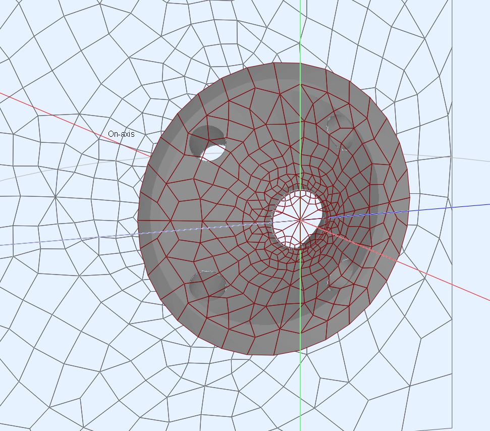

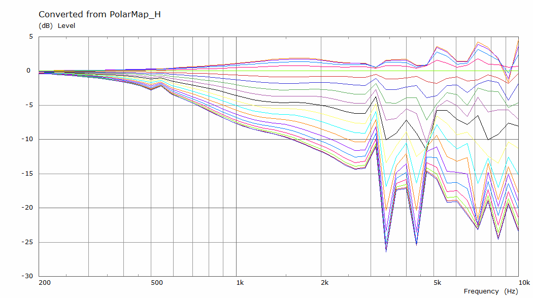

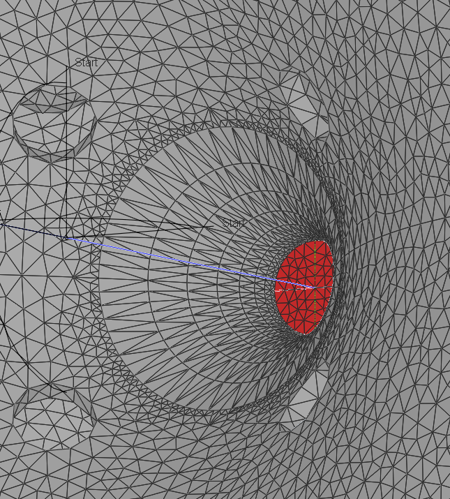

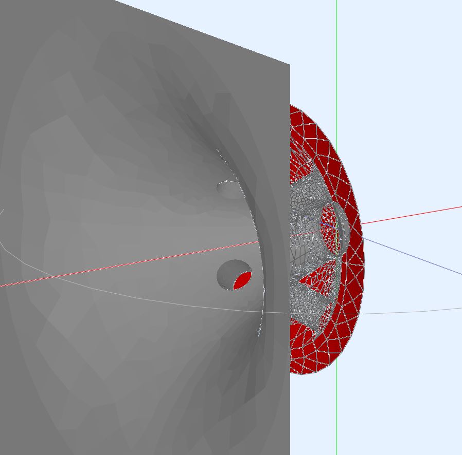

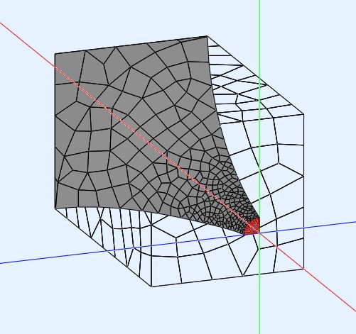

I have made some progress with the MEH simulation. The good news is that I have got something to work the bad news is that it doesn't work that well. I started with a freestanding horn but to get any kind of resolution the number of elements got too high. Those simulations thrashed around overnight and got nowhere.

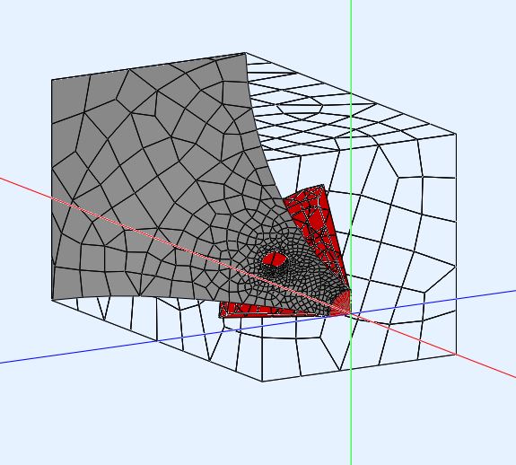

I went to infinite baffle, the difference between cutting holes in an Ath Mesh and using a stub throat mesh and the rest solid reduced the sim time from over 5 hours for the cut mesh to 1:40 for the stub mesh and the results were virtually identical.

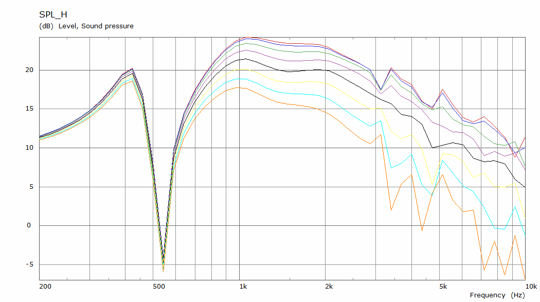

There is spiking from numerical issues which hides much of what the ports are doing and they aren't optimized because that is actually much harder to do with surfaces in Fusion.
What does make sense is to use the BEM model to see what is happening with the driver and throat chamber and get that better before trying to add it into the horn.

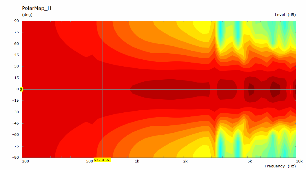

I will probably try moving the ports out as they are too close for the intended purpose and as that is in the parametric section it shouldn't be that hard. The big cancellation dip is not in a good place either. The polar is still consistent all the way round so one port in each quadrant didn't change that.

The simulation I did was really just a proof of concept that I could model something that would work and simulate reasonable results.
The CMI seems like a good approach, it would be time consuming to replicate in CAD but doable and does aim to reduce most of the problems that can be seen in the simulations I did. Worth reading that page as a good primer on the issues that horn porting can give.
I agree with PKsound that it would actually be quicker to print something with a 3D printer and test it as getting things right to simulate it is quite time consuming. Parts of the problem could be broken down and simulation done on those to optimise the individual issues.
I will still try to move the ports out and make the overall chamber less of a disaster (just to see what difference it makes) but I have a better idea to try first that does not need any penetrations in the waveguide.
Modelling the ports on a conical guide would be much easier but then as the horn itself is not as smooth or consistent determining the more subtle effects would be harder.

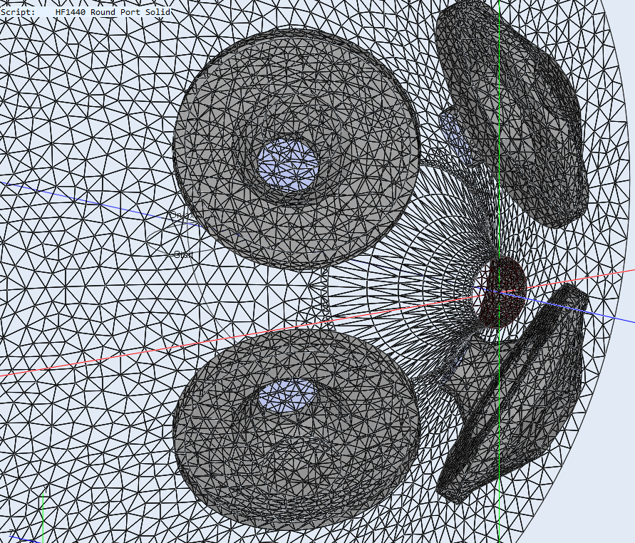

Hey fluid!
I'm going through a similar process getting my coax MEH to simulate in AKABAK. Sometimes the simulations looks reasonable, and sometimes really weird.
I'm trying to incorporate the LEM side of things, as I would like to see how the crossover will work. That isn't exactly easy either 😀
I did the model from scratch as a complete solid cube with the horn contour cutout for the first sim. and started building on top of that.
Seems like I should up my polygon count 😀
Your sims looks quite nice!

Hey fluid!
I think that route much like the Danely SM60 is a smart way of getting a big mid driver to work especially as the inner part of the horn can double as part of volume filler for the cone. I can see that there is something in front of your cone that is see through from the front side. Could you take a screenshot of the other way to see what you have to join the cone to the backside of the guide?
Getting the density of the mesh right is tricky as well as getting the vertices of the mesh to align if things are split.
One tip if you have made the horn contour in Ath is to export it from ABEC as an STL file, import that into CAD, cut it on one of the profile lines with a plane created from on the vertices. Then create a polyline out the edge and use that to cut the solid waveguide. When you export both you can combine them back together with the vertices aligned as gmsh will mesh to the cut vertices on the solid waveguide. That way you have a higher density from the driver to the cut based on mabat's geocode which is much better than anything gmsh can do on its own. Then you can use a lower density on the outer parts. This took my simulation from 5 hours plus to 1 hour 40 with exactly the same result. I can see you had the same problem I did where gmsh is putting too many elements to describe the port. By setting the maximum and minimum element sizes to 10 it won't do that as much and put more over the whole surface. I also like to use the flat driver from the Ath model too rather than an ABEC created one like in your drawing. It helps to align the vertices again.
