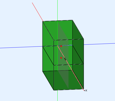

ABEC /AKABAK can simulate rooms with wall damping but that is different than enforcing an infinite baffle, so the two things are separate.
This is the shoebox room with damping example from the ABEC demos. The red dots are pressure boxes, which approximate point sources. The box represents the room boundaries through node points and whatever damping is desired can be added to the walls.

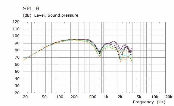

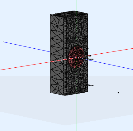

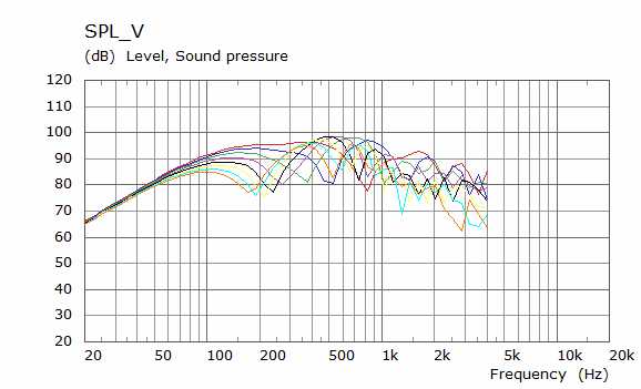

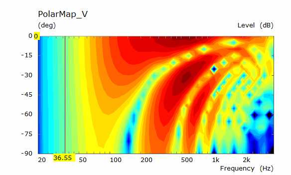

Here is the woofer box example I used earlier with an infinite baffle placed as the floor under the speaker. The output is measured from the on axis of the speaker not the listening position so that has to be taken into account.
The horizontal doesn't suffer too much
You can see the nulls form in the vertical polar from the floor reflection.
The vertical SPL shows why I don't think it is helpful at this stage, it just becomes hard to see the wood for the trees 🙂

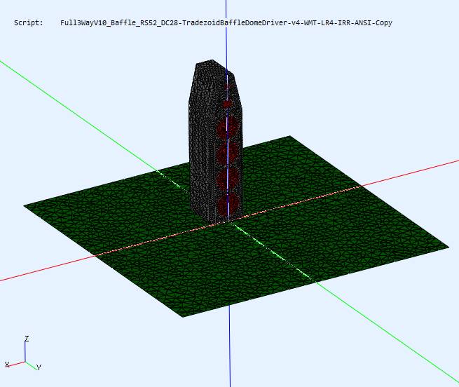

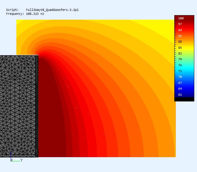

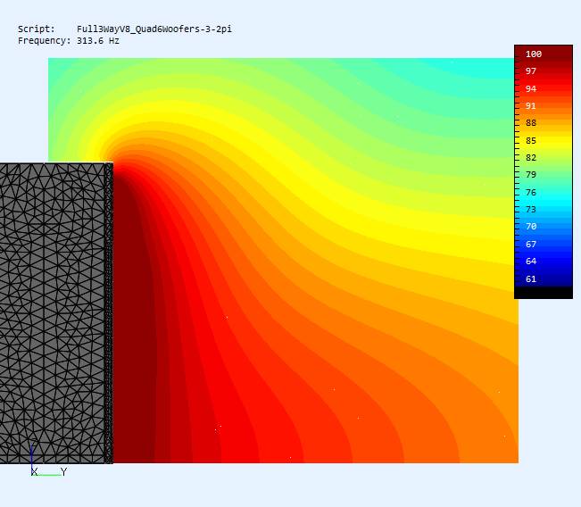

Whenever room boundaries are simulated through BEM or like is done in Vituix or Jeff Bagby's spreadsheet, more sources and more reflections smooth out the combined response. A single driver with a single reflection is the worst possible combination to look at.
DonVK has a good example here of using a vertical line of woofers to mitigate the floor bounce.

You can create a flat panel and give it damping properties if you want to see the bounce effect. It can be a coarse mesh so it has less effect on solve time. It probably will have little effect at reducing the bounce at low freq. (<500Hz) but you can compare the sim to actuals (I did it with a carpet). The quad woofers was better at solving this.
Thanks Don that's another simple option to try, what damping value did you choose?

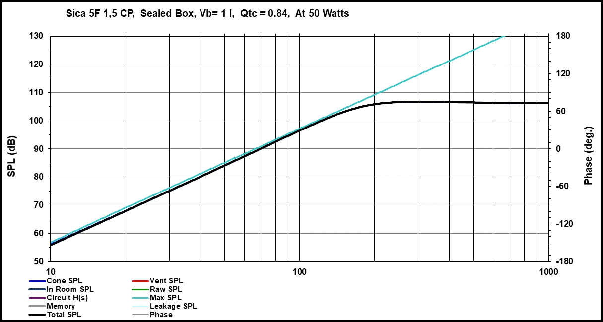

Just had a rush of blood to the head and ordered 8 x Sica 5 1,5 CP 16 ohm drivers
5 F 1,5 CP
Models really nicely even in a 1 litre enclosure
5 F 1,5 CP

I was originally planning to use 16R drivers but I could not find a reasonably priced small 16R woofer that goes low in a small volume. I would have preferred 4P config rather than 2S+2P. I did find some SilverFlutes except the shipping was excessive (more than the drivers). The 4P config would have given me higher sensitivity and a closer match to the horn solution as your sim shows.
If you want to put exterior objects (plane carpet , block couch, sphere heads) around the speaker you can use the built in geometry generator ("shell"). Or you can create them in CAD.
Code:
Shell "Floor"
SubDomain=1
RefNodes="n"
ShellType=rectangle
Meshing=Delaunay
wD=200cm; hD=200cm;
position=1001,1002,1003
color=Green 0.7
Rotate=0,0,0
Shift=0cm,0cm,0cm
WallImpedance
RefElements="Floor"
ImpType=Reflection
Value=0.5
ft=500Hz
