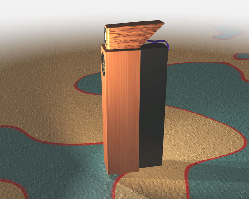

u got me interested too. how big is your SAF cabinet? I am considering a cabinet that loonks like carolina audio's JTM about 36" tall, 3" (int) in depth and 12" wide. in fact I was looking to taper the depth from 3" (int) at the top to 7" (int) at the bottom.
on top of the JX125 cabinet I was thinking of putting the JX53 in an box with no rear panel (top, front and sides only) however some posters discoruged me from using the JX53 in OB esp since I was looking at a XO freq of less than 500Hz. what about using a MLTL for the JX53 too?
looks nice. I might copy it. ok with you?

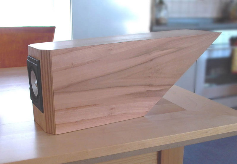

Hi all,
I am jumping on this thread rather late...
I've also been playing with the Jordan JX 53 unit, although my plan is to use an oldstyle Audax HM 170Z as bass driver in a TL cabinet (models surprisingly well in AJ Horn!).
The JX53 will sit in a separate cabinet on top of the bass unit, and since I just got the upper cabinets finished I might as well show you a pic or two!
They have a wedge shape like Colin mentioned and are finished in multiplex and pear veneer. For my taste they are looking dead gorgeous!
Still on the waiting list are the TL cabinets and the XO, but maybe I am going to get them finished by the end of the year....
Xo will be simple using 6dB filters with impedance equalization, the crossover point will be 500 Hz-ish like recommended.

>And a raytracing how it's supposed to look...
Cool!
