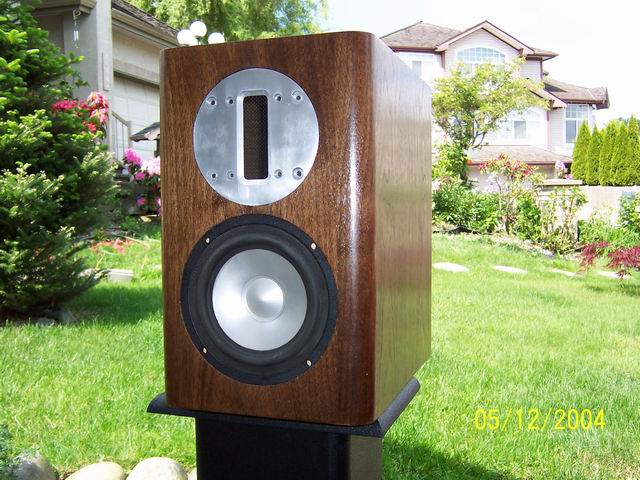

Basically, I'm considering a TL similar to rljones' Jordan 92S TL + ESg2 ribbon except using the JX125 or JX150.

www.salkaudio.com has a Veracity HT-1 with a better combination of a ribbon and woofer than the Jordan. For less moolah, there is a good OW1, woofer combo already built(heresy!).
Our own RAW has a ribbon/Jordan combo built for Jim Griffin, PhD that is probably a mind blower.

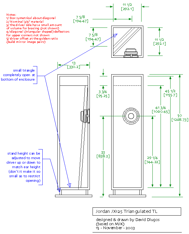

i did a TL design for the JX125 (for someone else never built it).
A friend had JX150 and until he managed to get JX53 he found a fostex ribbon to be the best match... then he used the jx53 with a series XO about 3.5k... now he just runs the JX150 full range. Mine are still in their boxes, but i'll get them into something someday.
dave

Exactly how my buddy had his configured... i have the details somewhere... 90 some litres IIRC and XO in the 3-4k range (his choosen values don't fit nicely into the calculators)
dave

I use the JX53 and JX125 in sealed boxes. Two separate enclosures in the same cabinet. The JX125 is in a (I think - it's been a while) 35L enclosure, tuned to a Q 0f 0.7. It is good to around 50Hz at full power, below which the output diminishes rapidly. The size was chosen partly for asthetics - the Jordan site recommends 50L for this driver. The JX125 enclosure is unstuffed, which I found sounded better.
The JX53 is in a 3L enclosure (twice the recommended size but it also holds the crossover board) and crosses to the woofer at the recommended 500Hz, 6dB octave.
Jordan recommends a 66L vented enclosure for two of the JX125 drivers, which is giving me ideas as my current enclosure is within striking distance for one driver. The vented design would probably have more output at lower frequencies. Now, where did I put that jigsaw?
Colin
