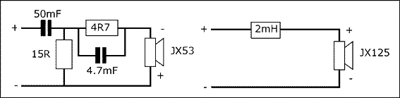

The crossover on the Jordan website
There is a diagram of a simple 53/125 2-way crossover under
systems/application notes/JX53. Can anyone tell me what it means in
terms of good wire and the most tweaked out parts?

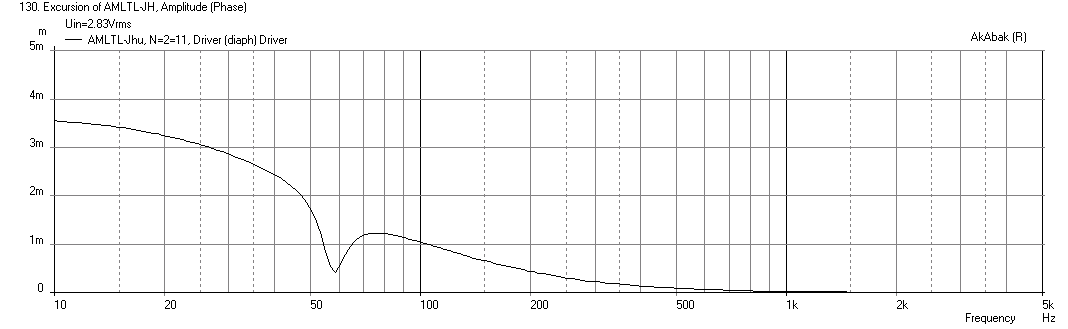

Re: Re: Port diameter for JX125 MLTL
dave,
I started with your posted design , kept the same cross-section & "straightened" it (Sd=S0=60 in^2), shortened it it 72 inches (giving a total enclosure height of about 30"). The driver's at 24" & I modeled a 8" long 1.5" radius port out the bottom instead of just an opening.
It gives pretty good LF extension with a fairly smooth response...
Response shown is with no stuffing. The displacement stays below 2 mm for everything above 20 Hz.

Oops! In my previous post these should be .....< ~0.5%...... and .......bumps it up to 0.6%......
Yes, with stuffing to smooth it out and a good roll that works well for a small room or near a wall or corner.
Note that this at 1W.
