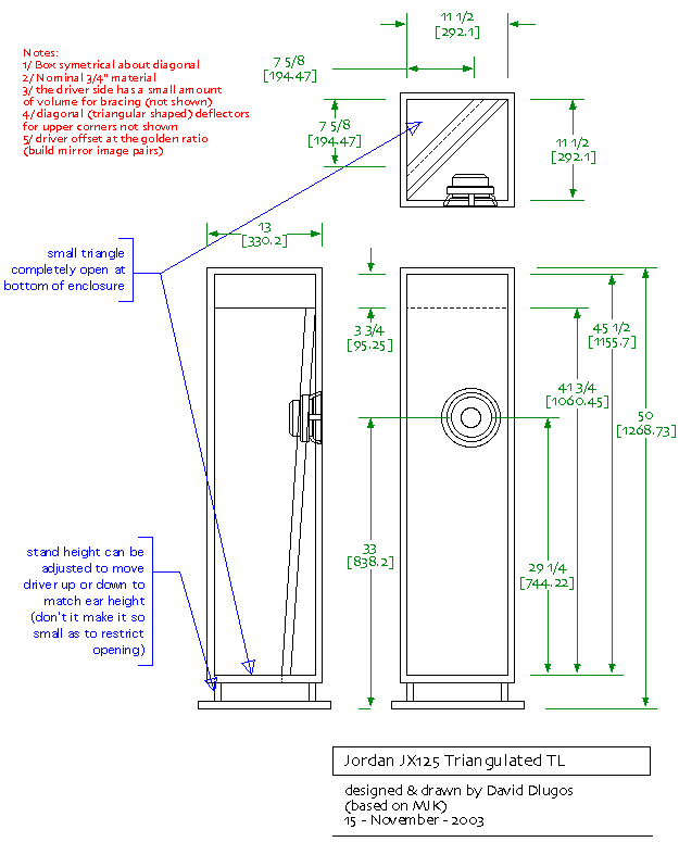

If the JX53 is not in its own box, the JX150 will use it as a (little) PR -- not a good thing.
A well documented JX150/JX53 TL. Uses active XO thou.
dave
macmeech said:I do not believe there would be significant difference if both drivers were in the same box.
dave

Catching up on the last few posts...
Two sealed boxes - I mis-described what I did in my system. The JX53 is in it's own sealed box within the main enclosure. The whole system looks like one box. The JX53 needs it's own acoustic loading and needs the back pressure from bass kept well away from it in order to function at it's best. (It's a very lightweight driver cone.)
The JX53 and 125/150 are not designed as fullrange. The JX92 fulfills that design aim (within its limits at either end of the spectrum). The JX53 and it's predecessors were designed as tweeter/mid-drivers, in order to keep the x/over as low as possible. This, among other things, keeps the acoustic centres relatively closer together. It works well, to my ears. They sound quite different to traditional speaker systems, more akin to an electrostatic or panel driver like the Magnaplanar. To some extent, the low crossoverr point negates the need to use the Jordans in a MTM configuration.
The drivers are more expensive than some drivers but are virtually hand-made and are far from the most expensive on the market. (No, I'm not on commission.) I remain astonished that the rest of the market is so far behind.
JX125 box - shouldn't be too tricky to work out the extension of a sealed box at 25litres, for a given Q. Alternatively, if a larger box is acceptable, maybe someone could have a look at the Martin King ML tables and see what pops out. (They weren't around when I did my enclosure.)
JX53 box - probably best to stick with the recommended 1.5 litre sealed box (you can half that volume if running to 500Hz). It's worth experimenting with the shape of the enclosure though to reduce parallel surfaces.
Hope this is of help.
Colin

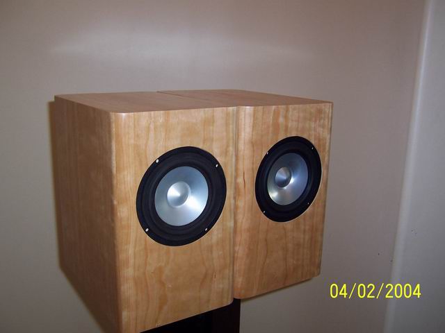

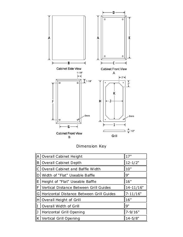

Meech's Folly
This is a .75 cu. ft Parts Express speaker cabinet at $90.00 per in gloss black.
I am going to seal off the 53 in the top and use the remainder for the 150.
Where do I go for the best software to delineate the two internally sealed spaces proportionately? Madisound provides the service. I have MacSpeakerz
software, which is the only one for Mac, and I have no idea whether to trust it.
I would rather pay for good commercial software evaluation. Any thoughts?
