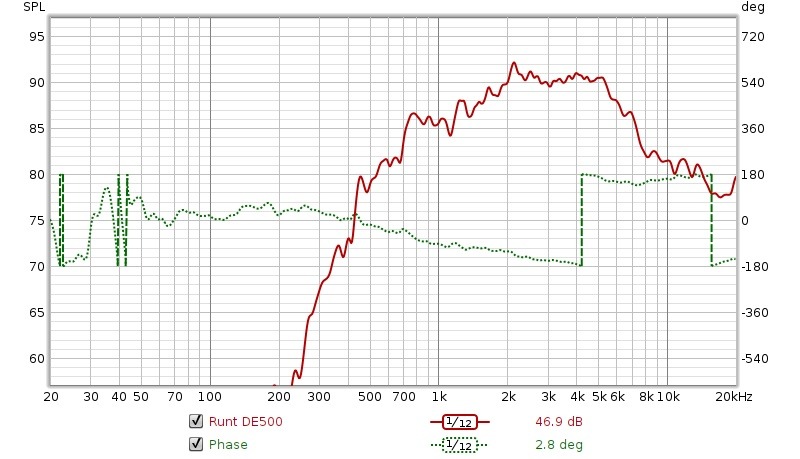

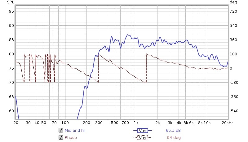

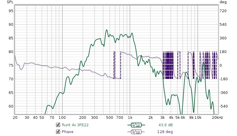

From the performance point of view, a 3 way should be better and I should definitely try that one day. I tend to like the "kick" from a separate midbass horn. I wonder if I can get that from a 3 way MEH as well - in some reasonable size and weight.
The 3FE22s can go easily over 1 kHz crossover. I yet have to invent some back covers for testing at the low end. Also, the DE500 needs some more EQ on the high end. But all in all, now it looks really fine to me.

A very small update - with 3D printed back covers on the Faitals, the low crossover can be around 200 Hz on the low end, which is a good enough result for me. I actually forgot to save the measurements, but it seems that the back covers are extending the low end a bit. I had to pad down the DE500 some 5 dB and a bit of EQ to straighten the upper end FR, but for the first test, it sounds really good. I will have to optimize the EQ and crossover a bit. The next in line for a test is the AMT Synergy with only two 3FE22s, which will be set up as the other speaker for stereo.

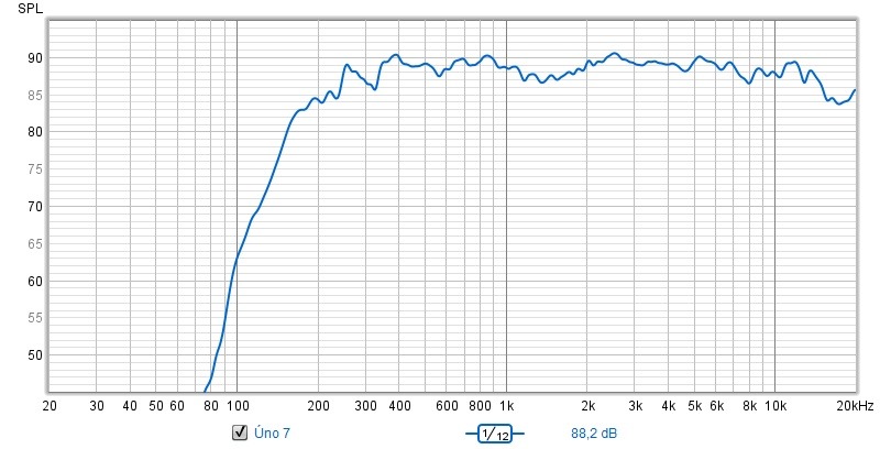

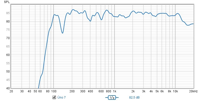

So here are some measurements, again with a quick crossover at 930 Hz (LR4) and some PEQ using REW to calculate the filters. The second plot is with a paraflex kickbin, the dip at 140 Hz is from the room. I did not have spare time to listen, still need to set up the left side with the AMT Synergy. I am quite happy with the results so far.

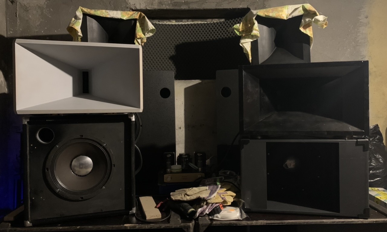

Second side is set up. As expected, the AMT horn is less efficient, around 2 - 3 dB. I still need to work on the crossovers and delays. Each sounds slightly differently, but mono recordings are perfectly in the middle. Still happy, bit also lots of work (and fun) ahead🙂

Well, I must say that the MEH is really something special.The DE500 is really lacking compared to the Heil AMT, but both the Runt-clone and AMT single flare horns have the "magic" sound to them. I will now begin slowly working on the largest MEH that I can build on my CNC (ca 80 x 80 cm workspace), single flare, Syn9 style. I bought today the very fine Beyma CP755Nd drivers, which will be the base for this.
I think this prototype has served its purpose. It will be soon dismantled and put to storage - as well as the second prototype based on AMT. But not before some more measurements, the weather is slowly getting better and one of the following weekends will be used for a large measurement session.
