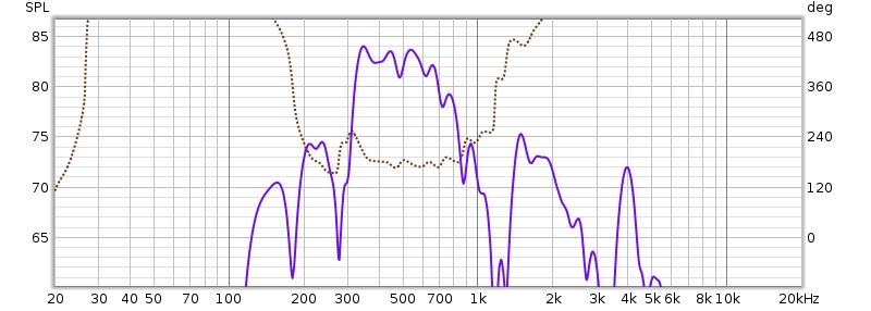

I did some quick crossover, time alignment and a little EQ yesterday for some short listening in mono. There is definitely the point source effect, the apparent source of sound is somewhere in the middle of the horn, but not at the throat I would say. I also get a feeling of the "disappearing" effect, but that would show more in stereo.

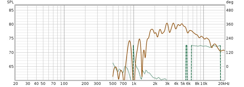

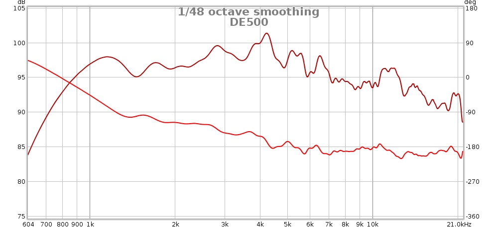

There are still dips and peaks in the (in room measured) response, but it seems that this size and shape would work for me. I definitely need to get some different compression drivers, since the DE500 drops of at the high end pretty fast - I bought them second hand and it really seems that they measure differently from factory specs on any horn I use 🙁
Like here: https://www.diyaudio.com/forums/att...ial-es-800-horn-joseph-crowe-es-800wde500-jpg
Or here: https://www.diyaudio.com/forums/att...rameters-please-advise-de500babymulticell-jpg
Before I measured the 4" length along the wall - it is actually slightly less than 3 inches when measured in the horn axis. So the notch is lower than it should be. Also, there seems to be some extra bandpass rolloff that should not be there theoretically. I need to measure with the compression driver shorted as I saw somewhere if it makes a difference.

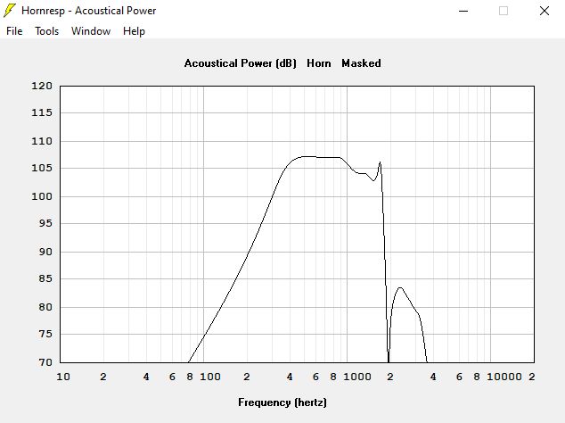

The 4NDF34 does not show the notch higher in the simulation (than the 8PE21s, however the ports can be closer to the throat and smaller). I think I will try to block some area of the port if I can measure any difference. And maybe, my favourite 3FE22s will go into temporary service on the smaller ports as well🙂
I dunno pelanj, I've come to the conclusion that it's length along the wall that determines the notch frequency.
Because it seems the notch is formed by sound from the cone going back into the throat to sum destructively with the CD. Seems like that path has to be along the horn walls....i mean, path can't get any shorter than that can it?

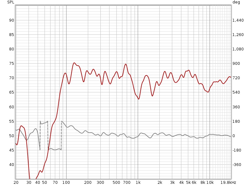

Here's the 4NDF34 with port centers at 3.5" inches from throat along the wall. Hope it helps, oh 75x60 horn if it matters
(There's a 1500Hz lpf in place 96dB/oct.. with no effect on upper end rolloff.)

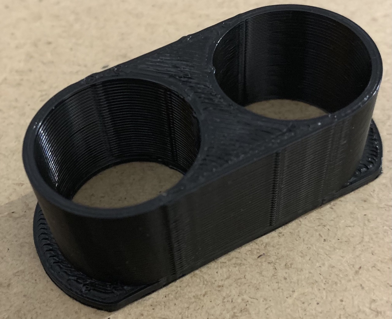

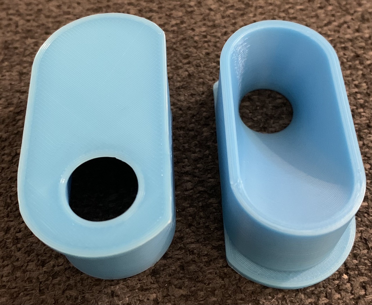

I printed some port inserts to see the influence on measurements. I will also print one with only one hole closer to the throat. The future of this test horn is not very bright, it will be cut, drilled, glued at various points. I cannot spend as much time as I would wish, but it is fun nevertheless.

The black port inserts did almost nothing to the notch. Plugging the holes with some foam reduced the (unwanted) HF from the midranges. So that is worth considering. New plugs are made to see if there is any measurable difference. Third version will have just a small holes.
