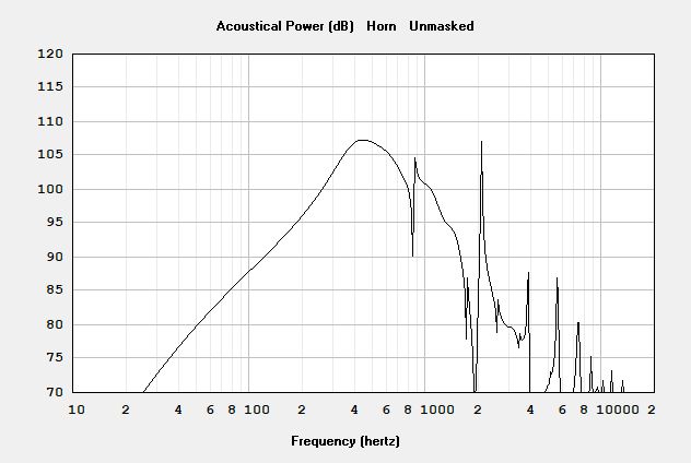

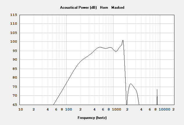

David McBean is a genius and Hornresp is the best thing since sliced bread! Playing with the simulations, I came to two conclusions:
1) a better cone volume filler is necessary to reduce the volume to absolute minimum. This will need a few test prints to get as close to the cone as possible. Increasing the volume in front of the cone moves down the bandpass frequency (expected). Might get a few extra Hz.
2) When I unmasked the resonances, I got my dip! The lenght of the back chamber is not 20 cm (as in simulation) and the volume is also less, but I guess the dip comes from reflections in the back cover.
I need to verify this experimentally tomorrow and will run the woofers without the cover as I planned (had to do some other things today, so I just fired up Hornresp for a few minutes).

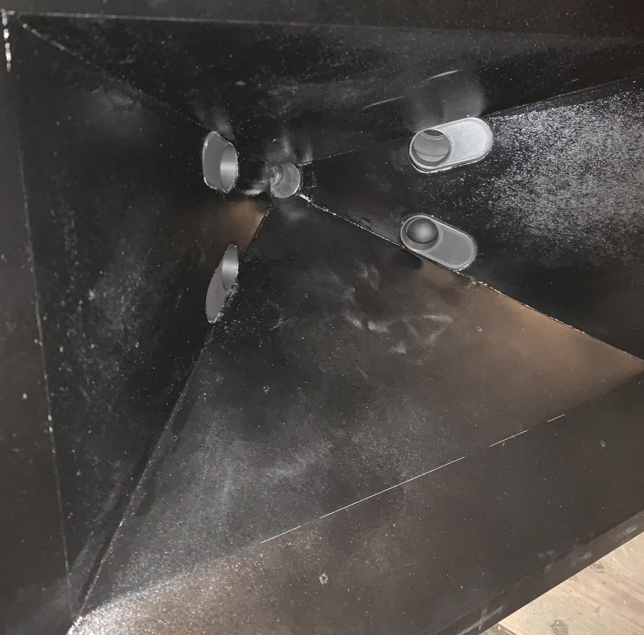

There is a balance between the port length and volume under the cone that can be used to tweak the response up. A shorter port helps, so frustrumizing the port holes reduces the length of the port and adds some cone volume.
A resonance at that frequency from the rear chamber could be helped with some damping, sticking a layer of the automotive type felt inside the back chamber if it will fit.

So the dip definitely comes mostly from the back cover. For 300 Hz crossover, I can run the woofers with open back for now. The smaller port insert decreases the efficiency a little and extends the HF a little. Different volume filler might help a bit more even though the volume cannot be reduced by much. I wonder if some of the dips are caused by the placement of the hole relatively to the cone - on the edge instead of the middle.

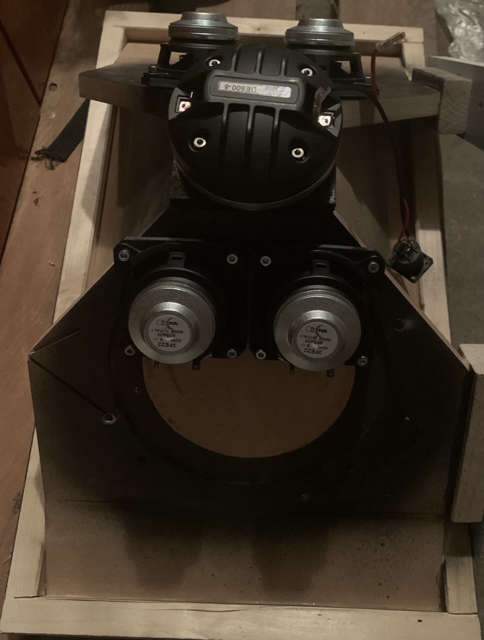

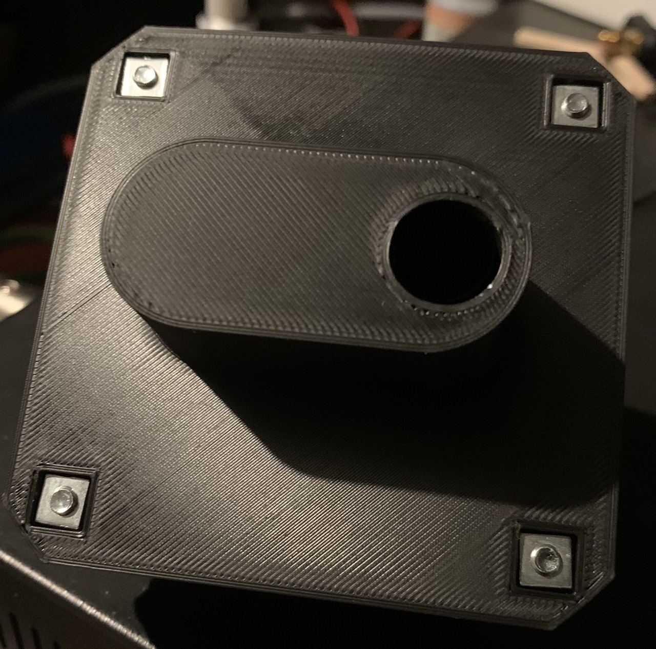

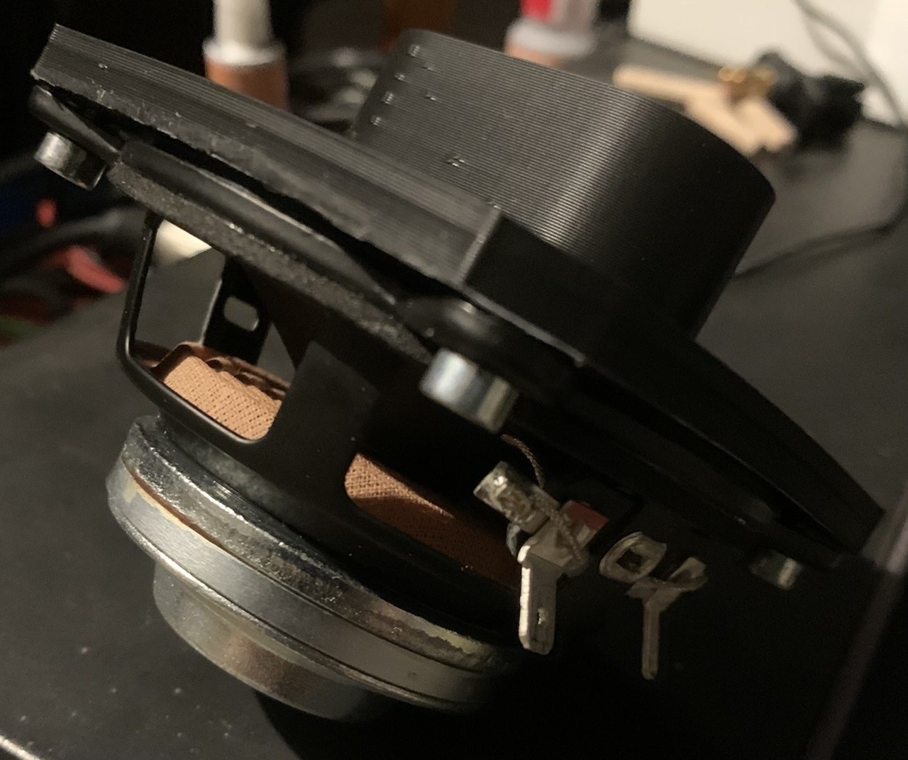

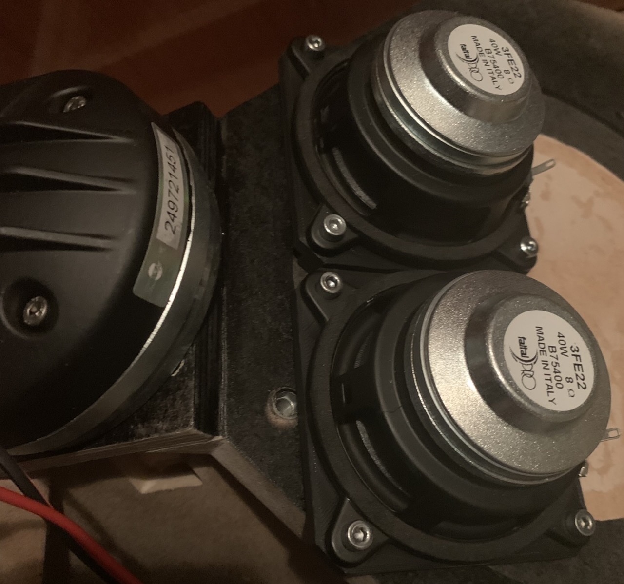

I got a crazy idea - replace each 8PE21 with...drumroll...two 3FE22s🙂 The 3D printed adapter with frustrumized port will fit the horn. With a bit of tape, I should be able to measure how much better or worse this will be. Since I aim for 300 Hz crossover, it should work pretty well for home volumes.

I have read elsewhere that 3FE22s don't have very good distortion performance, though in a horn this might not matter.
Have you considered some of the smaller Vifa drivers, e.g. TC5/TC6/TC7 series? Some info is available on HiFCompass, Timothy Feleppa's page, etc.
The mids could be taken a little bit nearer the throat, but this test did not require any wood working. Just a bit of PLA and some gel super glue. I am curious how these will measure once I wire them together.

I am now considering if I actually need a larger 3 way horn. It would be nice to try, but it seems to me that a 55 cm wide horn works nicely with the Paraflex midbass (or another midbass front horn) and that there is no need to have the 90 - 300 Hz band inside the horn. Well, maybe there is, but all in all this looks like a compromise I could gladly accept. Since the 12" paraflex is being painted now, I used an old Peavey 15" bass reflex box. It kind of worked, but at really lower sensitivity and the sound was not that cool. I need to set up this one with the AMT synergy to stereo...
Consider that when W.E. set out to make the best public address [PA] speaker they wound up with a one piece diaphragm 8" three way single driver (755 tri-ax) with an ~ 80 - 12.5 kHz -F6 and arguably still the best performing overall, so yes, a three way Synergy is worth it IME.
