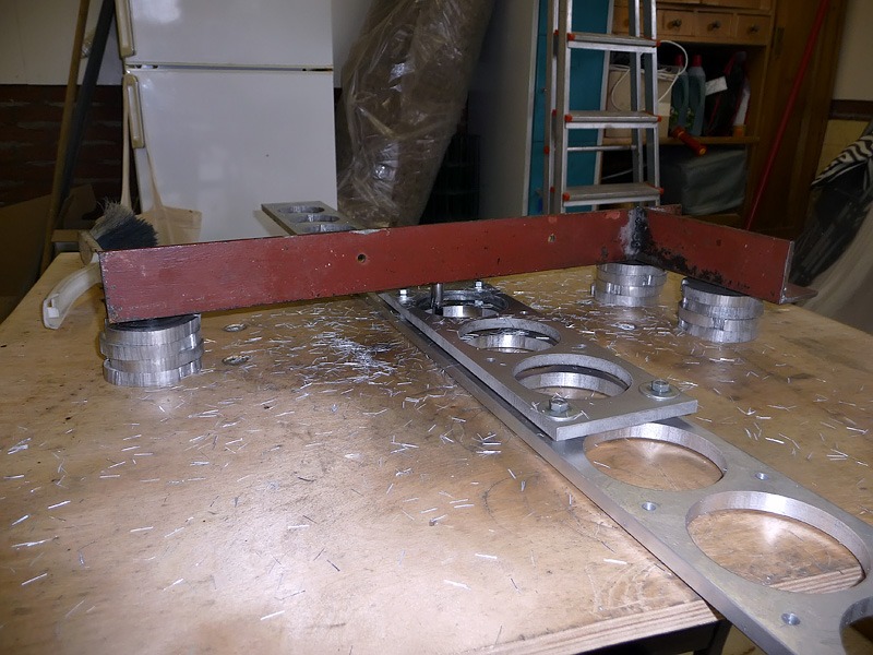

50 holes like this, was it?
Actually, I have 2 aluminium baffles per speaker with butyl rope between them, so it ended up being 100 holes 😀.
I always knew you can work aluminum with wood blades, but lower speeds would be more favorable when going powered.

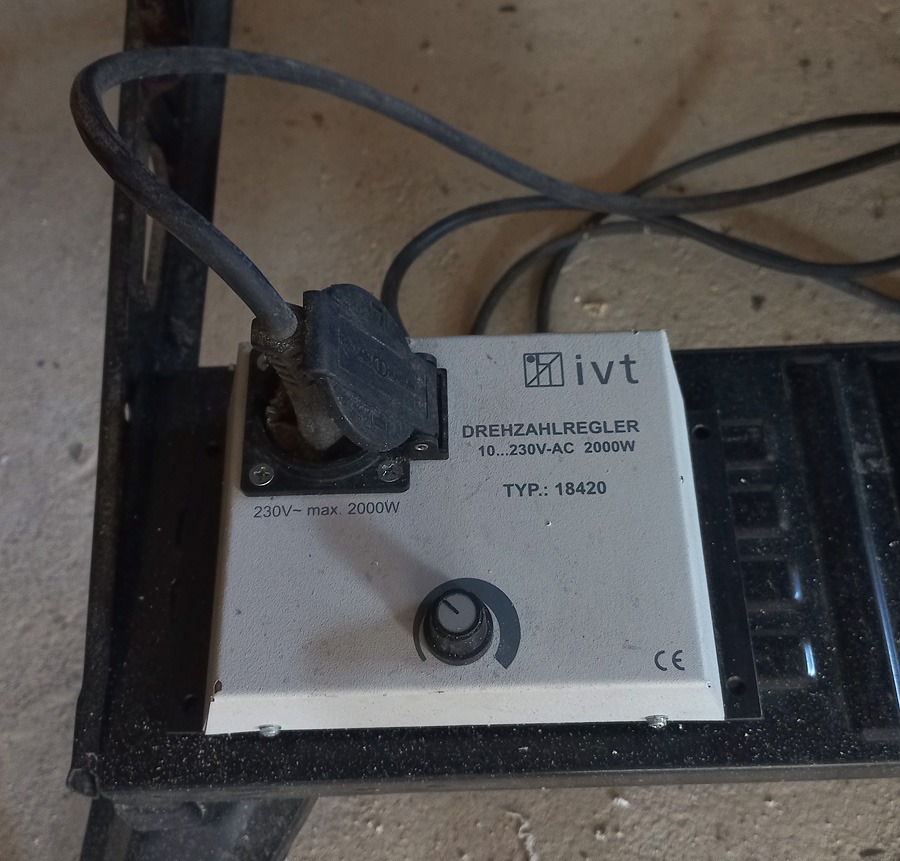

As I had a fixed speed router, I got one of these to be able to lower rotation speed. Even for wood I had to adjust the speed at times.
Warning: I did try router bits with bearing followers, but the bearings simply disintegrated within minutes. Even ceramic bearings did not last.
To still be able to copy shapes from a template, I made a fixed "follower" pin out of some scrap parts.
You can actually see the scrap hole pieces that were cut using the jigsaw as height adjustments in the above picture.
To help out the pain of the jigsaw job I drilled holes for a start and sometimes at certain points as a temporary relieve.
The outer baffle was 6 mm, the inner baffle 10 mm.

Perfect! I hadn't thought of using my volt regulator with my tools. I usually use them to variate the speed of fans. I <3 diyaudio.

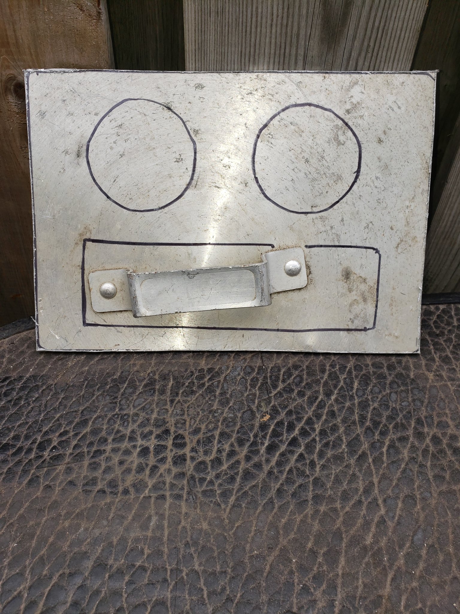

Sorry for not getting back sooner. I wasn't thinking FR. For reasons being placement aim is nowhere close plus I already have small coax to go higher up in L and R pillars.

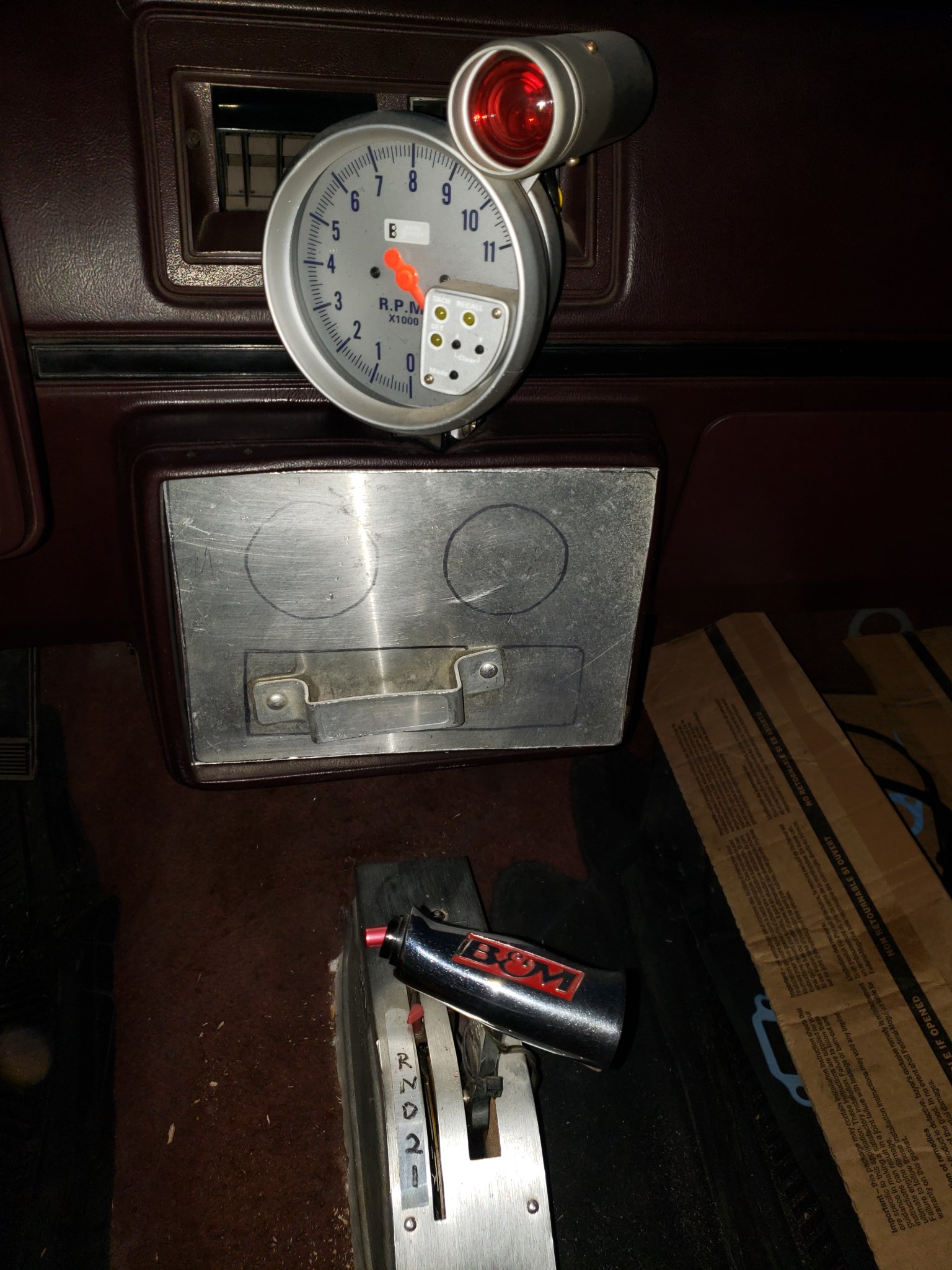

When I say I made this radio panel by hand Ill mean it. I got the cut nearly bang on wich surprises me a bit. My scripto lines still visible. I simply filed away the flash.
The nice thing about aluminium its soft enough you can easily work it with a file with a beer on your porch.
I'm where some ppl start, with a flat new sheet.
My thumb is still on the mend. It became personal between me that piece of scrap metal 😉.
But actually its going in a place wear you'll look at it dozens if not hundreds of times. That makes its worth doing.
You see how it ties in to the other aluminium. After and before a good 3m scotchbriting. It can use 1 or 2 step sanding with ligh grit👍

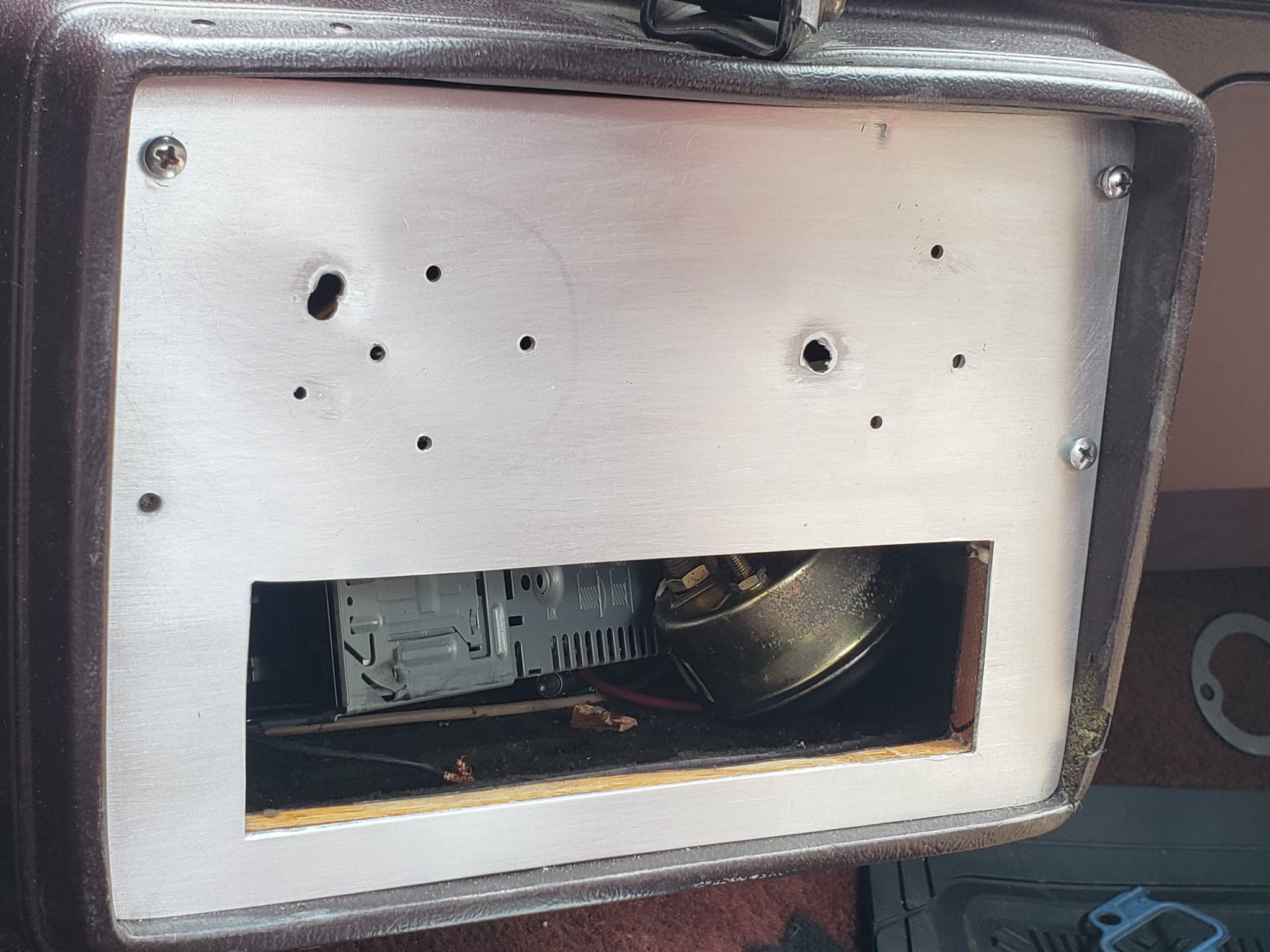

Aluminium is enjoyable to work because its soft.
I cut starter holes with an everyday spade bit for wood. And a wood blade with my jigsaw to cut the stereo slot. They both cut through it smoother than butter.
Two cuts left, and a once over buff.
Another plus is how easy aluminum cleans up with simple scuff pads.

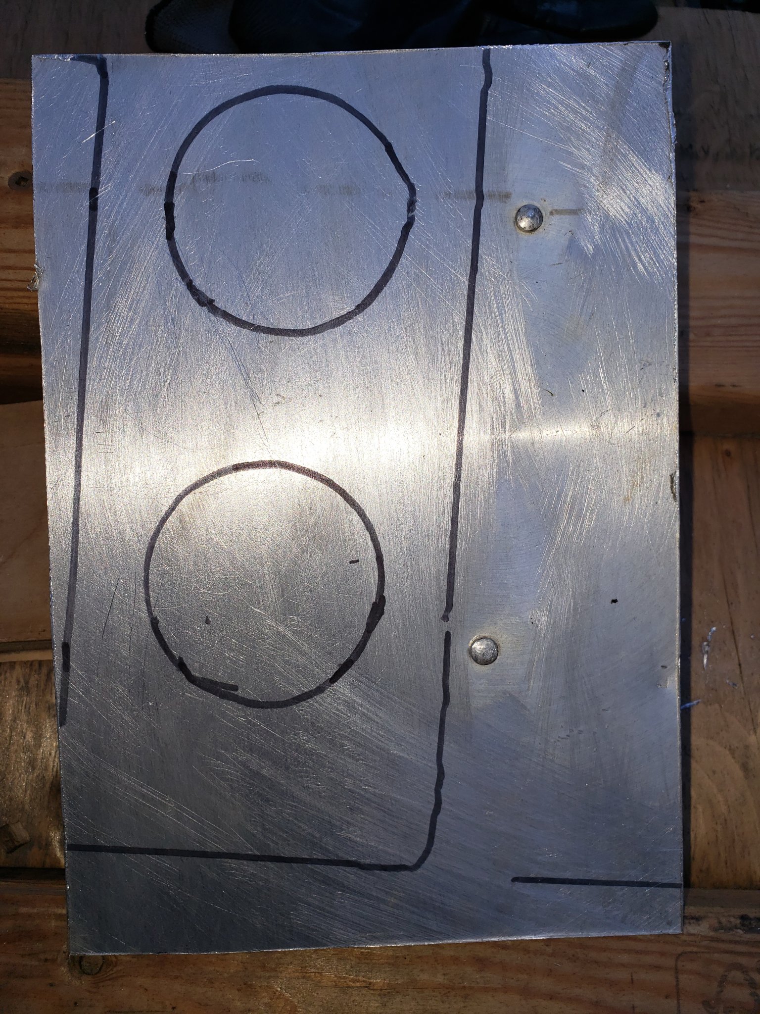

I cut it and then messed it up by trying to squeeze a small voltage guage in the middle which would of fit with less than a quarter inch between the two others. 8 hrs in the scrap pile. Its ok I learned a few valuable lessons about cutting this material.
I had drilled dummy holes to clamp down securely otherwise the thin stuff can violently flap then distort the piece beyond putting back.
I was sure to drill inside the two cut outs. Shifting the two over just so, wasn't enough and edges of the clamp holes peek out on one or other side.
Too late its already done. Soo tomorrow ill start another, and include all three straight off.
Only this time I'll use 1"4 aluminum and your router method and hopefully result with 3 nice clean circle cuts like you make in your line arrays. Cool stuff would like to see them as finished.
