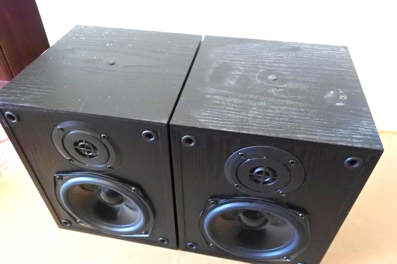

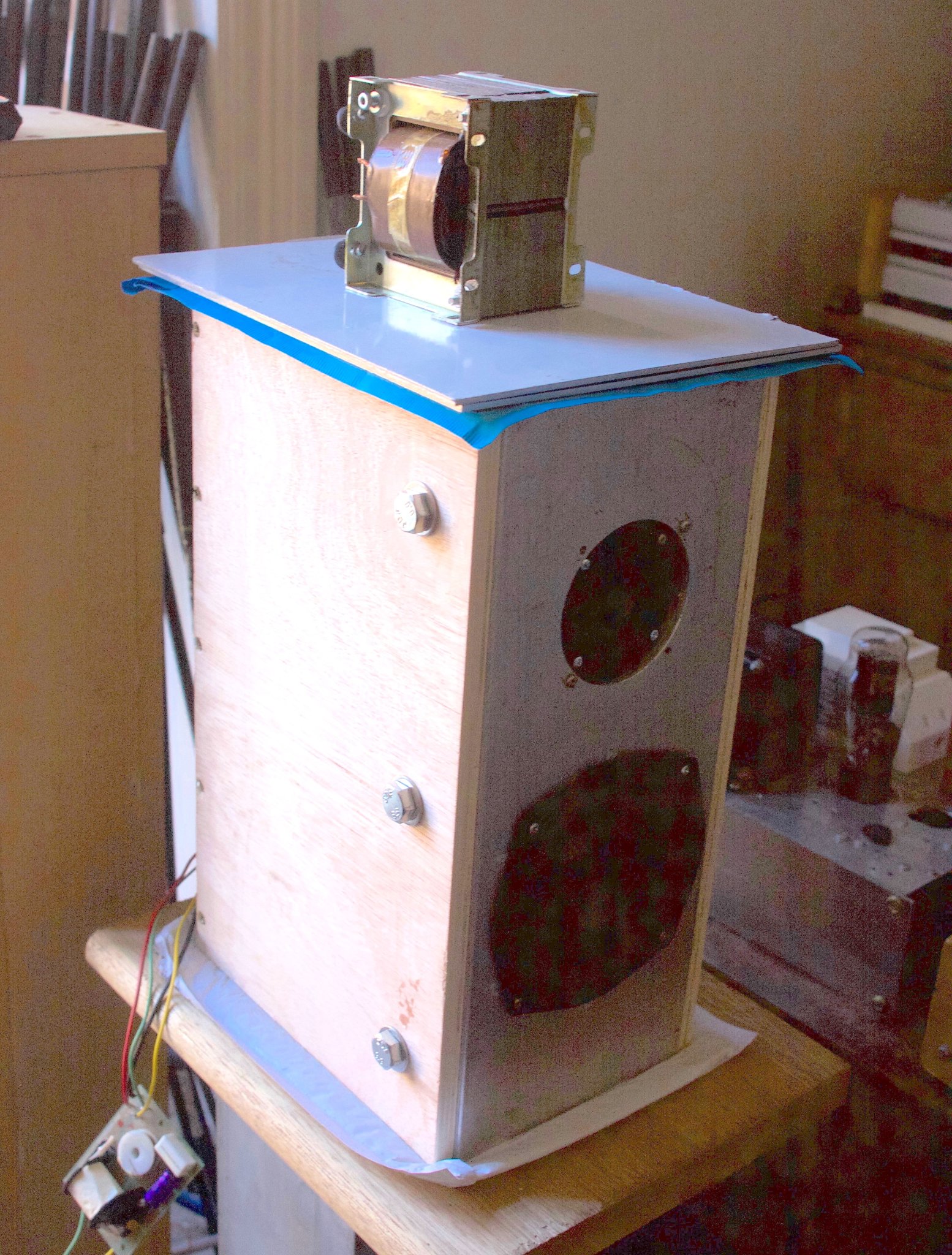

So I've got one new alu box up and running. The first thing that struck me immediately is that it's quite a bit quieter than the original Wharfedale Programme 30Ds from which I transplanted the units and crossover. This was very striking. So I'm listening to the original on the left and the new aluminium enclosure on the right. Doesn't really work for stereo since the sound is louder on the left. So I listened to Kempe's mono Meistersinger. I like it just from the new cabinet - it's much cleaner.
So clearly with the original Programme 30Ds there's a fair bit of sound coming from the cabinet itself. I was shocked by just how much the cabinet was contributing.
So early days - I need to finish the other cabinet and make proper tops and bottoms. But it's clear that the cabinet plays a major role in the total sound of the speaker. Night and day in this case.
Could you guys give me some feedback on this - how much sound comes out of the box and not the speaker units? And anything else relevant about box materials and build?

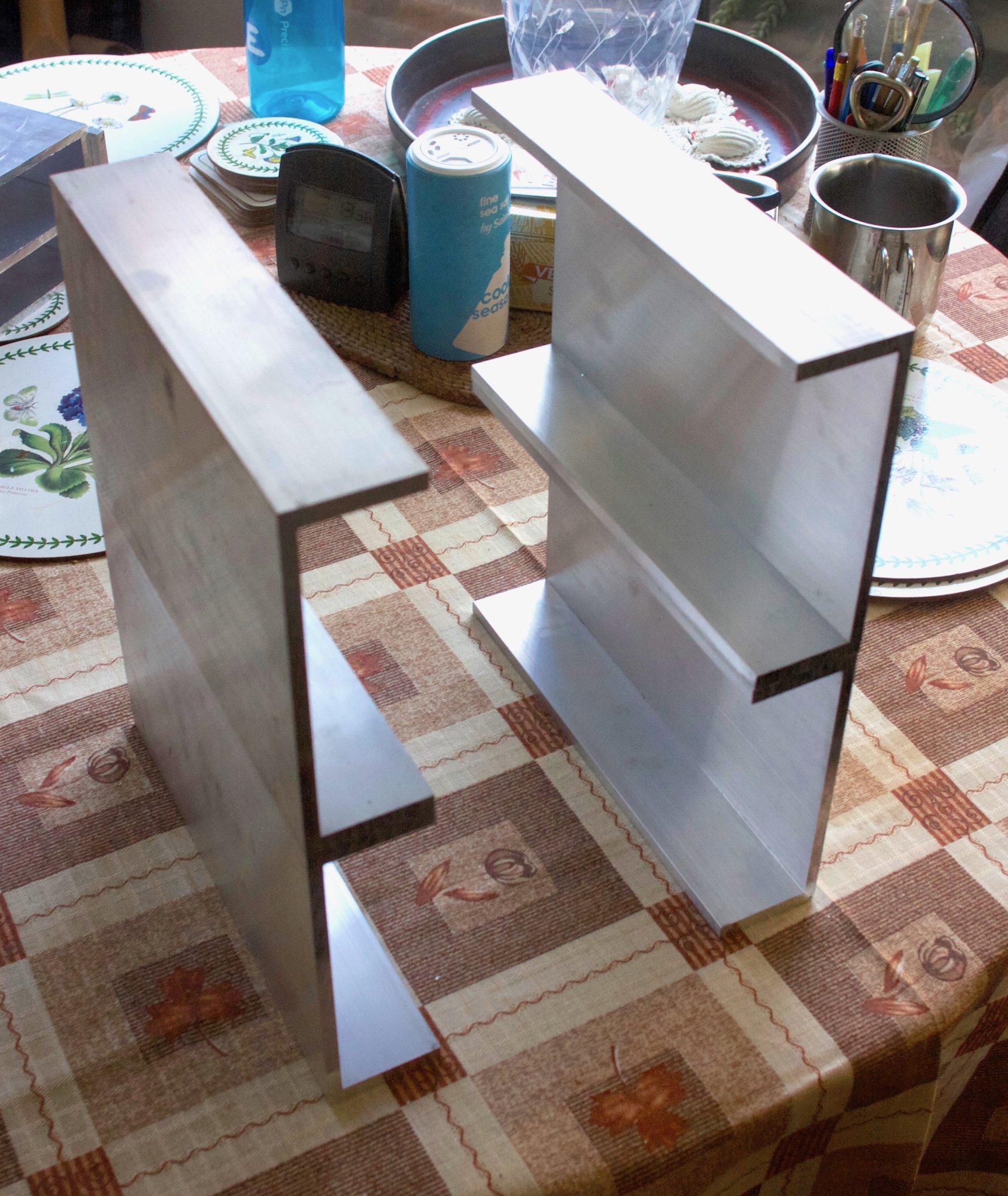

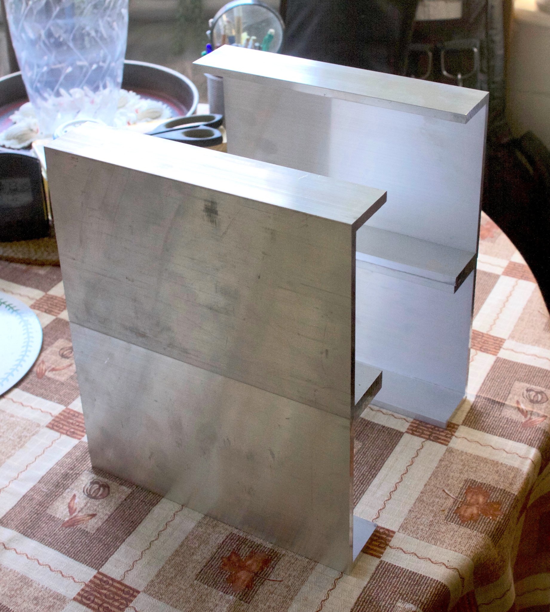

Making some progress with my larger aluminium cabinet. I have the sides now cut to size. Cost of the aluminium was £99 plus shipping, not bad. This will be a really easy build - just need to add front, back, top and bottom. No gluing required, no interior bracing needed. Just bolt it all together with visco-elastic damping in between. I have Soudaseal MS Clear. Then add self-adhesive butyl damping sheets inside, Dodomat heavy butyl. This is something you can build in the kitchen of a mid-town apartment, which is what I have. Width is 240mm. Height without top and bottom is 305mm. Depth without front and back is 250mm. Front and back will be fastened together with something like M10 threaded rods. Woofer can be 165mm or 210mm. Volume is 16.6 litres similar to the Magico A1.

A modular design using this construction technique could be very successful for building very rigid and stiff cabinets. The trick will be to find a balance between good dampening and material thickness requirements. There's no reason this can't be successful. Not a common way to build an enclosure but a viable one given the goals.

Why don't you try this? It's just 6" aluminium U channel. Should be available in the States. It would be very simple to put together. No machining needed for the aluminium - just drill holes for the bolts. I was thinking the rest of the cabinet would be in 12mm plywood sheets with CLD, but could be anything including a sandwich of plywood and aluminium.

Don't be tempted down the 'more-is-more' route of adding damping material; the industry rule of thumb is that it should equal the mass of the panel being damped. Too much added mass could lower the enclosure's resonant frequency into the critical range.

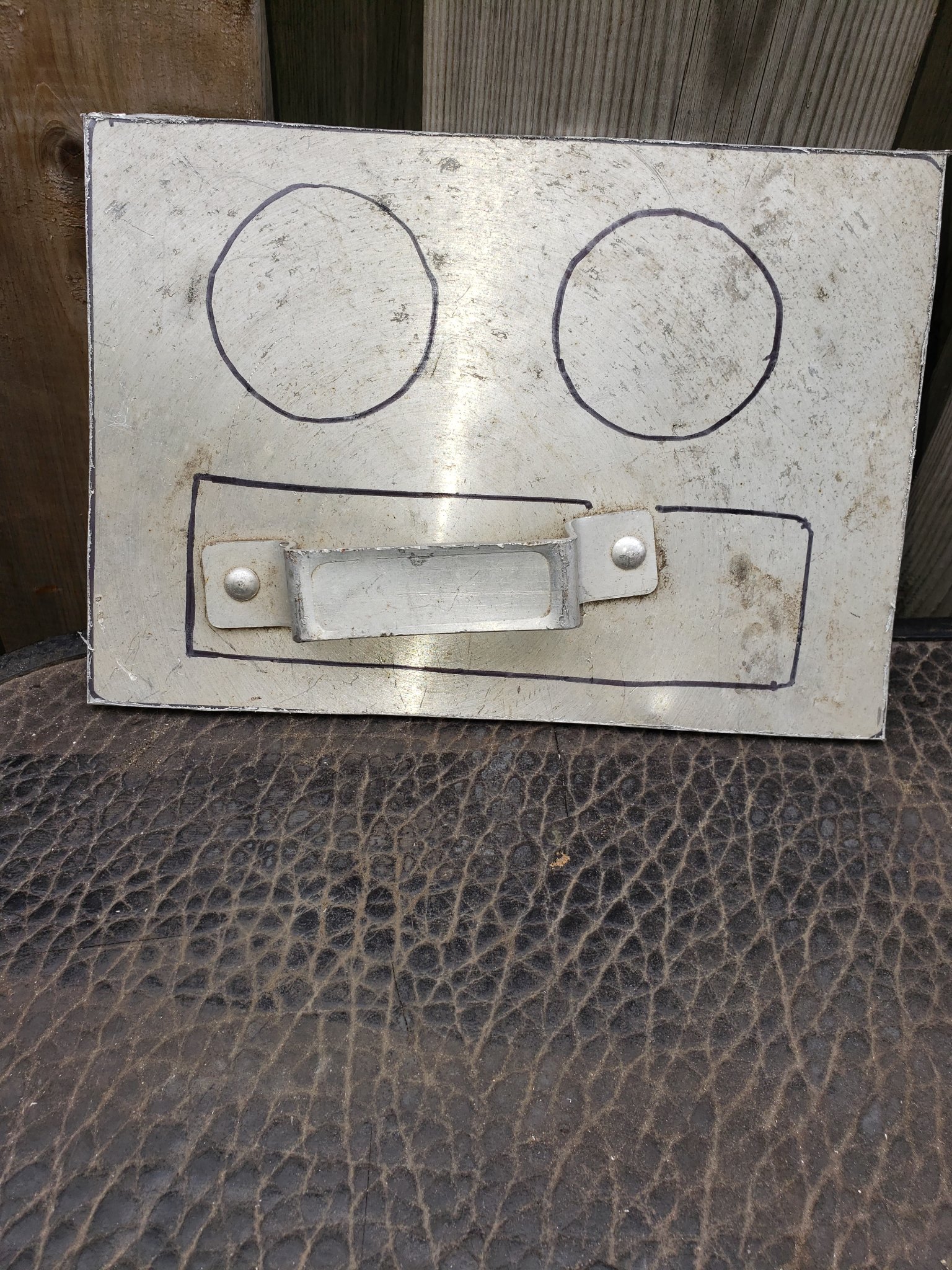

Backyard metal fabrication takes so much longer, and its extra hazardous, and hardly my favorite. Aluminum is my new least favorite to cut with a wheel. Since it has a low melting point it turns almost plasma. Its worse with fire. It sticks to your fresh new cut on the underside. I thought stainless was a pain, that became easy.
But aluminum looks so good buffed or brushed out.
This is my first time cutting myself with a grinder btw lol but it wasn't material related. It happened on the dismount while putting it down. One tiny wrong move with those and they make ya pay. Usually in higher dividends .
I'll be taking that piece to a waterjet. By the time I bought a circle saw for the guage holes ($100), I'll still need the radio cut out rectangular hole. I'm not doing that with a grinder its too dodgy. I will be pushing my luck on the warpage factor as well. I managed to keep it true but the thinner areas look like potential trouble.

Indeed, it's easy to machine 3mm or 4mm aluminium in the softer grades and use hole saws up to 40mm or so for things like amplifiers. Beyond that it's machine shop stuff. That's why I used aluminium U channel for the sides only. So the front and back can be wood to taste, like plywood with CLD or ply+MDF. You can cut into wood with a 145mm hole saw which is what you need for a 6.5" woofer. Basically my design just bolts together - you just need to drill the holes. I don't have a back yard in my 2nd floor apartment, so it had to be a simple kitchen build.
Or use a router table and lots of WD40 to cool the bits...

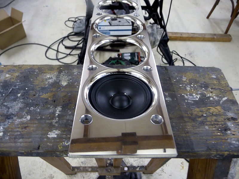

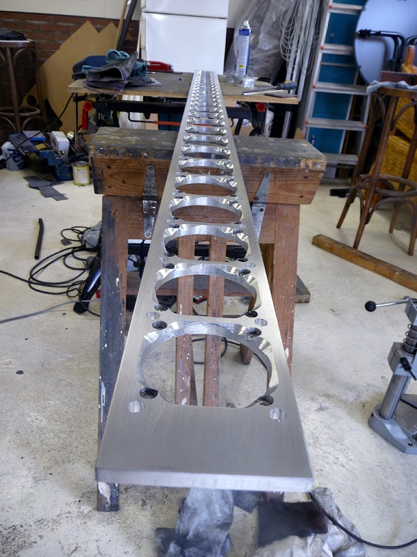

It took some experimenting but I managed to make these:
I machined up to 10 mm using HD bits, a router and a home made router table. Pré-cut all holes with a jigsaw.
That was a bit of a pain, I'll admit. But I made many more holes than you are planning on making .

Thats quite impressive. You are a patient man my friend.Or use a router table and lots of WD40 to cool the bits...

I always knew you can work aluminum with wood blades, but lower speeds would be more favorable when going powered. Stuff designed to cut wood material primarily in my mind would be too fast.
Call it a slight mental block but I'm ready to give it a try. I picture horrible things like the teeth grabbing and the peace flopping around and getting all warped. Along with a hellish squeal like when a bearing runs dry lol.
I'll fix it to some scrap, and try the jigsaw first, second a hack. One of those will get it done. I could eat the hundred for a CS. I use those from time to time.
Or a router. But I'd need to get creative for circle cuts that small, 2 1/2", I think.
