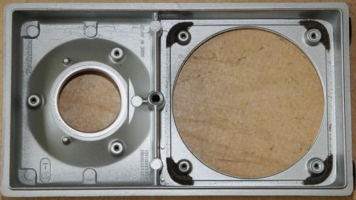

Depends on how you want to load it with drivers I guess. These are by B&O CX50s which you can see are most like your 3rd option:
https://www.diyaudio.com/community/threads/driver-for-b-o-cx50-3-25l-cabinet.377578/
With a steel baffle bonded in to take the drivers, but you could do this with wood. Works well for a small driver 2 way.

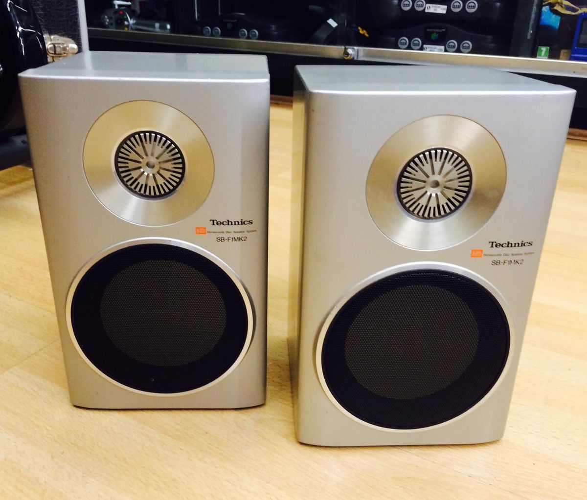

I used to have a pair of JR149s so know those. I have Alpair 10s in a tall cabinet as well, but want to try a stand-mount in aluminium. Thanks for the B&O reference - very useful. There was also the Technics SB-F1. Quite a few aliminium cabinets are coming out of the woodwork. Also Piega of course.

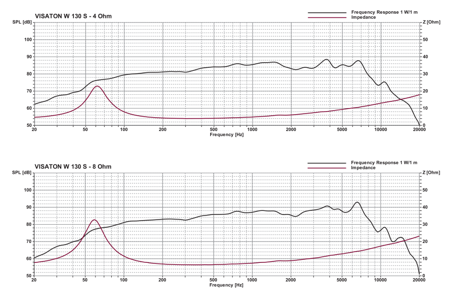

Visaton W100S-8 plus a tweeter can be done. Or beef up dimensions more for W130S-8.
The Visaton W130S has quite a smooth frequency response. Have you used it? Basic coated paper and quite cheap. I haven't seen any crossover designs with it.
http://www.visatonshop.at/en/Single-Drivers-Accessories/Bass-Midranges/W-130-S-8-OHM.html
Detailed thread on the W130S-4:
https://www.diyaudio.com/community/threads/visaton-w130s-4-sc10n-8.390947/

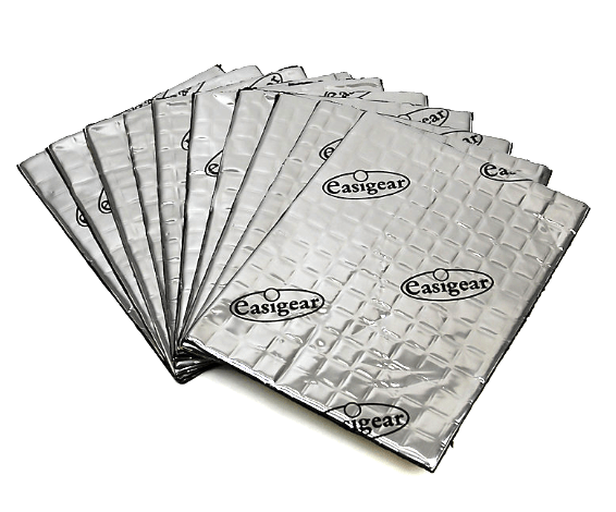

I still don't know which way to go with these aluminium cabinets pictured above. There's almost nothing on DIY Audio about making aluminium speaker cabinets. My choices for damping the raw aluminium 3mm are -
1. Don't add plywood sides, just leave the alu box as it is and apply butyl car sound deadening sheets to most of the inside. Or some other product - suggestions welcome.
2. Add plywood sides and maybe back, and fix with something like silicone, Titebond Melamine glue or Sikaflex 221 or EBT+ or whatever
Butyl sheets - pic:
Butyl sheets - pic:

I'm more inclined to use adhesive sound deadening sheets, following Piega's example. There are the butyl sheets used in cars, cheap and available. Then bitumen sheets which smell - maybe OK in a cabinet. Dedshete was bitumen. Then Sorbothane which is more expensive.
I can't see Mass Loaded Vinyl in smaller adhesive sheets - the big sheets are expensive.
Choices..... ideas?

Dynamat Xtrme is thin aluminium sheet that has thin butyl rubber on one side with a self adhesive layer on the other side of the rubber
https://dynamateurope.com/portfolio/dynamat-xtreme/
You can buy it from various on-line places...

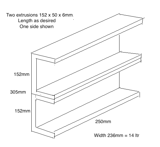

This is for a 165mm mid-bass unit and 25mm tweeter. Hopefully it will be my "forever" speaker cabinet. Very heavy and Magico level construction. The extrusions are from Aluminium Online
https://www.aluminium-online.co.uk/product/6-x-2-x-1-4-x-5-16-aluminium-channel/
So the sides will be solid aluminium 6.4mm thick with a huge brace running front to back. Totally inert. Only the bottom and top need to be added. And then removable front and back held by threaded rods going front to back, so both removable for modifications. The port would be on the front or back if ported.
The cost in extrusions would be £110 plus carriage. Not too bad. The top, bottom, front and back would be something like marine ply or whatever with CLD. This is very adaptable. Total overkill, but why not!
What do you think?
