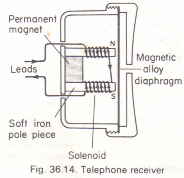

The telephone earpieces I opened as a child were a moving-iron design, with a big stationary electromagnet, a small polarizing permanent magnet, and a thin sheet of some magnetic material as the diaphragm (like the first attached image.)Headphones are telephone earpieces on a strap. 100dB SPL from a couple of volts is VERY VERY old news.
I remember that the coils contained lots of turns of hair-thin copper wire, but I don't remember their DC resistance; faint memory says maybe as much as 1 kilo-ohm.
Well before the Walkman was invented, my father had a Sony AM/shortwave portable radio that came with a single earbud (for those too young to remember, AM and shortwave radio are both mono.) I opened it up to study it when he wasn't looking, of course.
It was a miniature version of the telephone earpiece, with a tiny permanent magnet in the shape of a ring, with a thin sheet of magnetic material laid on one end, and a small 8-ohm coil of copper wire stuffed inside, wound on a central metal pole-piece, itself attached to a thicker disc of magnetic material that closed off the bottom of the magnetic ring, completing the magnetic circuit. A moving-iron design, with lousy sound quality and lousy sensitivity, but it was being driven by a transistor amplifier running on 9 volts, so it was more than loud enough.

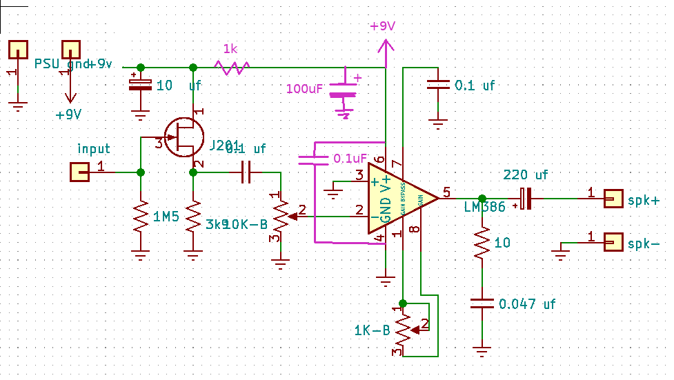

so i put together the first prototype on a breadboard and attached it to an 8ohm speaker. there‘s tons of noise pickup but i assume that is normal for a breadboard circuit without an enclosure to shield it. apart from that the amp sound surprisingly good. strange malfunction: as soon as i turn down the volume with the pot on the guitar even a tiny bit the sound is cut off completely. guess i‘ll have to troubleshoot tomorrow.
Are you perhaps using a high-resistance volume pot, such as 1 Meg, 500k, etc? If so, that can cause this symptom....as soon as i turn down the volume with the pot on the guitar even a tiny bit the sound is cut off completely.
The trouble is that the LM386 has a relatively low input impedance of only 50k. It works best with a volume pot that has 100k or less resistance. A 47k, 22k, or 10k log pot (in the USA: 50k, 25k, or 10k) will work well.
The low input impedance of the LM386 is the reason why the Runoff Groove fellows added the JFET input stage. It prevents the LM386 from loading down the guitar and causing a loss of treble (the dreaded "tone suck" in American parlance.)

a good night's sleep cures most circuit problems. i twisted the in- and output wires, moved the power supply cap (200uF) closer to the opamp and most of the noise is gone. after removing the input buffer the noise is further reduced and I can now also use the volume pot on my guitar. so i bet something must be wrong with that buffer - i bet i wired it the wrong way or something. i really don't have a lot of experience working with transistors and their pinout always confuses me ...
apart from that - i used the (bufferless) ruby in bassman mod configuration all morning. my wife hasn't left me (yet) and i must say it sounds quite amazing.

so i put that input buffer back into the circuit and the trouble starts all over. the amp worked fine without the buffer but as soon as i put that JFET in I get all kinds of weird farting noises, buzz, hiss, you name it. the transistor is certainly installed right now - i triple checked. also that "pot interaction" is back. as soon as i move the guitar put just a tiny bit the sound just cuts off. If i keep turning the pot the sound reappears in a very muffled and distorted kind of way and disappears again. what to do?
May be high frequency oscillation, due to poor circuit design and/or layout....worked fine without the buffer but as soon as i put that JFET in I get all kinds of weird farting noises, buzz, hiss, you name it.
Check out the fixes in the attached image, which might help. Add 0.1uF - 1uF ceramic or film cap as close as possible to LM386 power pins. Add 1k or similar decoupling resistor between +9V and JFET drain. Add 10uF decoupling cap for JFET.
Make sure output wires to speaker/headphones are kept far from JFET gate and copper traces connected to it.
Leaving off that ceramic cap across the LM386 power pins was a major mistake on the part of the Runoff Groove people. Most chip amps are unusable without this.

I tweaked the layout a bit last night and now it works just fine. I'm not sure what did the trick. I replaced the input with a shielded cable (instead of twisted pair). Also I moved the 220uF cap that sat between (+) and (gnd) somewhere on the "powerrail" of the breadboard to sit right above the opamp between pins 3+4 (gnd) and 6 (+). In addition i put a 0.1uF ceramic cap in parallel with the 220uF cap.
