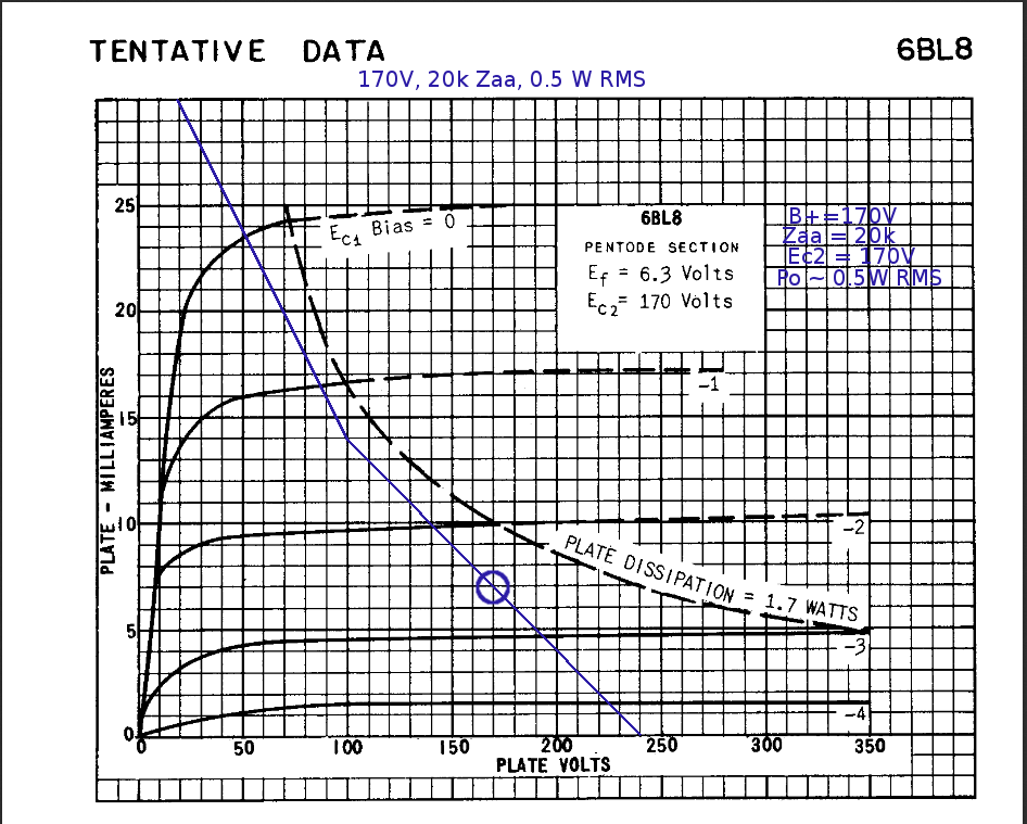

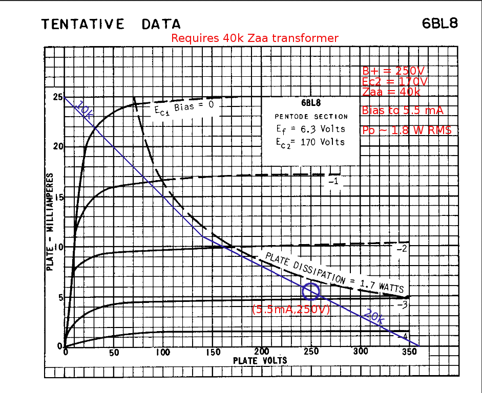

Push-pull 6BL8...
I hadn't explored this possibility before, so I plotted a few load-lines to see what they looked like.
The 6BL8 is generously rated for max. anode voltage, but max. anode current is quite limited, to only about 22mA at 30 volts anode voltage (the top left corner of the curves.) High voltage and low current requires a high load impedance.
On paper, then, a pair of these wants an OT with a 40k anode-to-anode primary impedance (see attached image.) Which is very high indeed, and I've never found an off-the-shelf transformer that can get this high. 🙁
Note that 40k Zaa translates to each pentode "seeing" a load of 20k for small signal excursions when both pentodes are operating, and seeing a load of 10k for bigger signal swings, when the other pentode has cut off.
If one could obtain this very special OT, then a pair of 6BL8 are estimated to produce about 1.8 watts RMS of output power, running on a B+ of 250 volts, and biased to about 5.5 mA idle current for each output valve.
In practice? Evidently people have managed to make these valves work with available (i.e. much lower) OT primary impedances. I couldn't find any load lines that looked reasonable on paper, but reality trumps on-paper estimates.
I would imagine the associated penalty would be much lower maximum power output (which might not be a penalty, if 1.8 watts is louder than desired.)
The last valve guitar amp I put together (on a bread-board) used an even smaller triode-pentode valve, a 6JW8. Single ended, it worked with a 22k reverb transformer and put out about 200 mW (which was plenty loud enough for me for use in my apartment.) Push-pull would have required an OT with roughly 45k Zaa, which I don't have, so I didn't try it.
-Gnobuddy

I found something (barely) workable using a 20k OT and push-pull 6BL8 pair, but most of the tubes operating area is left unused, overdrive tone is suspect (because the load line passes above the "knee" at top left), and output power is drastically reduced to about half a watt.
B+ is 170 volts, which is conveniently obtained from a 1:1 mains isolation transformer and silicon diode rectifiers in North America. Each pentode is biased to 7 mA anode current.
-Gnobuddy

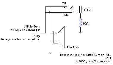

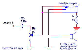

And here's another question: My goal is to use the ruby amp for use with headphones. There's a schematic for that on the electrosmash website and a slightly different version on the runoff groove website. If I get this right, the approach would be to „split“ the mono signal to get the same signal on both headphone channels - so the same (mono) signal from the guitar goes to tip and to ring.
what i don’t understand is, how a 10R resistor from sleeve to ground would attenuate the signal? don’t we usually attenuate the signal by sending some of the signal to ground (voltage divider like a pot).
the schematic from electrosmash actually splits the signal between tip and sleeve and ties the sleeve to ground. would’t that result in uneven signal on the right and left channel? I’m confused ….. any help would be highly appreciated!

...ruby amp...headphones...
Please remember to protect your ears - be careful about loudness. A Ruby has to be run hard to distort, and with headphones, it will then spit out extremely loud, harsh, sounds, with lots of loud treble frequencies, which quickly destroy human hearing.
When used with a loudspeaker a Ruby amp is not dangerous, because it's a low-powered amplifier, and won't produce dangerously loud sounds from a loudspeaker. But most headphones you buy today can reach ear-damaging SPL levels with one single milliwatt of power driving them - about a thousand times less power than a guitar speaker needs to get equally loud.
...10R resistor from sleeve to ground...
You might be able to save your hearing by replacing that resistor with a 1k potentiometer, so that you can dial down the SPL to safe levels. Better, add the 1k pot in series with the 10R resistor, and always start out with the pot set to maximum resistance.
The pot would be used as a variable resistor, i.e. connect the centre-tap to the headphone jack "sleeve" terminal, and one end to ground.
Ideally this would be a reverse-log pot, but they are scarce and hard to find these days. A plain old linear pot will do, though it will be "twitchy" near the loud end of the dial.
Alternatively, you can use a log pot, and wire it so that you have maximum volume with the knob rotated fully *anti* clockwise. If you label the knob "Attenuation" or "Quietness", then it will make logical sense, with maximum quietness with the knob turned fully clockwise. 🙂
-Gnobuddy
The larger the series resistance the more the signal is attenuated?
Yes. It may not be the best way to attenuate a headphone signal, but it is the simplest.
Running on 9 V, the chip amp in the Ruby can put out a maximum signal of maybe 6 - 7 volts peak to peak, or 2 - 2.5 volts RMS.
If we assume 20-ohm headphones (and no additional series resistor), that means the maximum power the chip amp can deliver is 200 - 300 mW.
Ever since Sony re-invented headphones for their Walkman in the 1980s, typical headphones have a sensitivity of 100 dB for one milliwatt of input power - they generate 100 dB SPL at your ear with 1 mW input power.
This means that an LM386 running on 9V, powering a pair of 20 ohm headphones with 100 dB@1mW sensitivity, can generate somewhere around 120 - 125 dB SPL at your ear.
That is loud enough to cause almost instantaneous permanent hearing damage.
180 ohms in series would drop the maximum current approximately ten-fold, drop the maximum power approximately hundred-fold, which translates to a 20 dB reduction in SPL - now you'd have a maximum SPL of around 100 - 105 dB at your ear, still ear-shatteringly loud, but no longer quite as dangerous for the health of your ears.
I would suggest that the series resistor not be any less than 180 ohms.
Even better, use a 500 ohm or 1k pot in series, so you ears are not subjected to 105 dB SPL the entire time you're rocking out with your Ruby. You only get overdrive at full volume with the Ruby.
