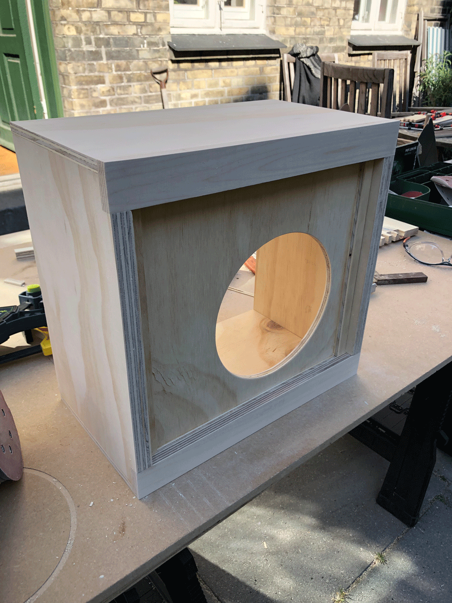

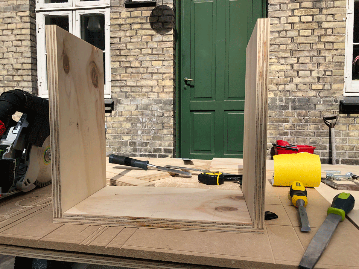

Wood was some fairly cheap pine plywood (7 ply) that i had bought a sheet off for a portable outdoor work bench. I had initially wanted to do a nice box jointed box but the jig i'd bought (cheaply) off fleabay went and broke on me so that plan was scrapped in favor of rabbets (rebates?). I recently invested in a new festool circular saw and their relatively new track system that allows precise settings of angles etc for miter cuts. We live in a small city apartment with only a little yard, so nothing like space for a table saw or real miter saw, so this is my portable solution that i can stow away when not in use.
I took the straightest piece of wood i could find at the hardware store, but it did have a little warp and the box ended up not perfectly square, but good enough for guitar.

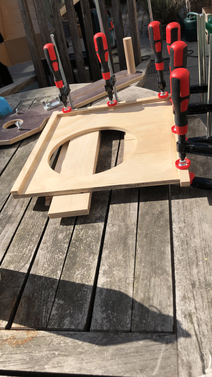

Next up my new saw made it very easy to do the cutouts for the front panel, fender tweed style. Again i used left over 12mm plywood for the panels. This was a nicer ply with more layers than what i'd used for the box but the difference is not too noticeable.

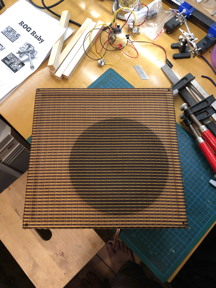

While those were gluing i got started on the baffle. The idea was to keep it pretty close to classic fender tweed as mentioned, including a floating baffle from some scrap 8mm ply i picked up in a local shop. The one little scrap piece was enough for the baffle and panels. I made the cutout for a Jensen C8R i'd gotten cheap off local classified ads.
So up next, trim the excess off the front panels with the flush trim bit on my router and test fit the baffle.
So far so good. Then round the corners with a roundover bit on the router, test fit speaker and drill holes for baffle mounting screws. Now for the finish. I got some tweed imitation grill cloth from music store and had my fun trying to get that tight on the box. Note: don't try to staple this stuff on with a cheap hardware store stapler. It wont work...

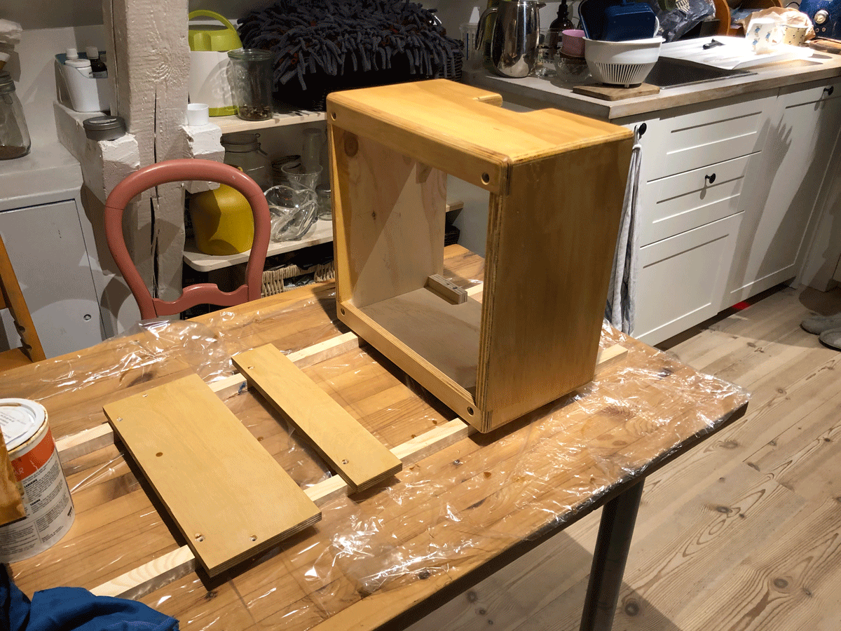

For the cabinet i'd decided against cloth covering. I know my own temperament well enough to know that would probably put me in a bad mood for weeks if i attempted this, so that is for a future amp. Instead a couple of coats of tinted water-based floor varnish followed by three coats of very tough clear matte varnish on top. This is the first layer. I did an oops on the back panel, but hey...

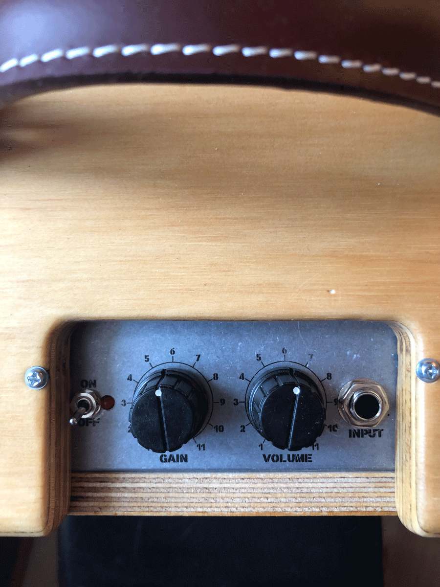

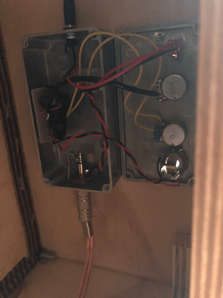

The actual Ruby amp i used was handmade by etching and thrown together in a very slapdash manner. I made a design to fit the knobs for the cabinet cutout though so it would at least have some semblance of a proper amp...
I was pretty optimistic in my choice of cabinet, and the whole thing didnt fit the Hammond 1590B i'd bought, so i ended up with an improvised mounting solution... But hey again, it's out of the way hidden behind a panel on the back so noone will ever be the wiser... Once i've got all the parts together for the new PCB i will fit it in a proper chassis and do something a bit more solid and tidy.

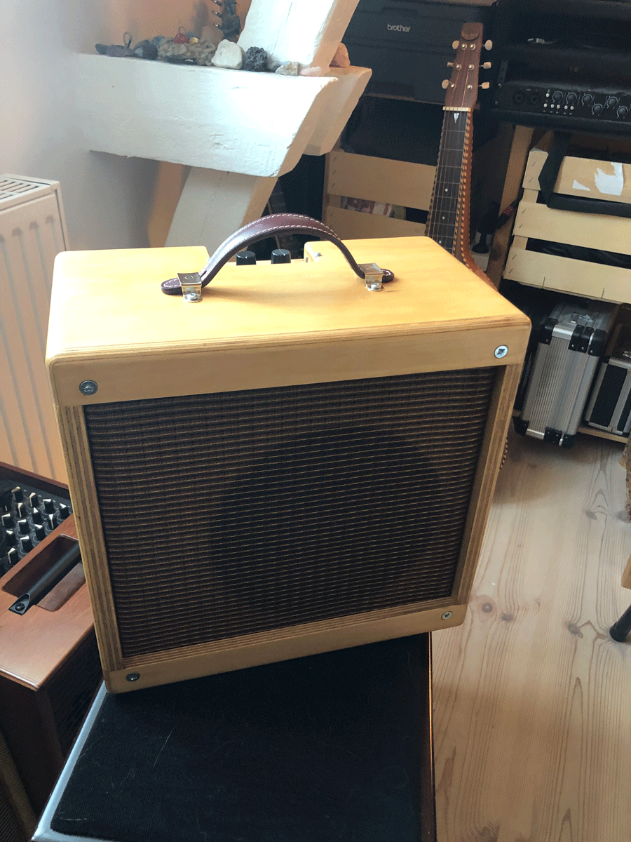

So finally, with all the bits in place, here is the finished amp. It sounds nice to my ears, and having relied on a DIY bassman for a while until now, it is really nice to be able to dial in some crunchy overdrive on the amp without sacrificing my hearing too much. I am actually surprised by how nicely this amp distorts, it is not as organic as the bassman but its close and it doesn't cause the windows to rattle and nails to loosen from the walls so i'll take it.

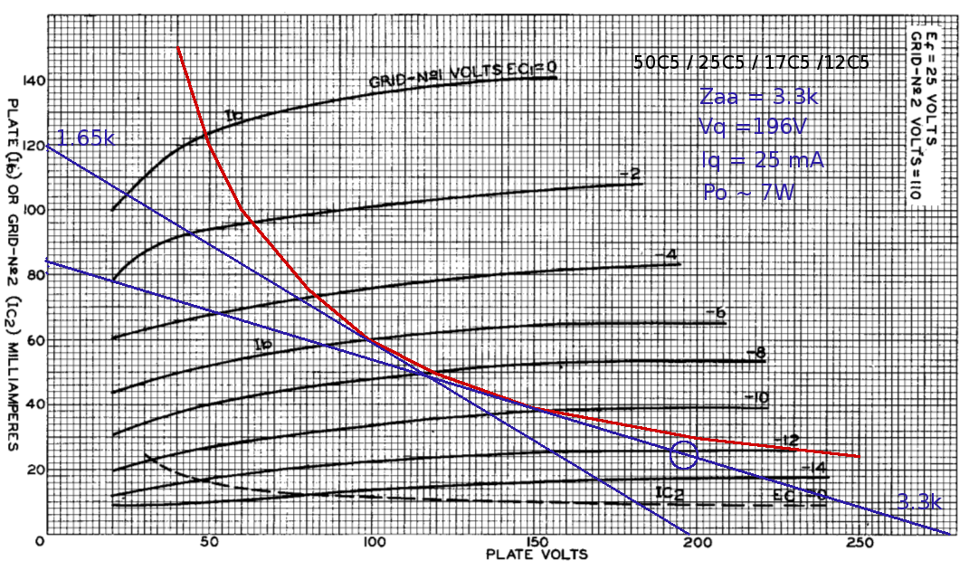

Yes, it's always the tap rated for four times the power (of the other tap you plan to use.)The center tap is then the 6w line if I follow your logic.
The textbook-standard answer is "No!", because for SE use, transformers have to tolerate a large DC current through the primary, which would normally produce a large DC magnetization in the core, which in turn means the transformer is likely to saturate prematurely when AC is added.Will these also work for SE amps?
So SE transformers have a deliberate "air gap" in the core, which lowers the amount of magnetic flux; to compensate, the transformer itself has to be bigger and heavier than the push-pull equivalent.
That said, I have actually read more than one thread in which someone who is not an EE, rushing in where angels fear to tread, simply hooked up one of these cheap audio line transformers to an SE valve amp, and found that it worked just fine for him.
I think the key to making this work is to over-rate the transformer. If you use a cheap 10 W audio line transformer in a tiddly SE amp that puts out, say, 2 watts, there's a good chance the transformer will cope with the small amount of DC current and AC power.
Firstly, is 1.5W really the lowest-power tap you can find on an audio line transformer? A lower-wattage tap will yield a higher primary impedance, and it may be easier to find valves to work with that.what are the options for PP designs that fit a 6.6k load and run to only a few watts?
(I made up a spreadsheet some years ago with data for various audio line transformers, and I'm pretty sure I have primary impedances up to about 20k there. I forget how many watts that corresponds to.)
That said, if you must use 6.6k, each valve sees only 3.3k in class A operation and only 1.65k during the class B part of its cycle. So we're looking for a low-power valve that can supply (relatively speaking) a lot of current, and run from a low B+ voltage.

Something to ponder: a load-line for a pair of 12C5 (or 17C5, 25C5, 50C5) in push-pull.
The essentials are a 3.3k Zaa OT, 200V B+, each 12C5 biased to 25mA, resulting in estimated output power just under 7 watts RMS.
The 200-volt B+ is a bit of an awkward value. For a cheap-n-cheerful amp, I would drop that to 170 volts (diode-rectified 120V AC), which would allow the use of a cheap 120V:120V mains isolation transformer as the power transformer. Output power will drop, but for home use, it'll probably be too loud either way.
