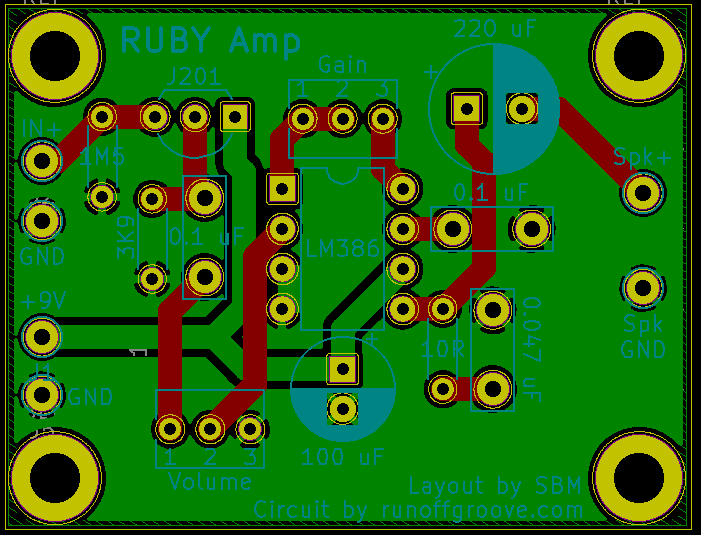

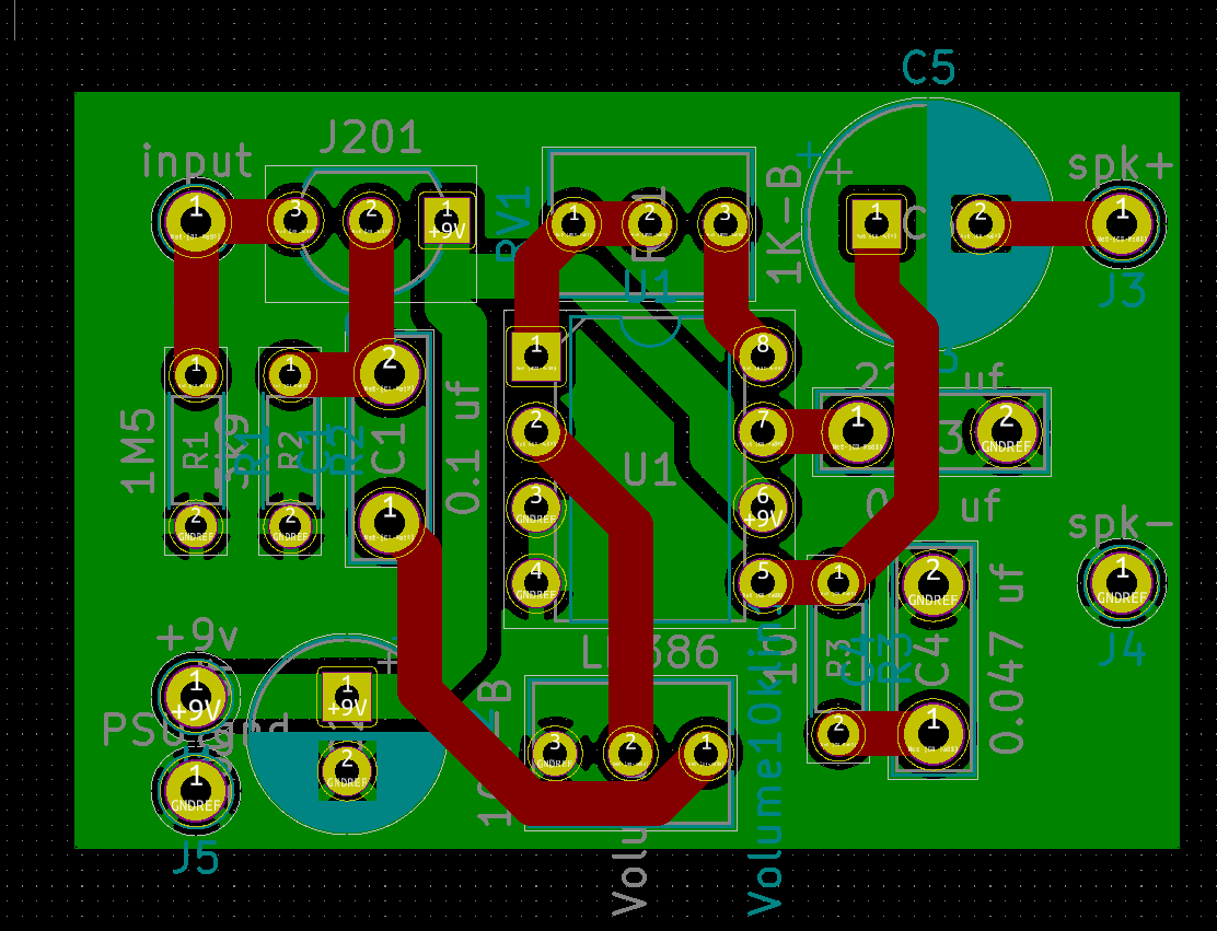

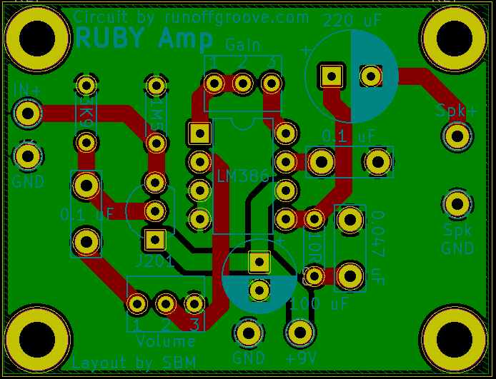

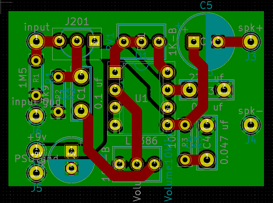

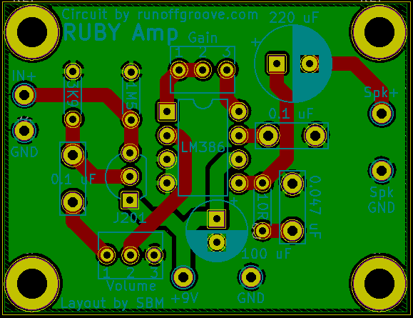

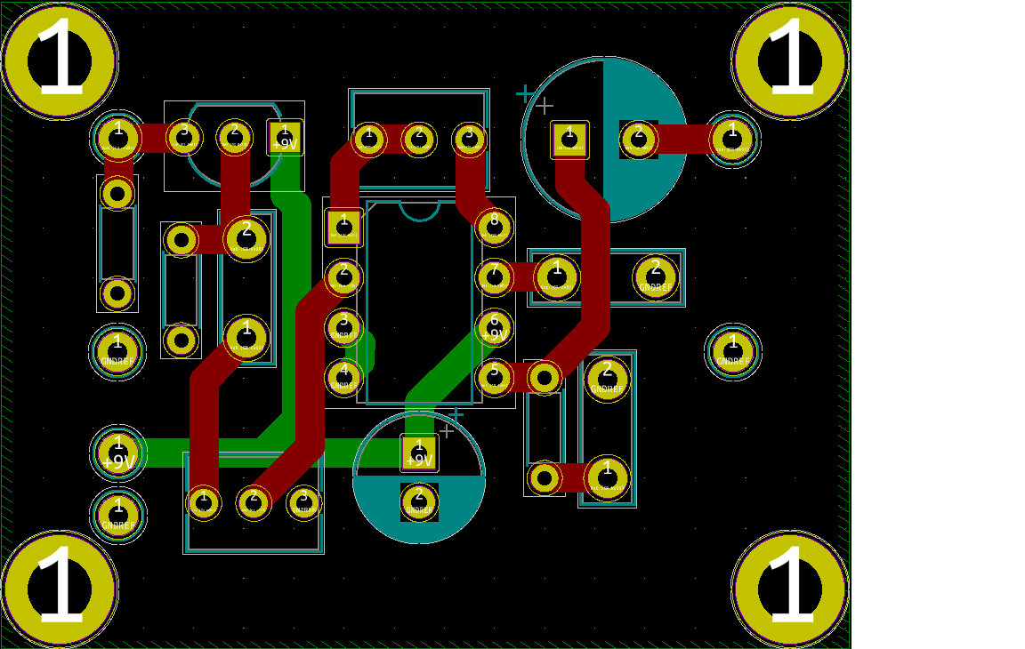

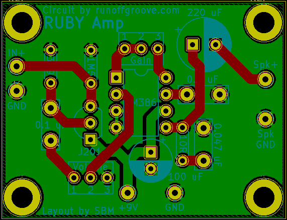

2-sided board for Ruby Amp

back to the ruby: I put the prototype circuit in a wooden box and rapped it with tin foil. it's now absolutely quiet - no noise pickup at all. before i did that i found out that the circuit is especially noisy (weird screeming sounds) when there's nothing connected to the input. these noises go away as soon as a guitar is plugged in or even if the input is shorted to ground with a finger.
i now use it in the bassman configuration with 22ohm headphones and a 680R resistor to ground for attenuation. as gnobody said, the LM386 needs to be driven hard to distort - so a 10R or 20R resistor to ground would certainly NOT be enough to attenuate sufficiently.

...the circuit is especially noisy (weird screeming sounds) when there's nothing connected to the input...
This is normal. Guitar amps have sensitive, high-impedance inputs, and those pick up all sorts of noise from the air.
That noise can be very annoying, and fortunately, there is a pretty simple fix: use a switching jack at the input, and wire it so that the input of the amp is shorted to ground (via the jack's switch contact) when nothing is plugged in. Now your amplifier will stay quiet when the guitar is not plugged in. :)
-Gnobuddy
By the way - if you find the Ruby sounds too harsh in your headphones when the amp is distorting, you could try adding a capacitor across the headphone jack. For 32-ohm headphones, with left and right wired in parallel, somewhere between 2.2uF and 4.7uF will probably be about right.
The capacitor will roll off very high frequencies, reducing harshness. (A real guitar speaker does the same job even more effectively.)
Most amplifiers don't like having a lot of capacitance connected between the output and ground, but in your case, the 680R resistor you're using will keep the amplifier from "seeing" the additional capacitor. (The cap is wired across the headphone jack, so the 680R resistor is in series with it.)
Ideally, the capacitor you use will be a non-polarized type. Film capacitors will work (but are bulky and expensive). My suggestion is to use a multi-layer ceramic chip (MLCC) capacitor, which is small and inexpensive. Like this one: FG18X5R1E225KRT00 TDK Corporation | Capacitors | DigiKey

Thanks for the suggestion regarding the capacitor across the headphone jack. I'm experimenting with that as we speak.
This amp sounds great but if i want to distort it fully it gets wayyyy to loud - also using a 8'' speaker cab. So i'll use a pot at the output for sure to control overall volume. Now which is the 'better' way to wire it? Attached are two drawings. V1 is the "series resistor" version and V2 would be a voltage divide "in front" of the speaker. What are the pros and cons of those options?

...if i want to distort it fully it gets wayyyy to loud - also using a 8'' speaker cab...
A year or two ago I built a tube guitar amp with about 0.1 - 0.2 watts of output power. Connected to the 10" guitar speaker in one of my Fender amps, in my apartment, it was too loud!
So yeah, 0.5 - 1 watt or more of distorted LM386 output into a sensitive speaker might be much too loud for a home or apartment.
The simplest thing to try is to run the LM386 from a lower voltage. It's rated for operation down to 4 or 5 volts, so you might try 4.5 volts from three alkaline cells in series, or a generic 5V USB charger / power supply you probably already have sitting around. This will reduce the output power a lot, and may make the amp quiet enough for your purposes (with the loudspeaker). With the headphones, you'll still need the series resistor.
(The datasheet says 125 milliwatts into a 4 ohm speaker at 4 volts power supply; depending on your speaker sensitivity and the SPL acceptable to you, this may still be too loud.)
If you like the USB power supply idea, you might need one of these tiny breakout boards: SparkFun microB USB Breakout - BOB-12035 - SparkFun Electronics
This is too big a question to answer without writing a small book in the process, but I'll give you a quick personal opinion, and then point you at some resources for the facts.
The opinion part: for this little guitar amp, it's not worth trying to design the right voltage divider. Stick with V1, and for the loudspeaker, my best guess (I don't know how loud you want it) is to use a 50 ohm or 100 ohm linear pot, if you can find one. Ideally the pot would be rated at 1 watt or more. For headphones, as you've already found out, you need much more resistance, maybe as much as 1 kilo ohm.
More opinion: if you can find an L-pad in your country, this is a specialized type of voltage divider (actually a pair of them in one housing) already designed to do exactly what you want: Speaker L-Pad Attenuator 15W Mono 1" Shaft 8 Ohm

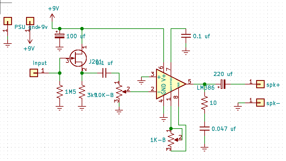

i managed to finish this project last week. so here's my ruby headphone / speaker amp
I ended up using the original schematic with the following additions:
1.) output can be switched between headphones (680R to ground) or speaker (no additional resistor)
2.) there's a 1k pot to adjust output volume (in series with the 680R for headphones)
3.) 2k5 gain pot
4.) ceramic cap in parallel with the 220uF electrolytic between V+ and GND
5.) 10uF electro between pins 1 and 8
it wasn't easy to fit it all in one box but i managed and i think it looks fine. most of all i just loooove the sound of it. the cleans are fantastic and the overdrive as well .... with these modifications and boxed in the enclosure the circuit is as quite as a mouse. no noise pickup or anything.
things i like:
-) the sound
-) the additional output volume. i think the circuit is a bit useless without an output volume as the distorted tones will we way to lound for anything but a stage ...
things i'll add for the next version :)
-) i used a 2k5 pot for gain but i really kind of use it as an on/off switch. maybe it'd be better to use a switch for high / middle / low / gain
-) the 1k log pot at the output doesn't give me a useable range - it's too sensitive toward the end. I think someone mentioned using a reverse log and that would probably be the better choice.
again: thanks for all the help! this certainly has been a fun project and i'll be back with a version 2 soon :)
