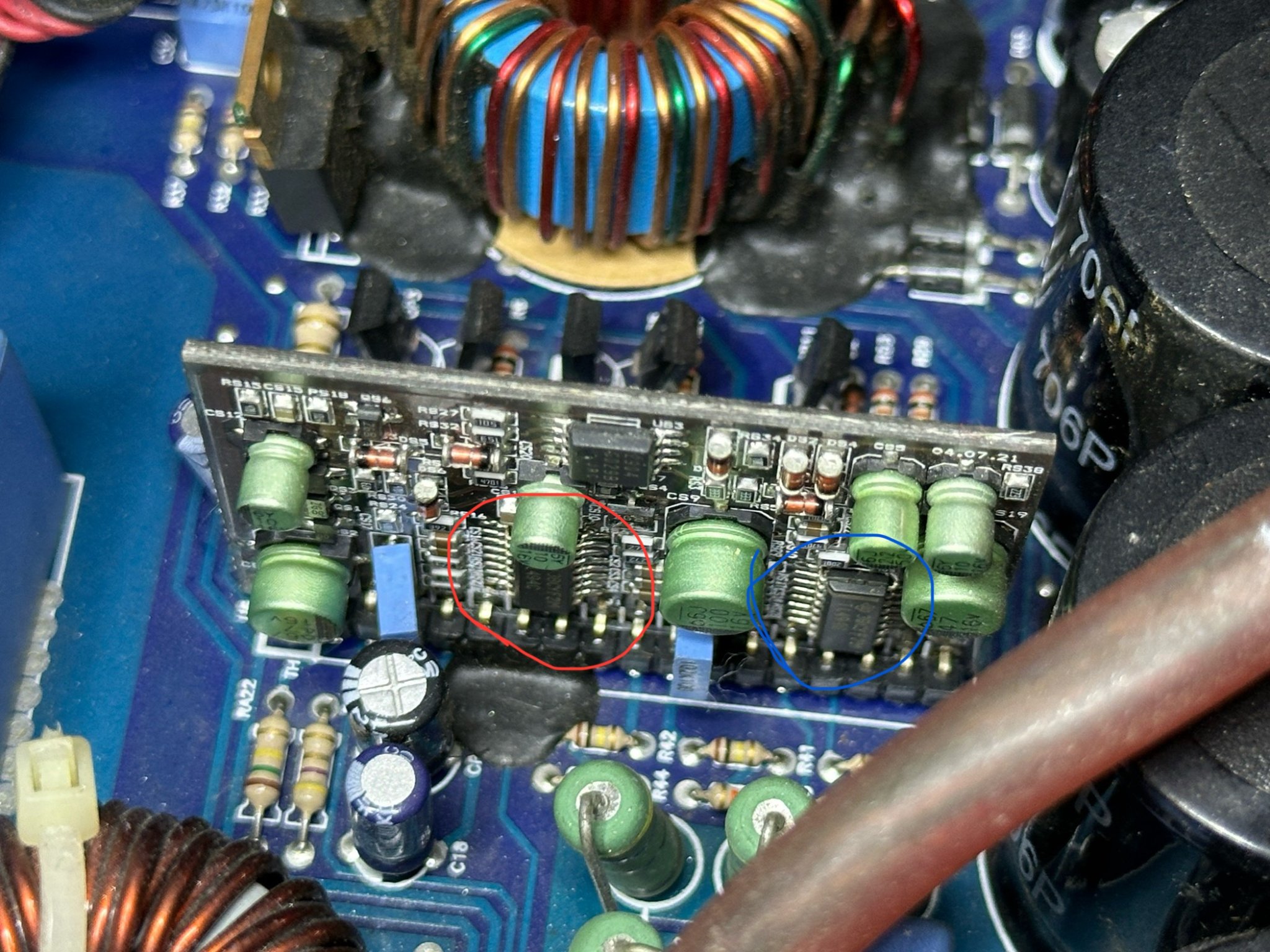

9 and 10 showed the same for everything on both chips
Chip circled in red showed only some noise in normal idle
Half protect showed some oscillation of some sort
Circled in blue showed nothing in half protect but I’m also not sure if I was properly making contact with it

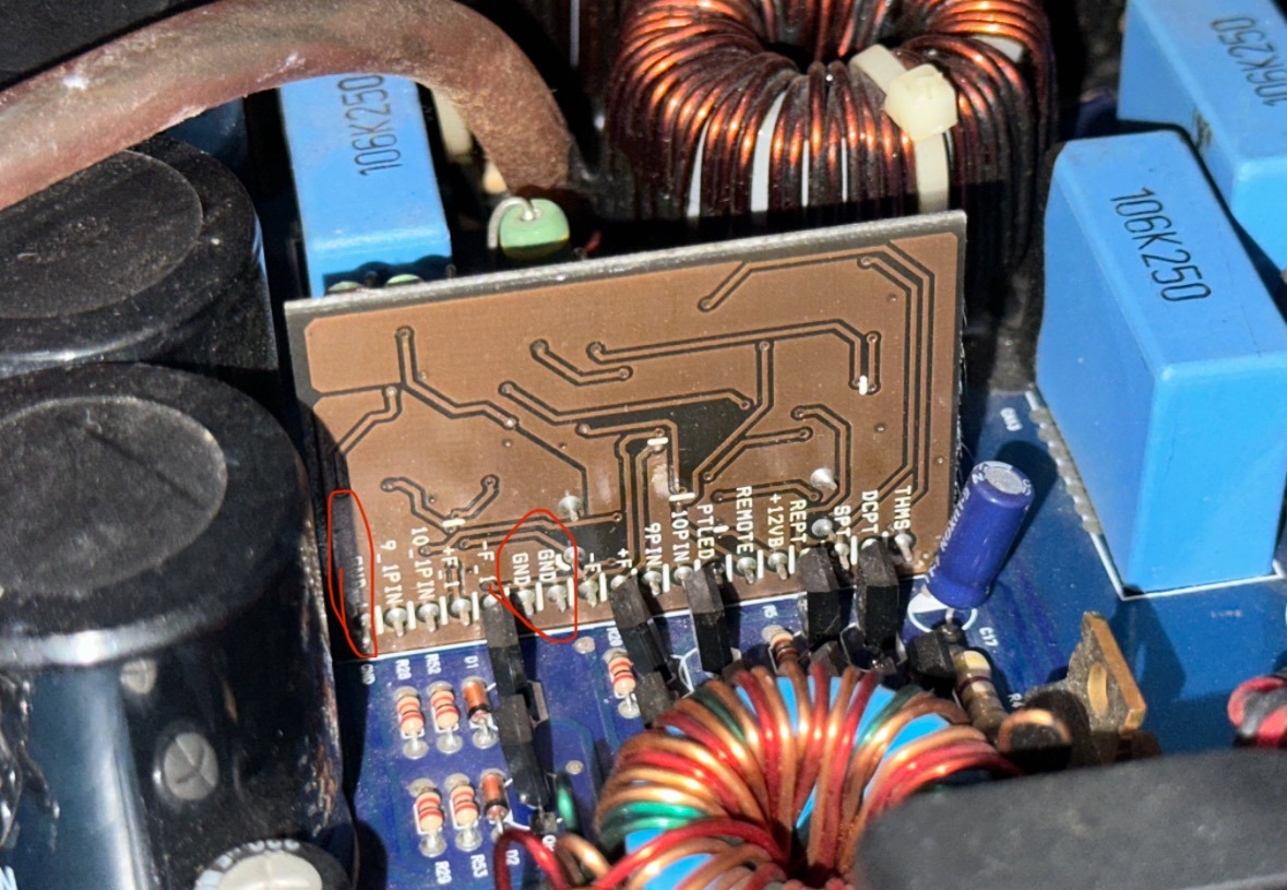

Do you see excessive noise on the B+ or remote terminal of the PS driver board?
To check this, solder a short piece of wire to the ground terminals of the driver board and use the short grounding lead that clips onto the end of your scope probe to connect that that short wire. Don't let it move around to contact anything else. Then probe B+ and remote (and any other pins) to see if one is noisy.
Check these as the amp goes from normal operation into protect.
Do you see excessive noise on any of those terminals?
Why don't you want to solder? You can do it from the top.

I like to avoid soldering if I can as I do not wish to screw anything up by accident but I could if necessary.
