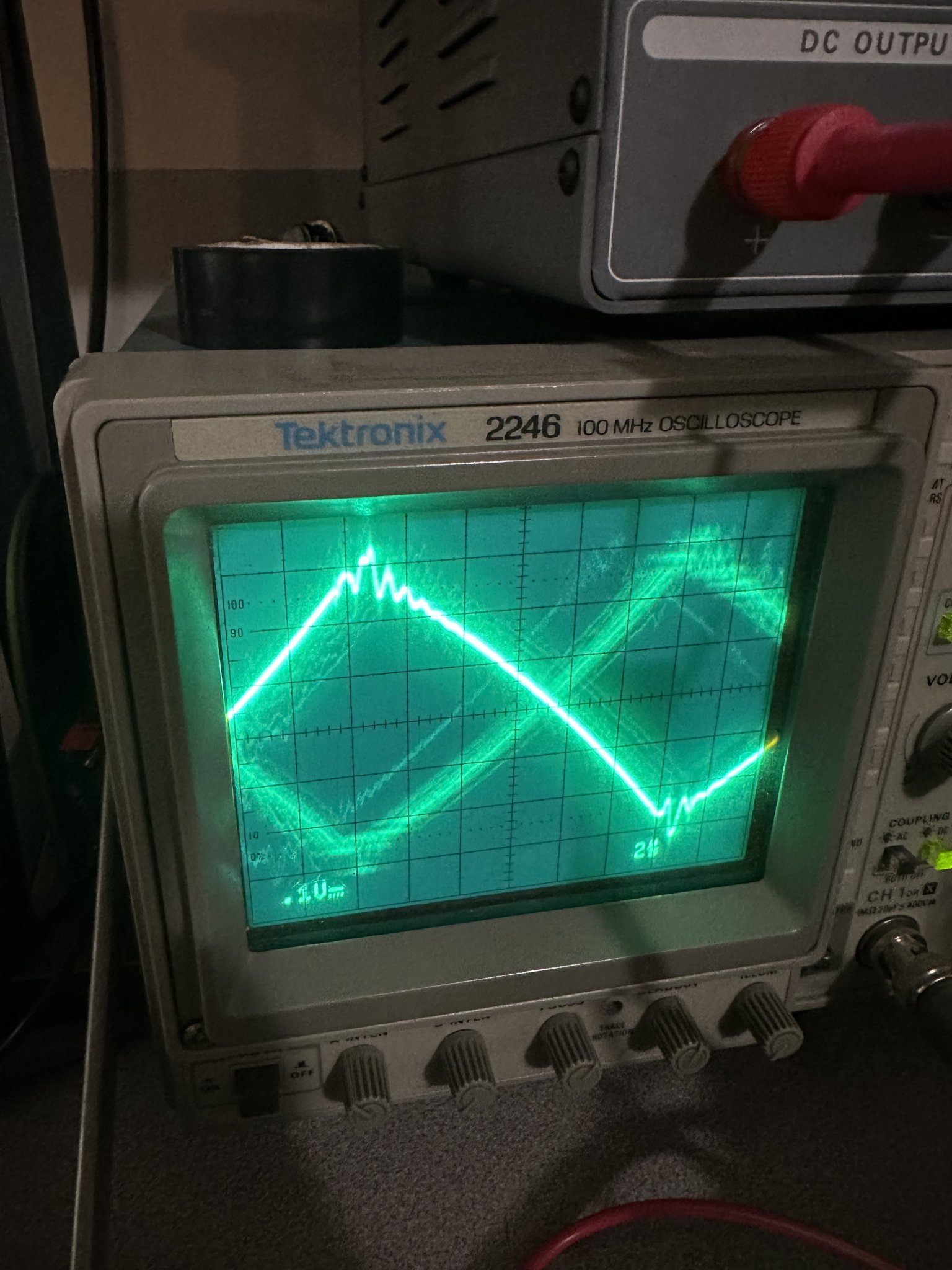

These are my findings of the current status of the amp:
With remote on it seems to turn on normally (no signal to rca)
Probing speaker terminal scope shows negative DC build I believe (line jumps down a bit and rises to 0v repeatedly)
Relay clicks, no change
Passing 40hz signal through the amp, about 1/3 headunit volume (below 1/3 there is no change), amp protect light dimly lights, a buzzing begins near PS transformers and stays constant, speaker terminal changes into sawtooth wave and stops jumping
With no signal input the sawtooth wave is clear, gets blurry with signal, I assume the blurring is audio signal (both headunit volume and amp gain change blurring)
Stopping signal makes it clear again
Sawtooth peaks have some sort of wave on them (both with and without signal) picture provided
Changing subsonic pot makes the wave glitch out and the buzz near PS transformers turns to chirping
R7 is still removed
R70 is bridged over
Those 2 caps are still added

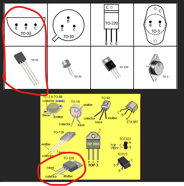

Q3
Base: 0v
Collector: 14.49v
Emitter: 0.51v
Q4
B: 2.14v
C: 0v
E: 0v
Q5
B: 13.94v
C: 0.51v
E: 2.17v
Q50
B: 0v
C: 2.21v
E: 7.23v
Going off the photos attached for pin locations
Top row is Q4, Q5, Q50
Bottom group is for Q3
I can understand for some but for the KSP2907a, the datasheets come up at the top of the search. The others may need a KT of 2S prefix.

You were correct about the sawtooth being a higher frequency, I changed my scope settings and was able to see the 40hz wave
The DC on the speaker terminal is only in normal power
When the amp goes into half protect the DC build stops
