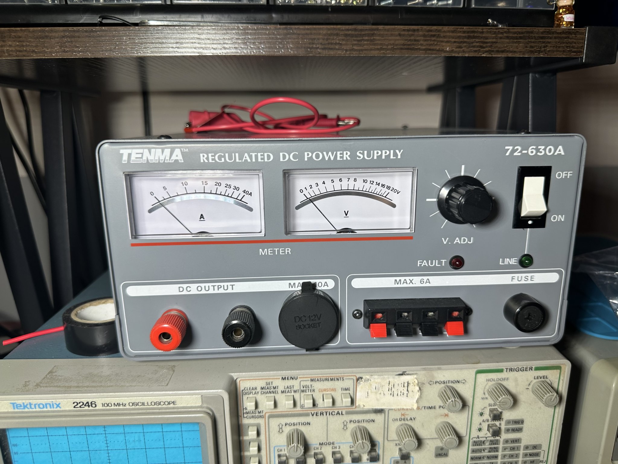

Power supply is only outputting 11v as of right now
11v source
I checked DP5 which I believe is just before the relay, had about 11v DC on both sides

My supply, I'm not sure why, sometimes it will go up to 14v, sometimes it wont go over 11v
When starting up it goes up to about 14v and drops to 11v even with nothing connected
Its an older supply, I'm wondering if the caps in it are bad, I don't really have a good idea on how it works
It’s supposed to go up to 20v

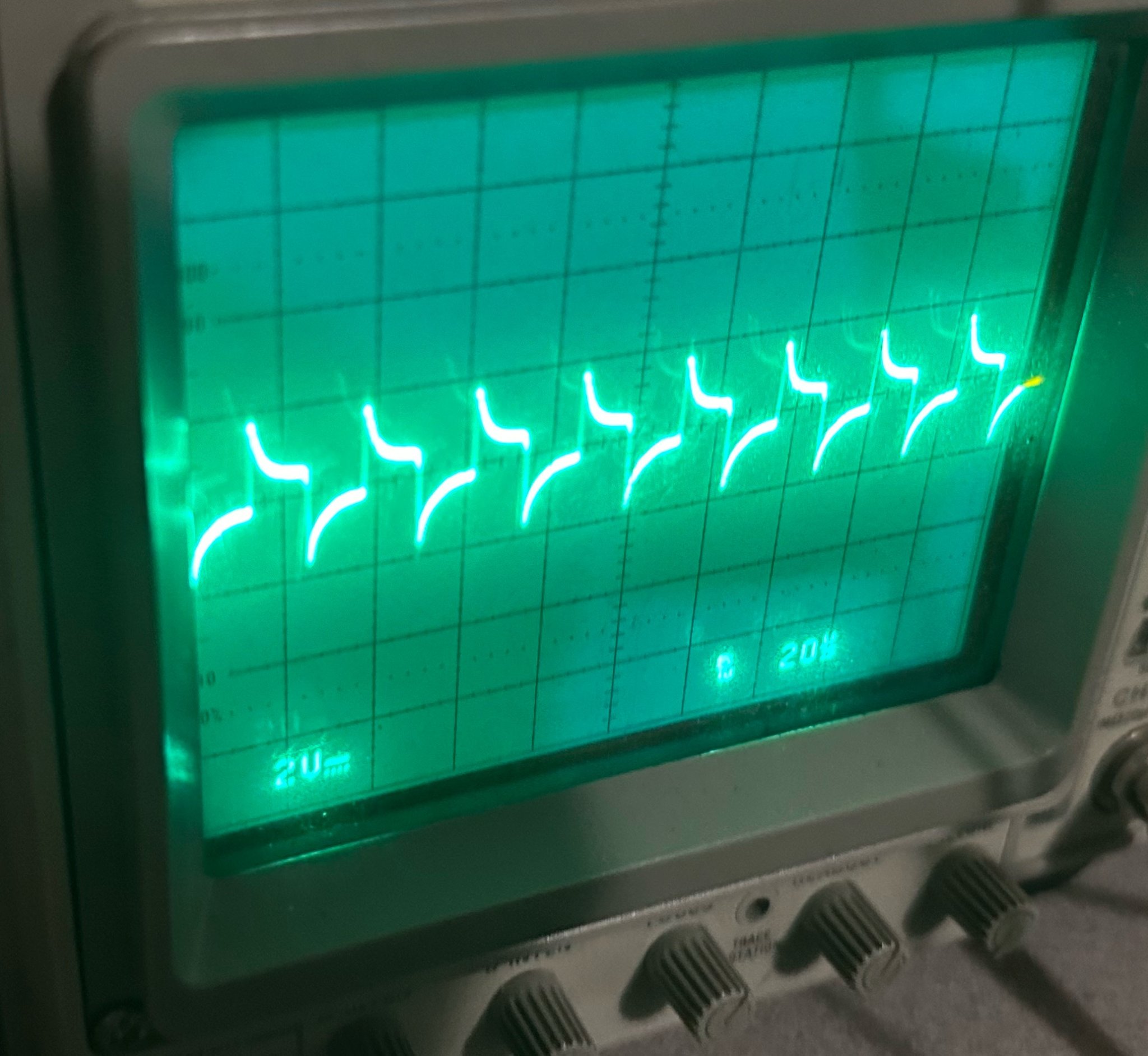

I just checked my supply with my scope and realized one of the lights were creating this on the power output on the supply (photo 1)
With it being unplugged this is the power output on the supply (photo 2) these photos were taken with the same scope settings
I did not realize this in the previous post about you asking if other things are plugged it to the power strip
It’s a 40amp power supply, I’ve seen it output 20a one of the times I hooked it up previously and it was behaving like this (I was powering my other amplifier listening to music, nothing abnormal from what I could tell)
I also have a 10 amp fuse on +12 when testing this amp, almost every time it goes to about 10a on the initial turn on then bumps down to 2-5a

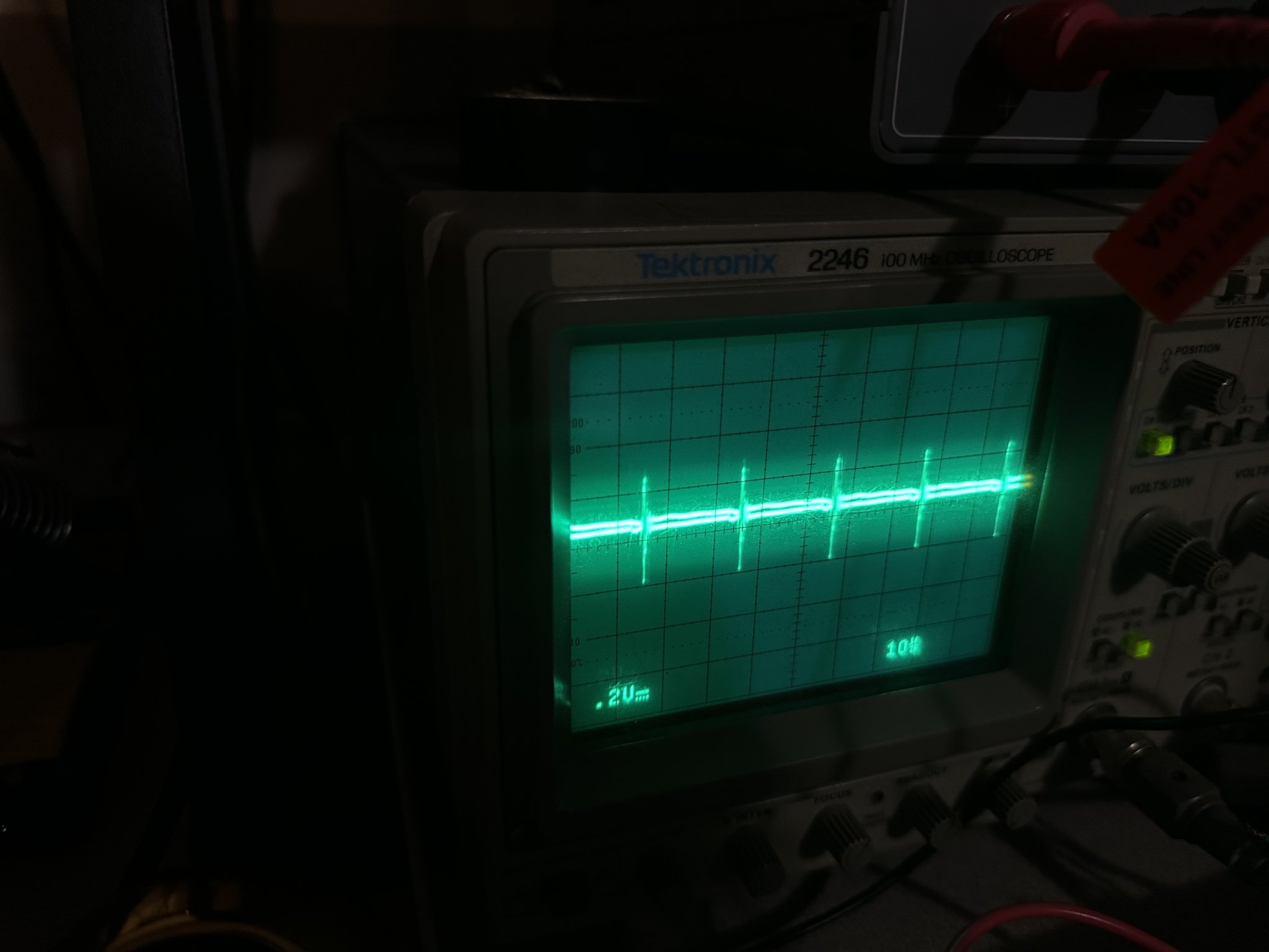

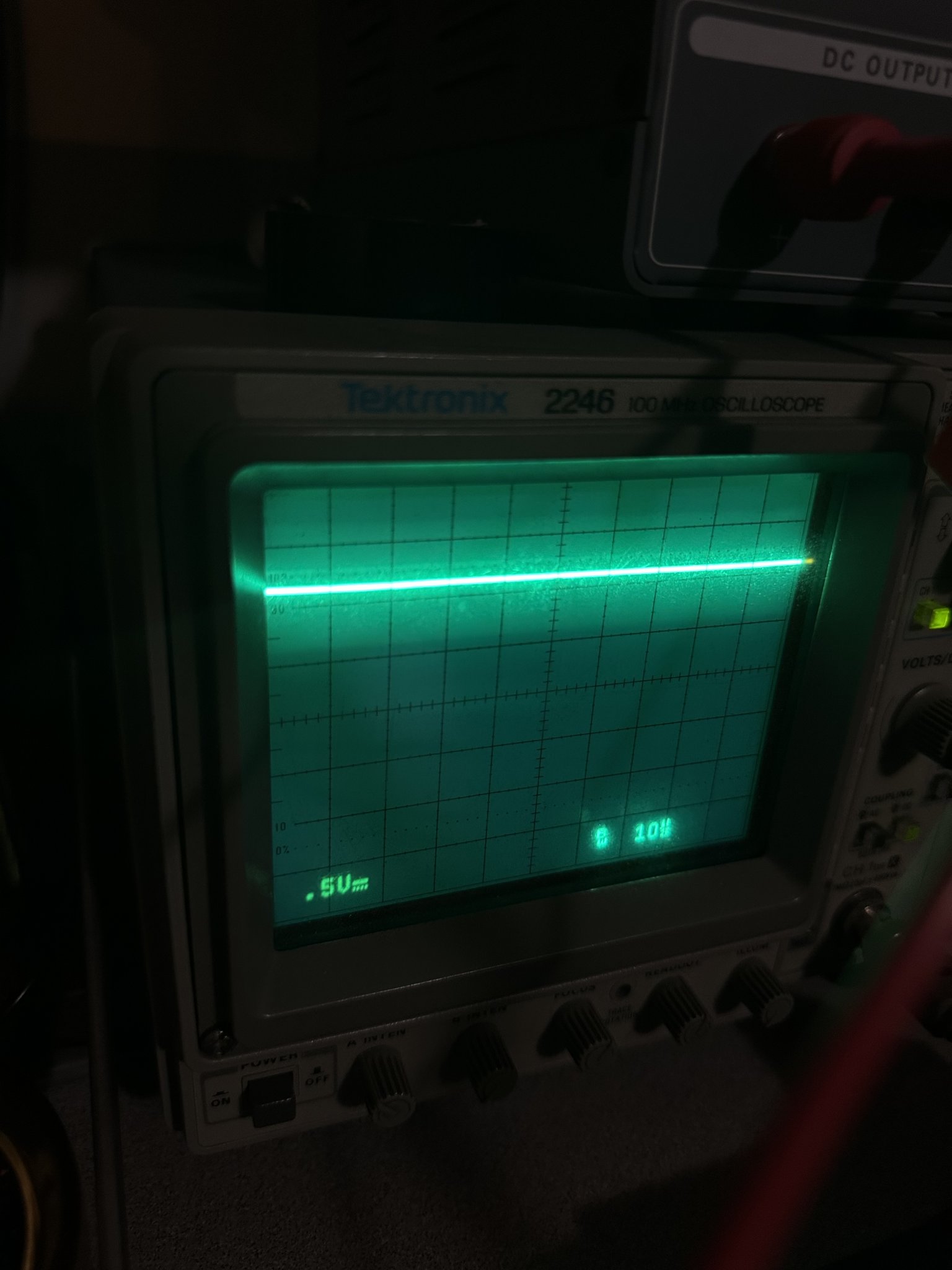

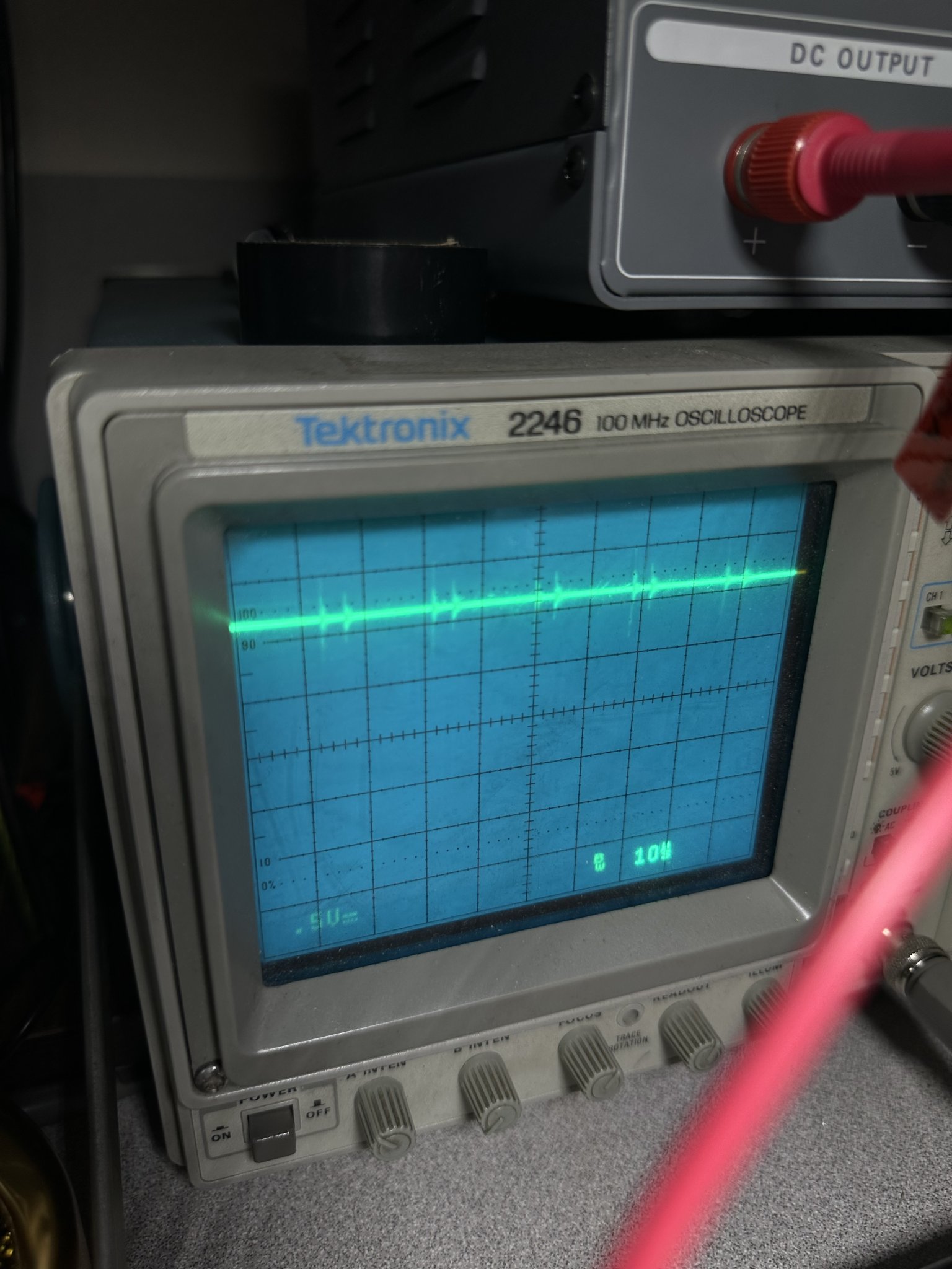

No oscillation out of half protect, all it does is flash this (first photo, about 1v peaks) every second or so then goes back to nothing

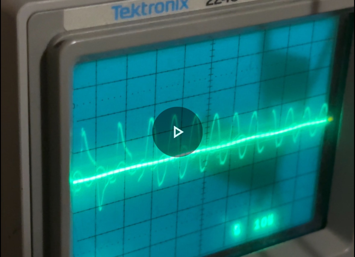

Rail-rail oscillation starts in half protect
Out of half protect, anode and cathode of protect led shows the first picture, same thing described above

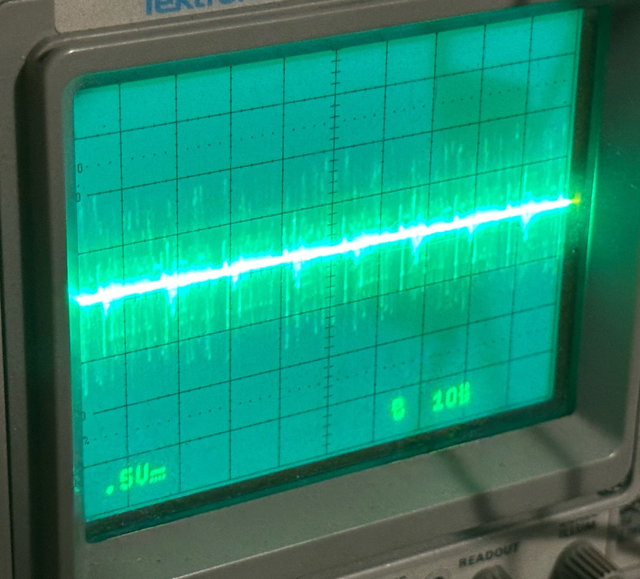

Half protect, anode shows second photo (looks to be about 2v peaks), cathode shows third photo (0v with some noise)
