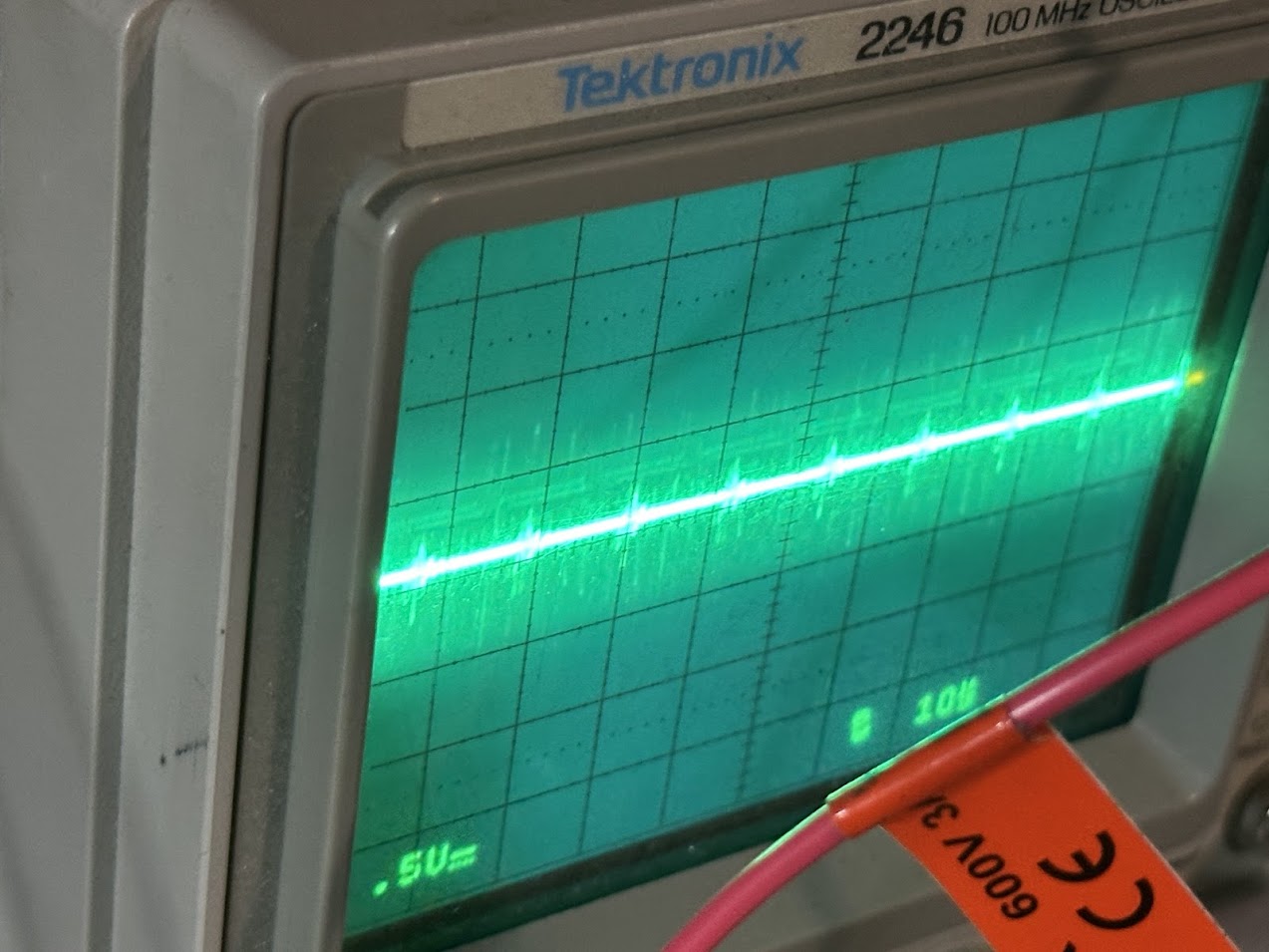

I see it at DS6 cathode (I misread your post and read DS6 but it happened to be there)
Not at DS2 or DS4
Might be a hint of it at DS7 but may just be other noise
Not at DS2 or DS4
For RS35, do you see more of the noise on the DS6 end of the resistor or on the protect LED end of the resistor?
For RS30, do you see more of the noise on the DS6 end of the resistor or on the other end of the resistor?
I see the noise on both sides of RS35
I see the noise on the side of RS30 closest to the top of the board
Closest to the top of the board doesn't tell me anything. Is that terminal of RS30 directly connected to DS6?
That seems like you have a bad ground reference. Using the scope probe's short ground lead, connect it to pin 7 of the PS driver IC (solder a short, small wire to that pin or a close circuit point to clip to) and re-check for noise on all these points (and previous points). Set the scope to 0.2v/div.
Ground to pin 7 of US1. Either to the terminal directly or to a very close point in the circuit if there is an easier point to connect.

While not as good, you can ground to the ground terminal of the driver board (where the two added caps ground). Use as short a wire as you can.
