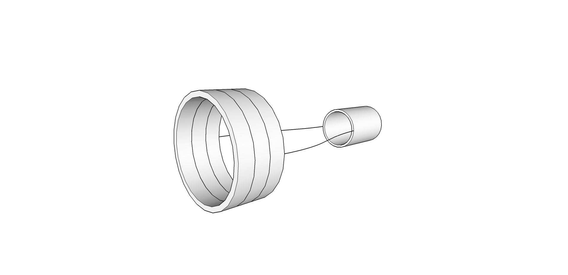

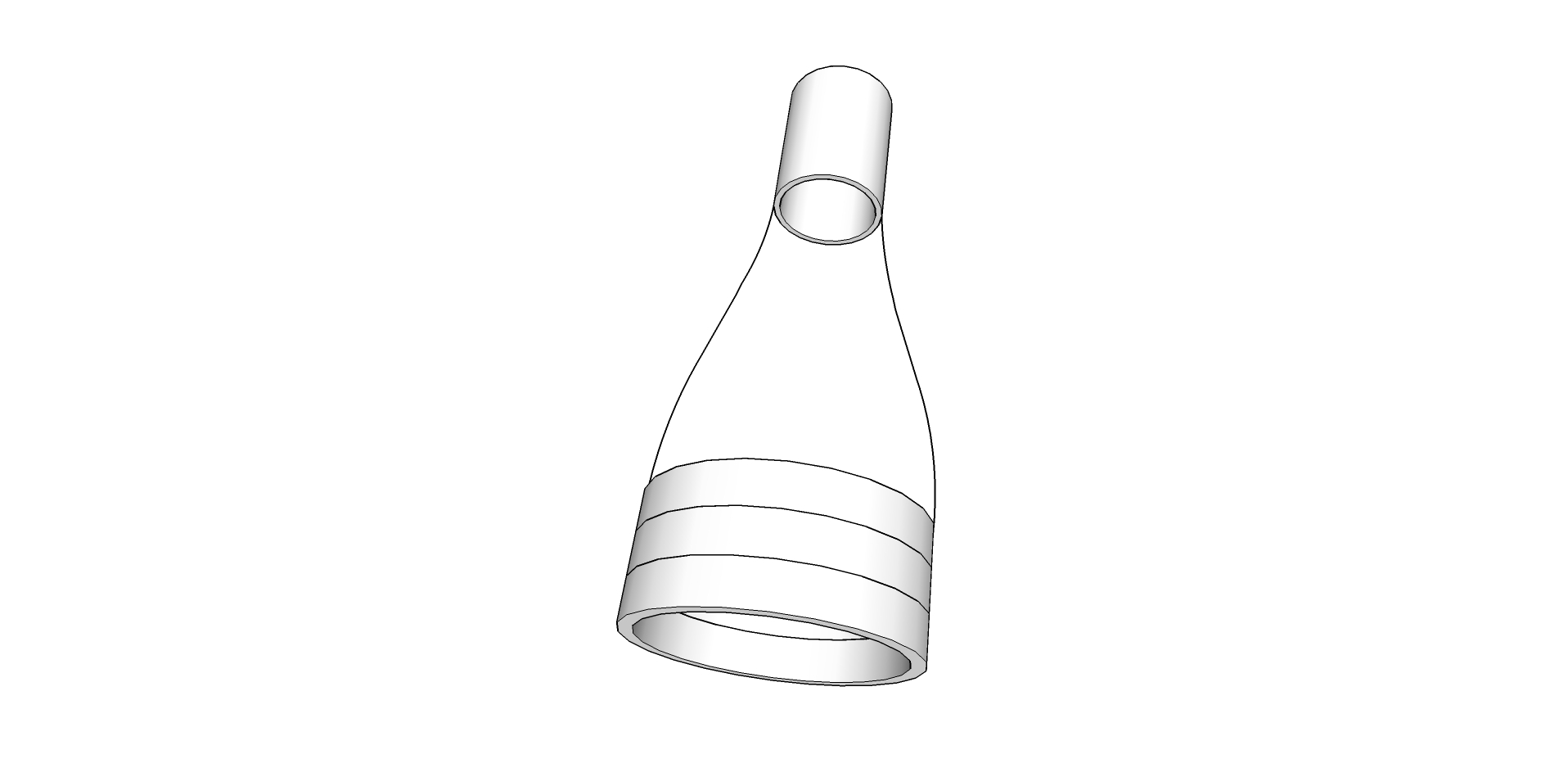

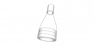

It is not a issue that the cap is shaped like a long tube at the rear?
