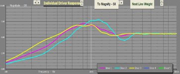

Re diffraction,
Yes BDS is simply an Excel spreadsheet and yes problems have cropped up with Excel as MS has updated its operating systems. I am unsure about windows 10 as I am an old dinosaur still using XP. Maybe this thread will be of some help.
Not familiar with VituxCAD but looking here, it appears to be able to do the same thing as the Baffle Diffraction Simulator and a bit more - actually very similar to The Edge but with actual edge manipulation available. Again still not able to sim your style of chamfered edges perfectly.

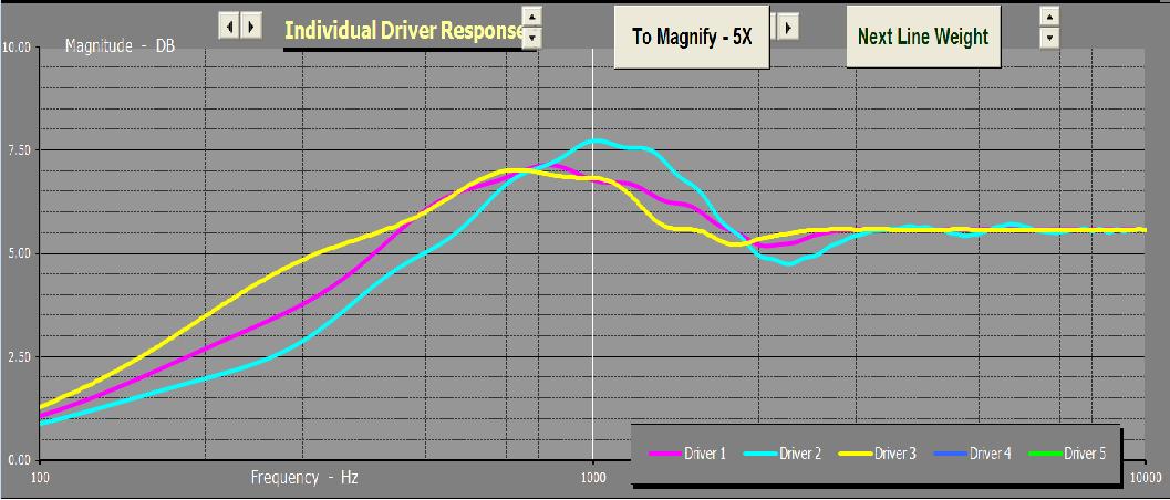

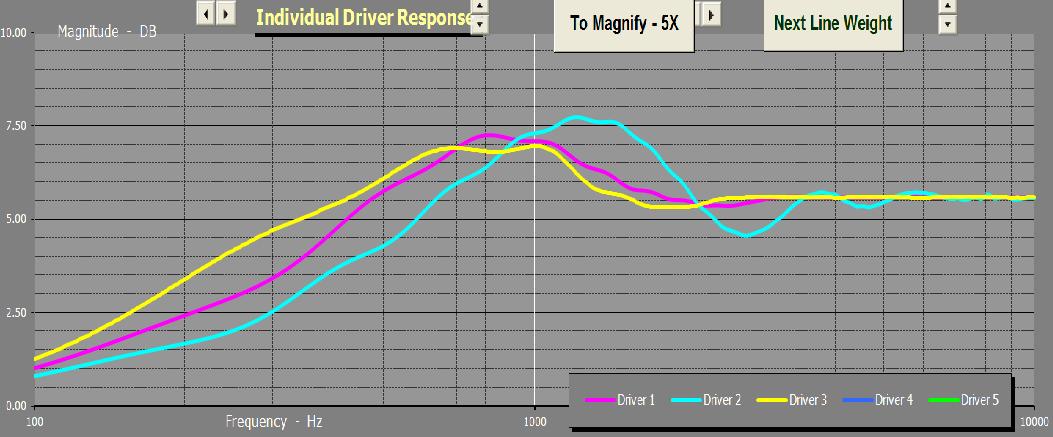

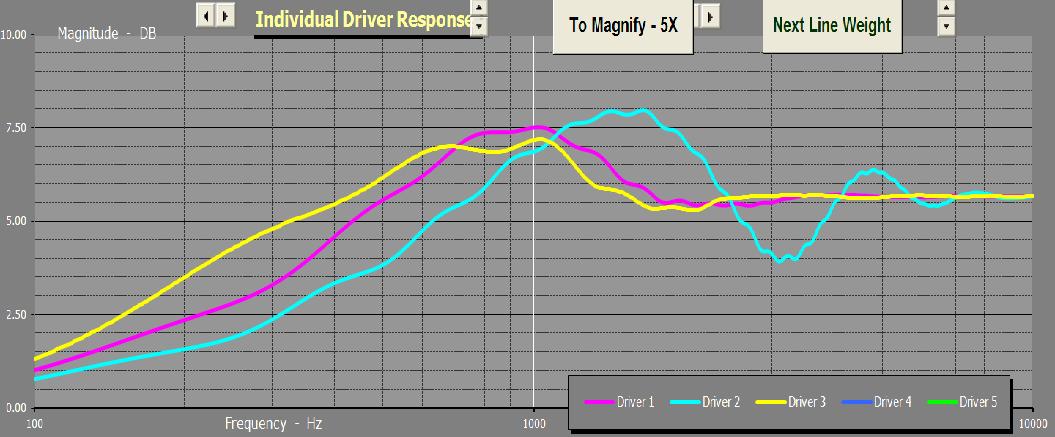

Below and attached are some further examples from BDS with again a 7" width at the top, all drivers centered: (tweeter = blue, mid = purple, woofer = yellow and be sure to note the scale)
1 - chamfer = .5" with tweeter 3" and mid 7.5" from the top
2 - same as above with chamfer = 1.5"
3 - chamfer = 1.5" with tweeter 4" and mid 8.5" from the top
4 - chamfer = 1.5" with tweeter 5" and mid 9.5" from the top
5 - chamfer = 1.5" with tweeter 6" and mid 10.5" from the top
Conclusions:
- I did actually change the woofer position once or twice but it's all irrelevant since there is no significant change below your intended xo frequency
- changes to the mid response between about 700Hz and 3000Hz are larger but also so small as to not matter very much
- so it's all about the tweeter here. The difference between a .5" and a 1.5" beveled edge is significant - larger is better. And for the smoothest tweeter response above about 2000Hz, a lower height from the top edge is better although pic 2 is actually pretty good as well.
Again, 2 things - it's not just the smoothest diffraction response you're looking for, it's the smoothest combination of the diffraction and driver response summed together that matters most. And 2nd, these are just to give you a better sense of the variables at work in your situation, primarily bevel size (and angle/length in your case) and driver height - but the Avalon-style angled chamfers on rectangular baffles can't be simmed 100% accurately to my knowledge. Horizontal driver placement matters too but you should be able to get something more than satisfactory with all the drivers centered. Offset if you can live with it but personally with that style of baffle and chamfering, it just looks way wrong to me. Hope that helps.

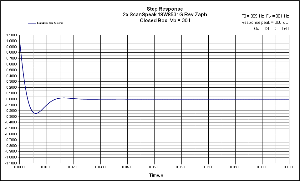

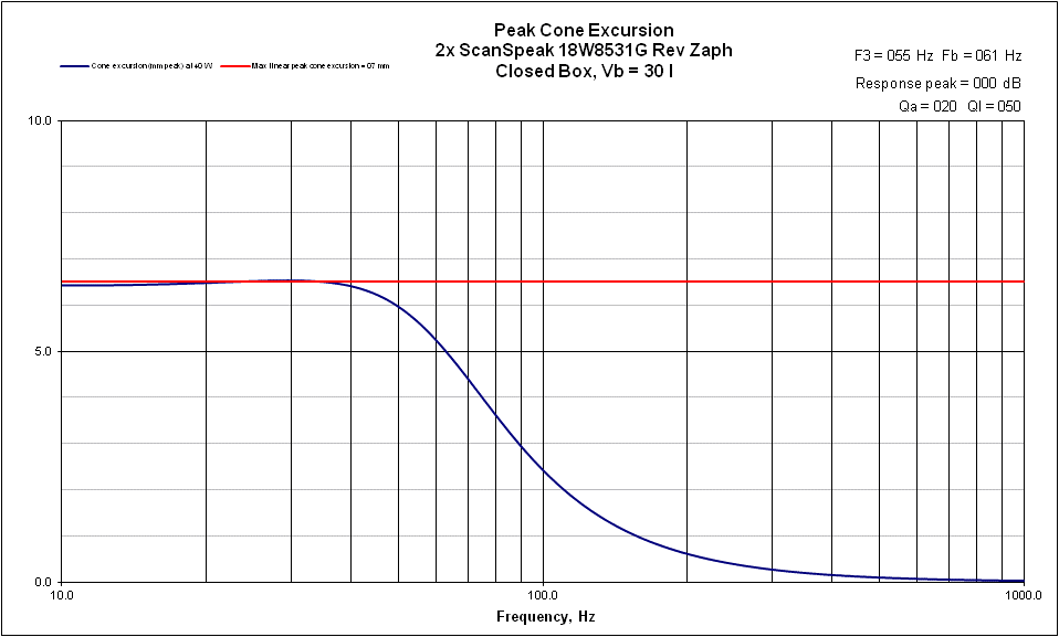

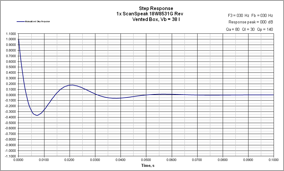

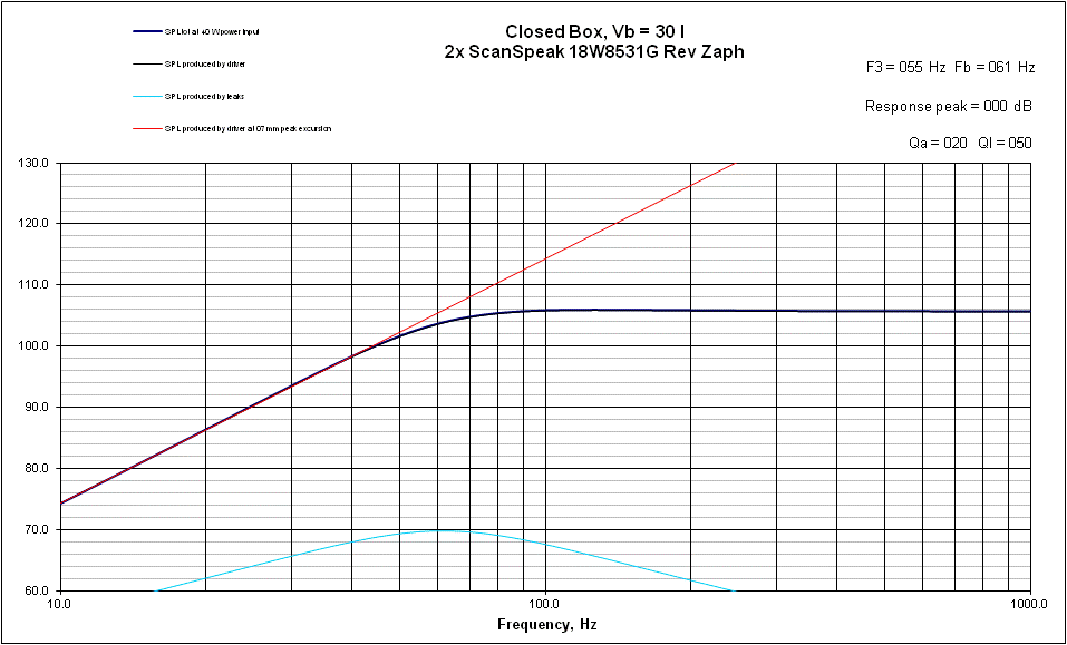

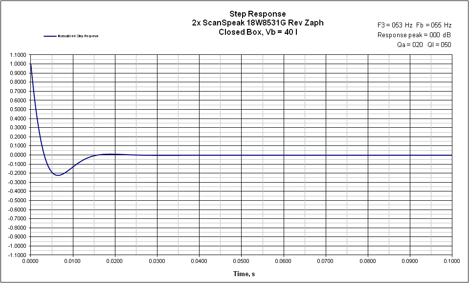

If i were to use two woofers in this cabinet as a sealed version, then i would achieve a Q of 0.8 (it seems from quick test in WinISD). By using parametric EQ's with these two sealed woofers in WinISD it seems like i can actually reach the same SPL's and a few Hz deeper bass extension than a single woofer in the ported cabinet of same size.
Does this sound realistic? (green is ported, blue is sealed with two drivers. Both speakers is reaching 103 dB SPL without the woofers traveling to far)

It will be a good idea to run everything in a more advanced program than WinISD i guess. just need time to learn one of them.

AND ---- To add to the confusion, here's an interesting article from Troels demonstrating a slightly different tuning with a bass reflex to get smaller enclosure size:
Illuminator-Monitor
Illuminator-Monitor
But this chamfer style is a rather good one right? So you are basically saying that the tweeter shouldn't get to close to the top of the cabinet right?
Indeed this chamfer style is very good. Your actual results are going to vary with how large you make the chamfer and how far they go down the sides of the baffle. And then on the driver positioning. Lower does indeed look better for the tweeter but you may be able to achieve something acceptable up higher too. Trial and error with quick cardboard facsimiles is the best way to go here. However, don't forget that the best height for the tweeter is also at your seated ear height or perhaps a little higher given your tilted baffle.
Just like the size of chamfers/radius edges, smaller changes in driver position mean smaller changes to the diffraction response. Again, you should be able to get very good results with all drivers centered.It does look better when the drivers are centered.. Is any offset better than none or do you need a certain amount of offset before it really matters?
Okay i understand.. i think i have an idea how to solve this now! I will post that later today or tomorrow! Hope you will also comment on that Would you go apeiodic or not? I see that TG actually does not in the link you provided. But it sure does sound like he likes it!
Actually, take a closer look at Troels again. He mentions in 1 of the pic captions that a 35mm port was added to the upper mid chamber after photography took place. Unfortunately he doesn't mention the length but he stuffs it with a 60mm x 100mm sheet of acoustilux so it makes sense that's it's one of those 2 dimensions.
Whenever I have the choice between ported vs sealed, I will go sealed for 2 reasons. First, sealed has better transients. Better transients is another way of saying better clarity. And in the bass it's another way of saying tightness. Or (even though I kind of dislike using these terms) clean and fast. And second, you can use different stuffing strategies with sealed which means the rear energy is better absorbed. So less reflected sound coming back out through the cone, less energy to excite cabinet resonances and less sound transmission through cabinet walls. Again, more clarity.
So we've already established that those Hypexes can give you the necessary bass boost (or drop the rest of the FR for the same effect) and I trust Zaph enough to not question those woofers in a sealed alignment (I run the 15W sealed and it is just so sweet), so now it's a question of how much volume you have to play with. With Zaph's measured TS parameters, 38L gets you Q=.7 and 30L gets you Q=.8. I would prefer something closer to the 38L which would allow the use of more high density insulation to absorb more of the lower frequencies. Other people may be able to make their own suggestions. But don't forget that adding in lighter types of stuffing results in the driver 'seeing' a bigger box than actually exists.
Take note however that you aren't quite right about xmax and max SPL between ported and sealed. Above certain frequencies they will be equivalent but down at the lowest frequencies where we should be most concerned they are not going to be the same. You need to look at what the SPL is at xmax for each specific frequency. So using Unibox instead of WinISD, I've got 2 of the 18W's maxed out in 30L using Zaph's TS parameters in the graphs below. Follow the red line in the 1st graph. Max SPL's are going to be the following:
@ 20Hz = 86dB
@ 30Hz = 94dB
@ 40Hz = 98dB
@ 50Hz = 102dB
etc....
I've also included the difference in the impulse response between 30L vs 38L sealed and 38L ported tunes to 30Hz (1 driver only). I'll leave you to draw your own conclusions.
Sealed box sims for single & twin Scan Spk
Hey Danner,
Here are the sims.
To minimise the variables I have only changed the Sd (driver surface area) to give the closest like for like single Vs twin drivers.
Its the lower Q that really helps the twin drivers.... Basically the cone is only travelling one third the distance with the lower Q larger box volume.... This greatly reduces ( over 60% reduction) a host of distortions.
If you have bought the Scan Spks thats all good.
If you have not, I can suggest a few alternatives.
Cheers
A.
Hey Danner,
Here are the sims.
Cheers
A.
