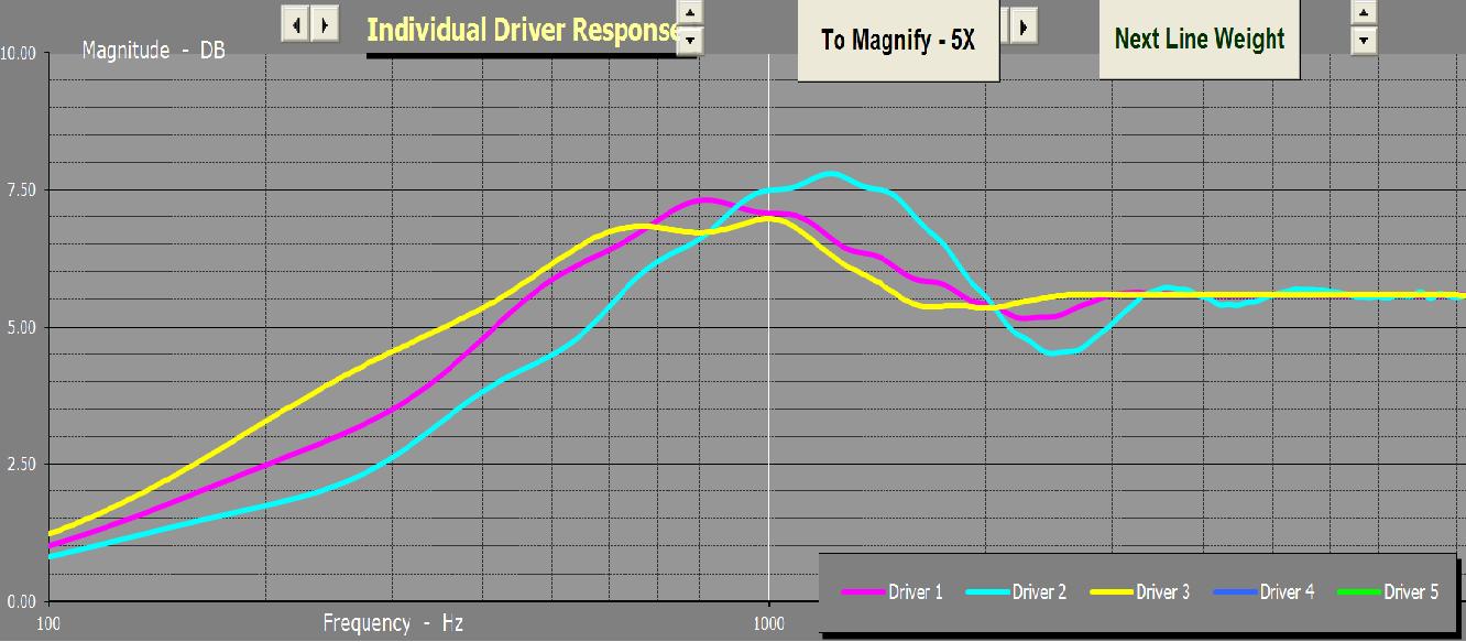

Yesterday I tried to block the port of my old speakers. I just removed the port and mounted a wooden plate over the port with foam gaskets around it. The graph shows a ungated a unsmoothed near field measurement of the woofer (tweeter is also playing). The red graph is how it looked like with the port. The blue graph is with the port blocked. Now i am wondering why the ported version has this dip? is it because I do not measure the port output in a near field measurement? The woofer isn't supposed to have a very big output at port resonance is it?
SO i guess it is correct?
Or? :confused::confused:
That's correct. Around the tuning frequency, the port dominates & the woofer's movement is reduced. Below tuning, of course, the woofer's excursion increases rapidly. IOW, the port works across a fairly narrow bandpass.
Stereophile's latest speaker review shows this well.
