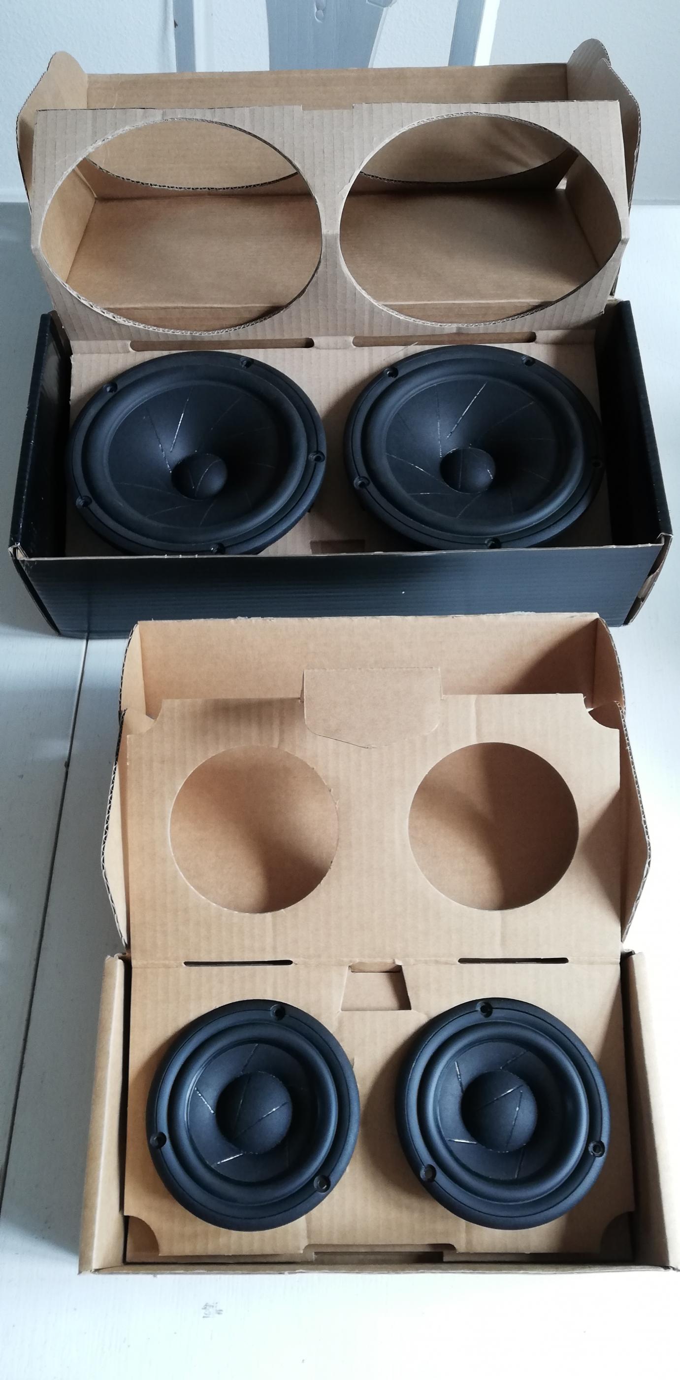

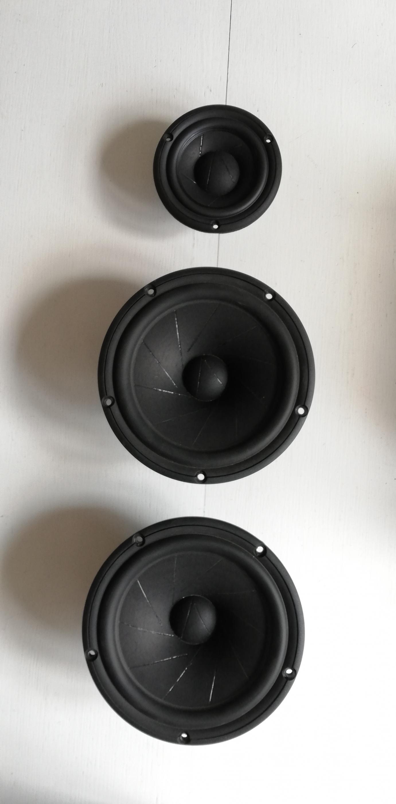

Side note!
During the last two months i have been thinking a lot about driver choices and cabinet size. I finally came to the conclusion of making a small 20L speaker with one 18W as woofer and SB's 4" SB12MNRX25-4 as my mid-range and a future sub. I chose the mid-range driver, because on paper it looks amazing! And it costs a fraction of the 12M and 12MU. So i thought it would be a good start for my journey into 3-way speakers. I went with the single 18W because of cost and mostly cabinet size.
Howeeeeeveeeer....
Last month I got an offer I simply could not resist. I could get 2 unused 3 months old 18W with receipt and 2 older12M where only one has been used for measurements and the other was unused.... All 4 at the price of two new 18W!!!! 😱
So of course I took the bait.. 😱
This means the design once again returned to two 18W and the 12M as mid. I have done simulations with Unibox which suggest 30L with heavy stuffing should be just fine with a Qtc of 0.72. So currently this is my design.
So i now have all the drivers i need to build the speaker. I am soon gonna decide the final design based on my tests with the old cabinets. Then the plan is to start cabinet building in October!
PS: I will post some pictures of the current design tonight!

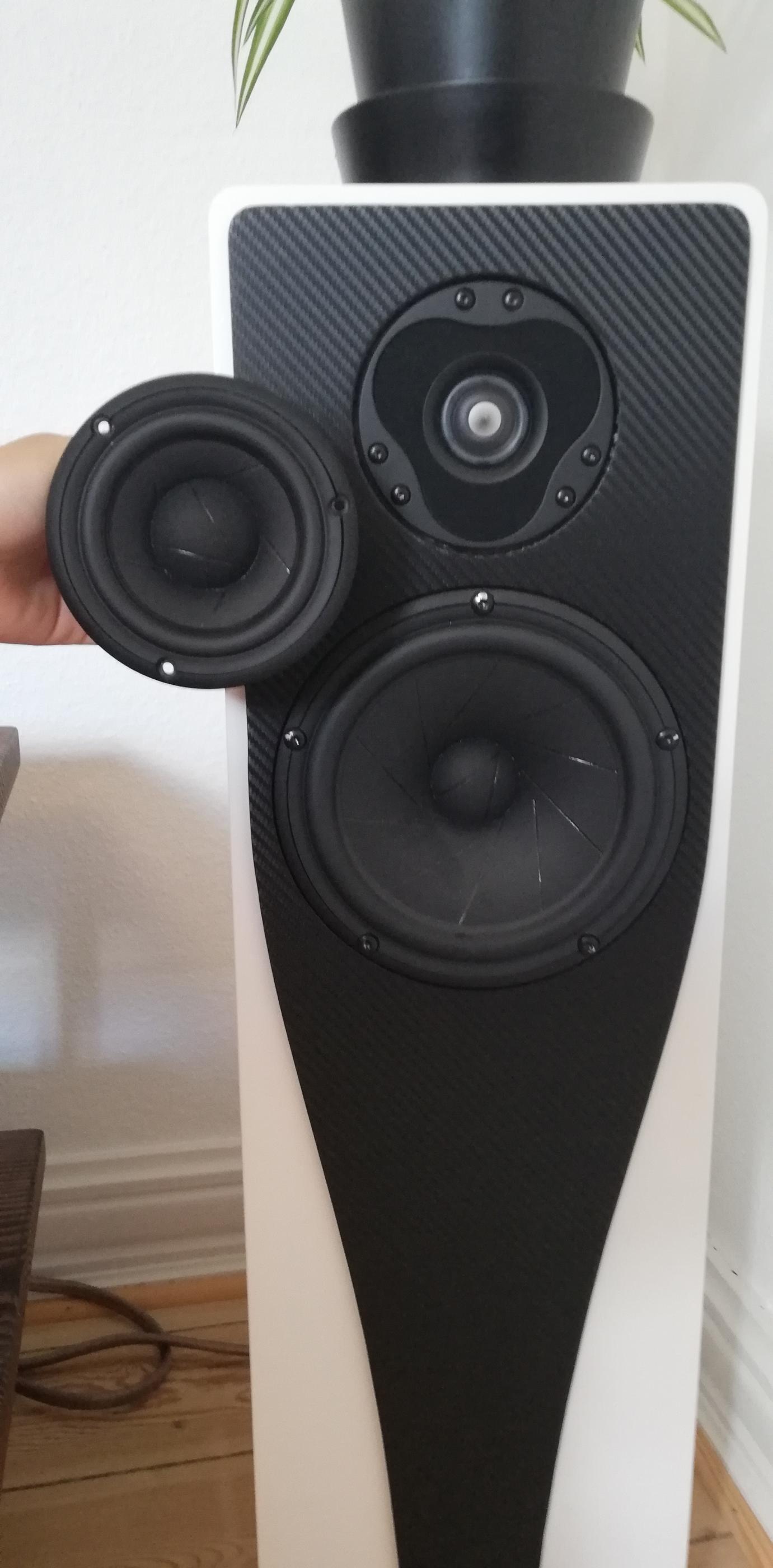

Finally got hold of a FA123, a remote kit and remote!!
2018-08-23 20.52.18 | mde | DannerD3H | Flickr
I spent the whole day today playing around with it. I removed the old crossover from my old speakers and connected the FA123 instead. I just cut the wires for the crossover and installed some good connectors. This way i can easily install the old filter and use them as usual when not playing around 😛
IMG_20180825_112135 | dav | DannerD3H | Flickr
IMG_20180825_112123 | dav | DannerD3H | Flickr
My measurments may be questionable as i don't have a microphone stand and have used a cardboard box to raise the mic for nearfield and 1 m measurmets. I also did some (almost) listening possition measurments from my couch
IMG_20180825_114014 | dav | DannerD3H | Flickr
Anyway, with the expertise and assistance from Rocky i managed to build a pretty decent and simple crossover in HFD. It uses Linkwitz-Riley 4th order for both tweeter and woofer at 2500 Hz. I added some shelfs to compensate for driver behaviour and baffle-step. This is the final filter in HFD. The graphs are based on 1m measurments from REW.
HFD filter til gamle to-vejs | DannerD3H | Flickr
Still not perfect, but it sounds better than the old analog crossover!
Now the next step will be to block the port and gradually reduce the box volume to my target volume. Then i will have to see if it is okay or not.
