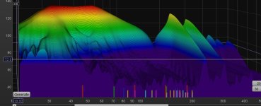

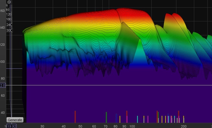

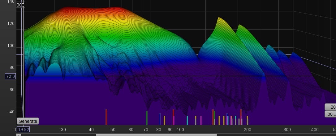

(My junk I had handy to measure)
Parallel qw pipes (top)
parallel Helmholtz (bottom)
pipes sure store a lot of energy and ring? 3x Fb is wankered.
@BP1Fanatic , do you not experience something similar in your tapped pipe? I need to measure one of mine that are tapered like yours and compare

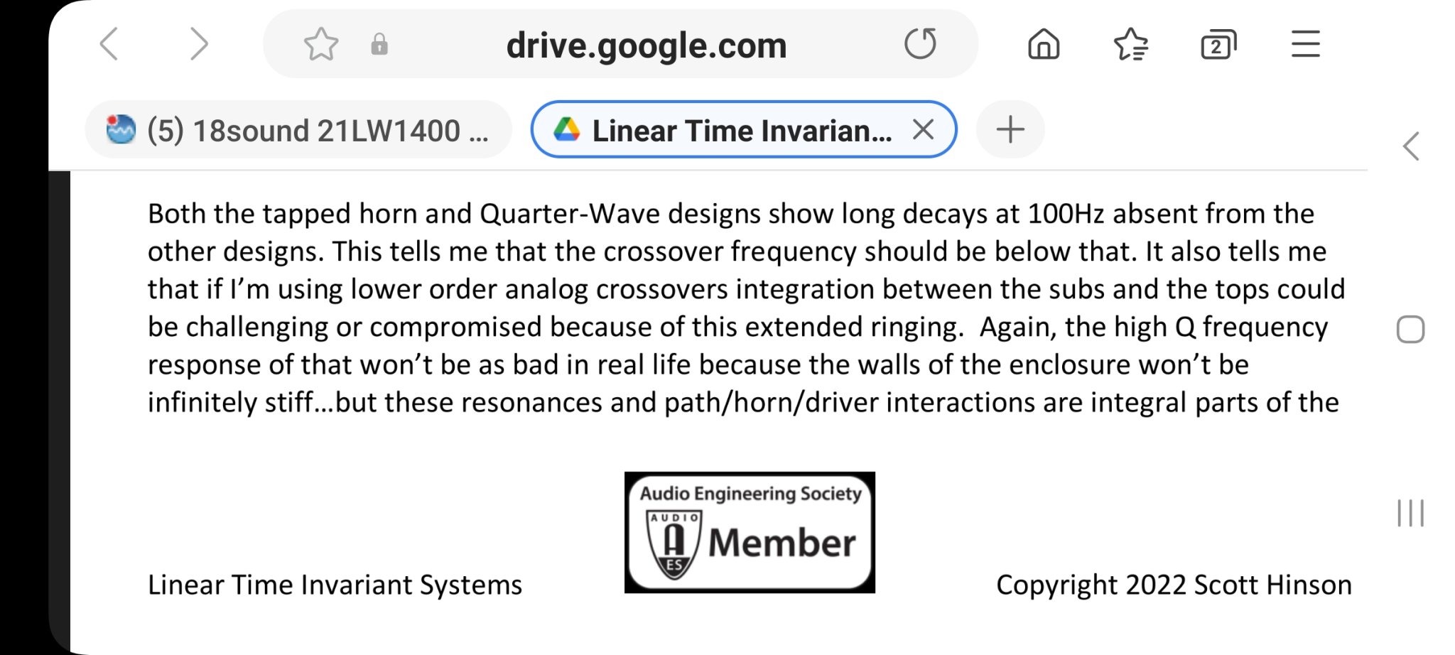

And THIS is why I could care less what happens above my low pass filter.
Interesting that he started off the paper with a 50hz high pass filter on a BP4. Them audiophiles.

There is nothing to study.
YOUR link told US to filter TH's and QW's below 100hz.

What kind of low-pass are you using? How steep and where?I try to design my enclosures to peak at 80hz so whatever happens at 90hz is a non-issue.
I ask because fi the examples in #81 are typical of the above band resonances in your builds, those take at least a 48dB/oct low pass at 90Hz or less, and could still benefit from a sharp notch around 120-125Hz.
(Some incredibly strong resonances! I'd slap a 96 dB/oct linear phase low pass at 90Hz on them.)
did you A/B compared with and without your NOTCH filter around 120-125Hz and did you hear the effect ?Some incredibly strong resonances! I'd slap a 96 dB/oct linear phase low pass at 90Hz on them.
