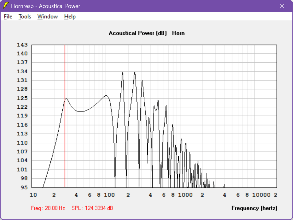

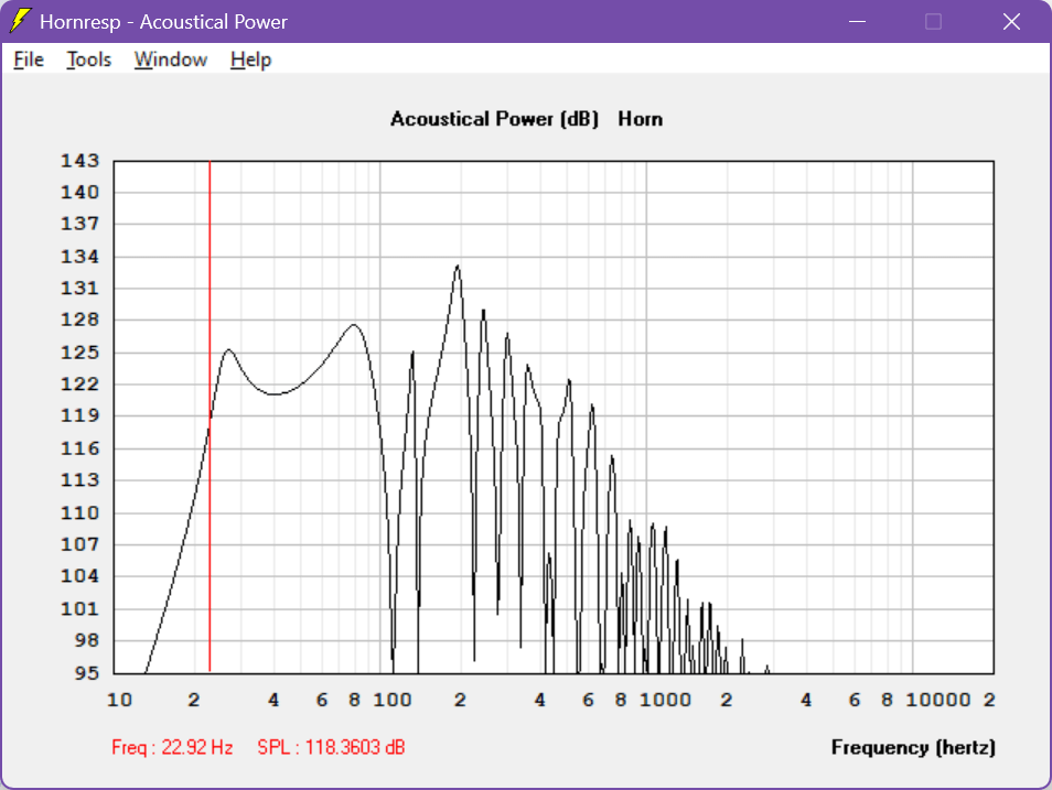

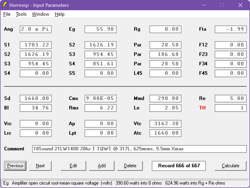

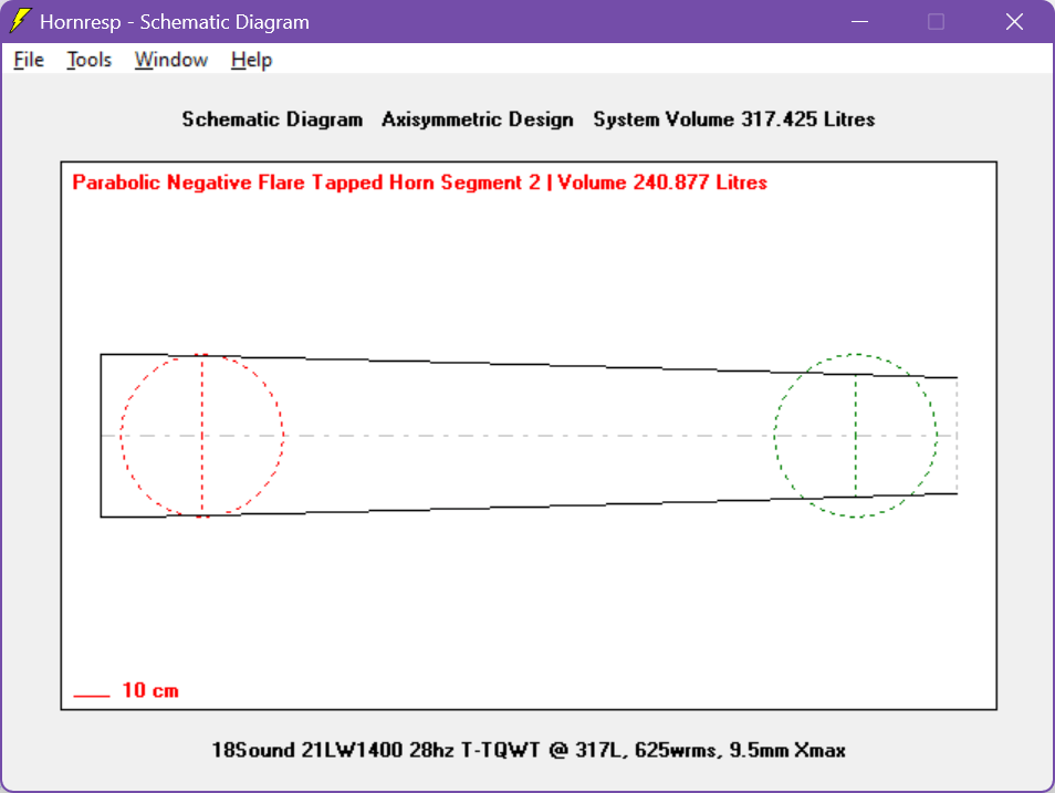

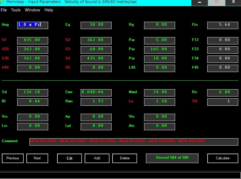

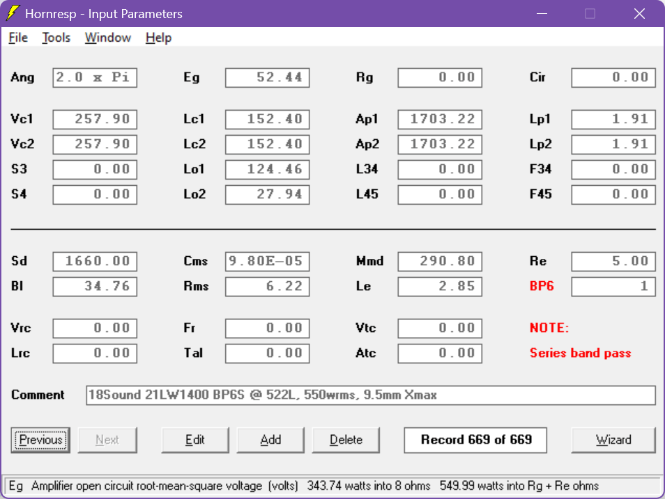

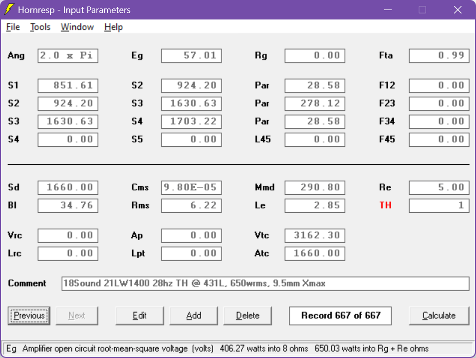

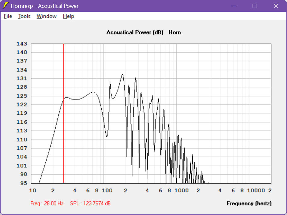

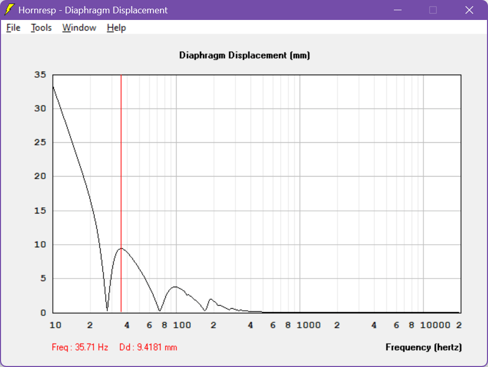

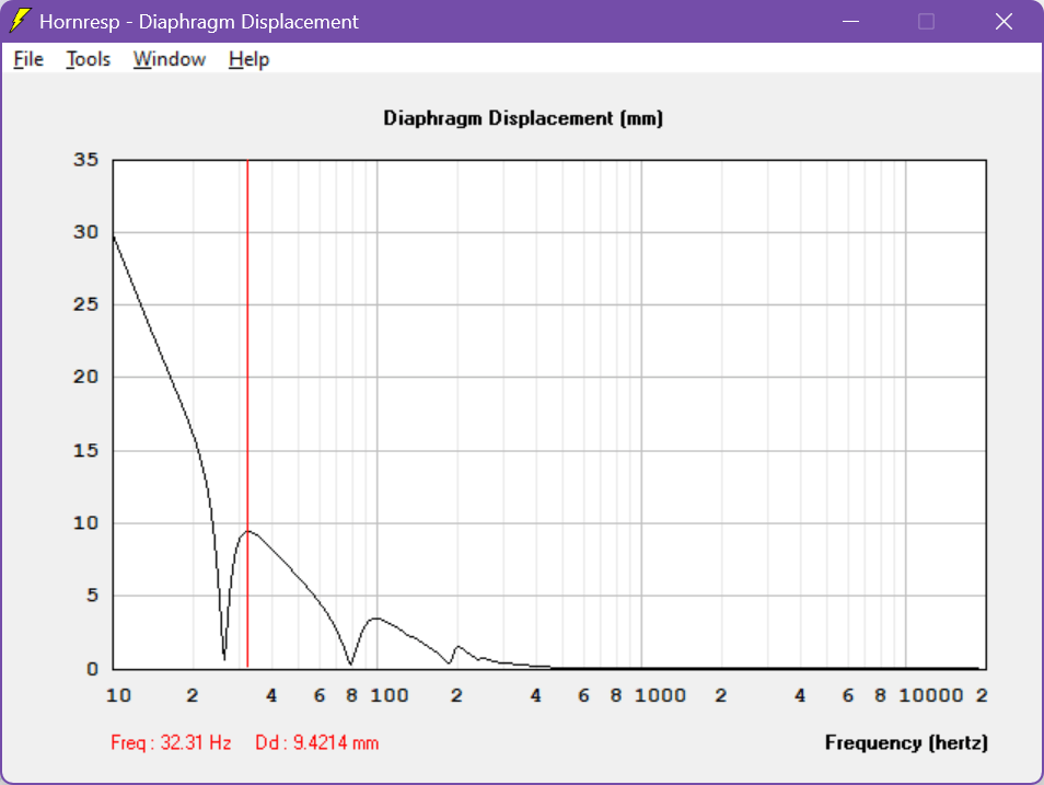

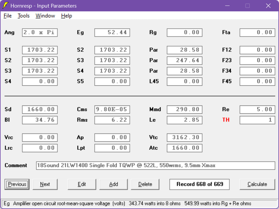

Here is a prime example.
28hz T-TQWT = 8ft horn, 317L, & 625wrms.
27hz TH = 11ft horn, 434L, & 650wrms.
All I did was flip the throat and mouth for simplicity.
Hofmann's Iron Law.

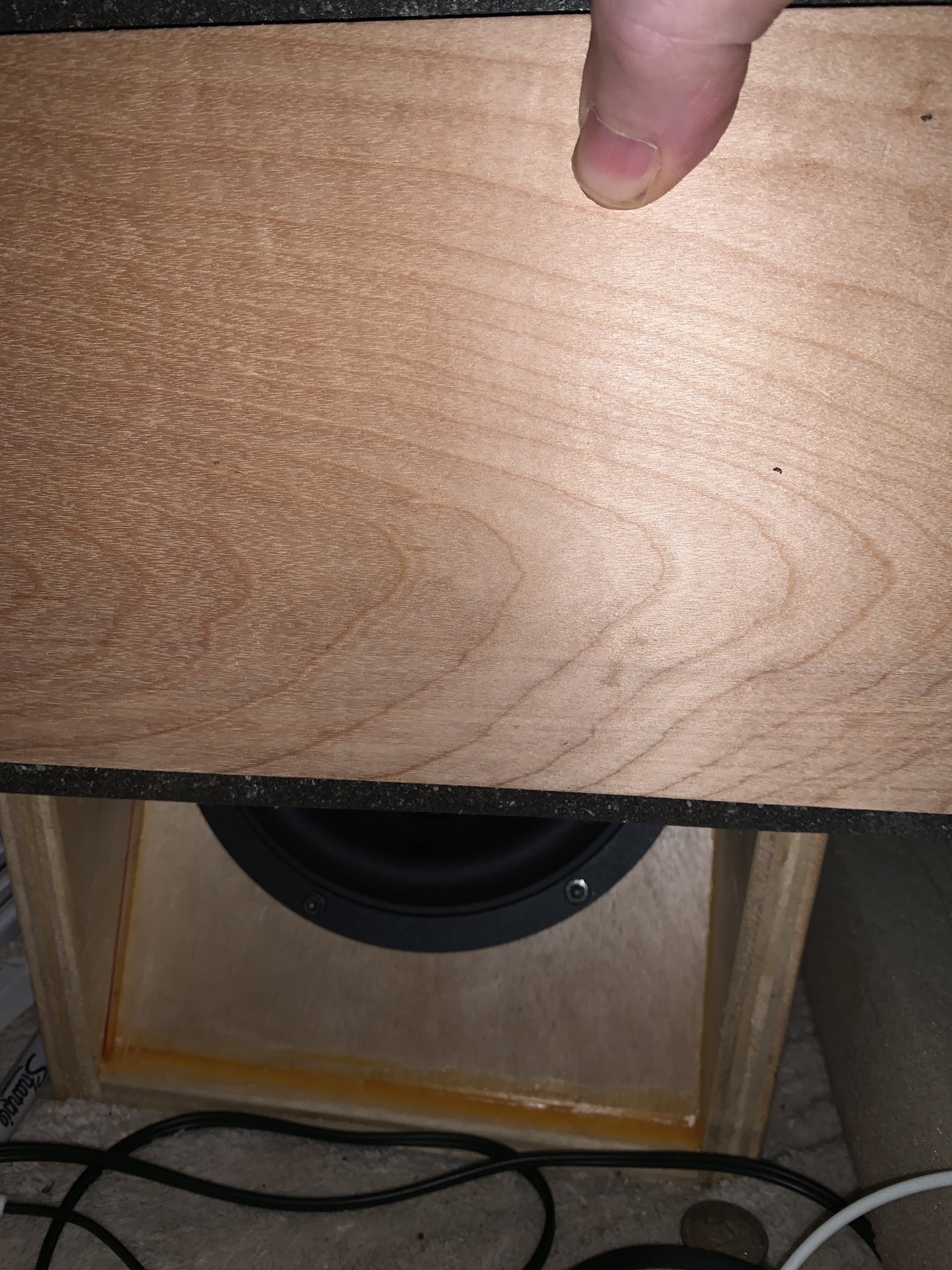

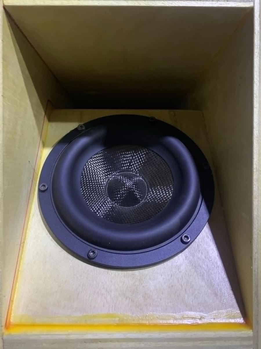

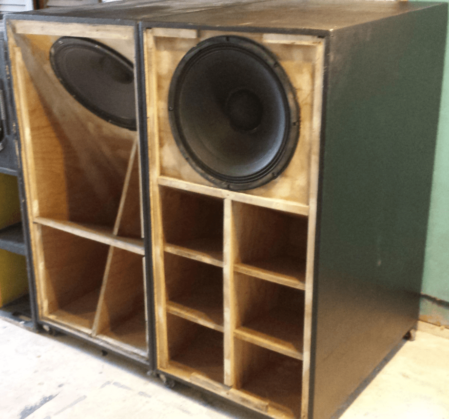

I meant the area directly in front of the driver is covered with wood instead of being exposed to the room fully?
we Both use tapered qw pipes, but you clog up your exit Unnecessarily(?) and I dont Understand why (after listening to and measuring the difference)

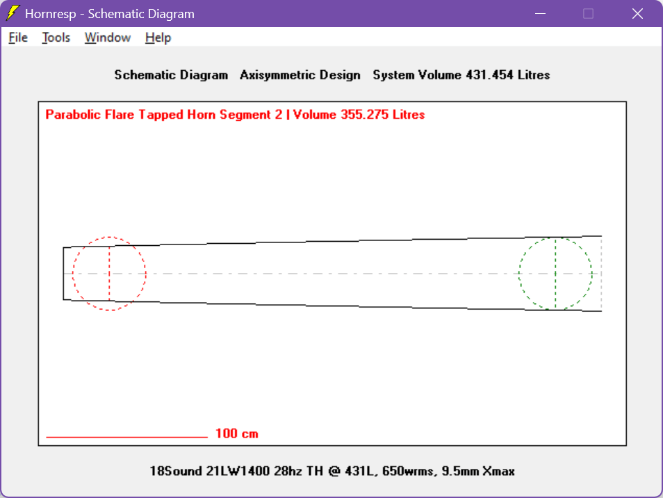

Hofmann's Iron Law.

What a great comparison! The expanding path shape filled in the saddle/saggy response shape so much better 😱
because the second resonace is quite a bit closer to the fundametal in those maybe? Or the driver is in a bit more pressure between the resonances from the skinny CSA @ start?

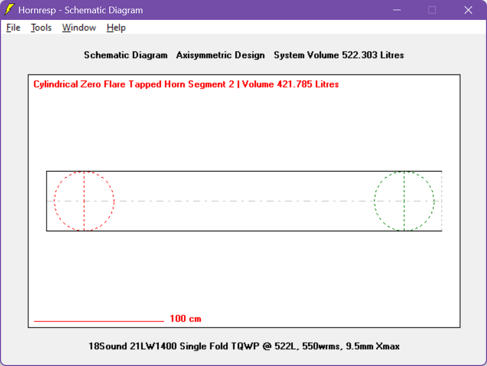

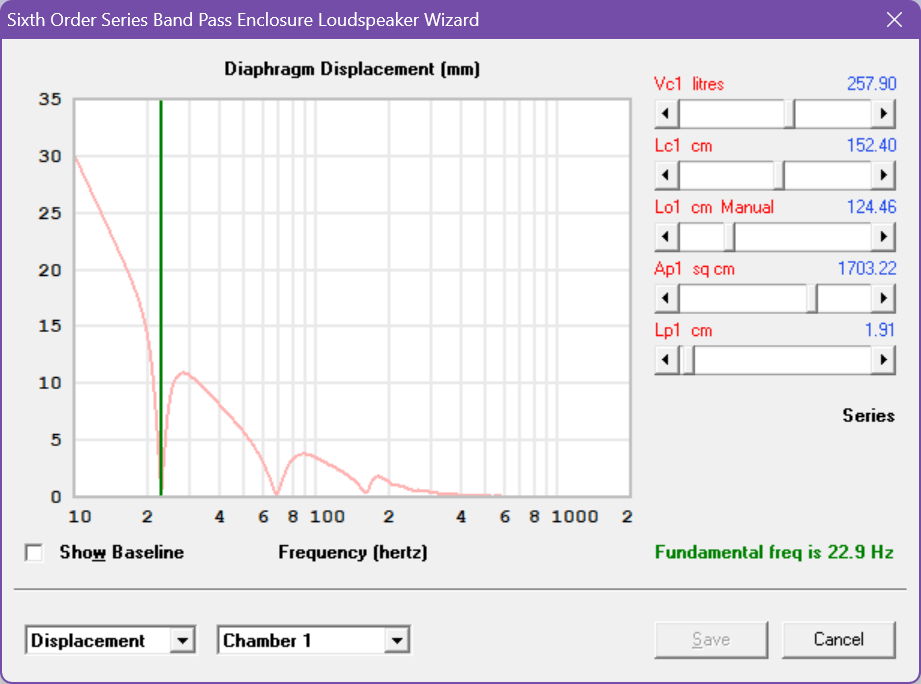

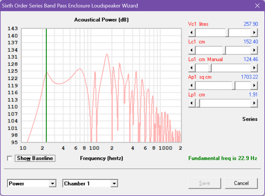

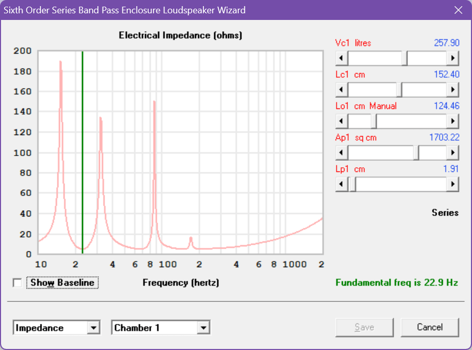

It's a BANDPASS enclosure, i. e. buried driver enclosure.
TH = BP6S where the WHOLE enclosure is a negative, straight, or positive flare port.
NORMAL BP6 (series or parallel) enclosures DO NOT have ports with the CSA of Sd.
A simple straight flare single fold TH can be modeled with either the TH or BP6S function in HR.
Reactions: Jizzy

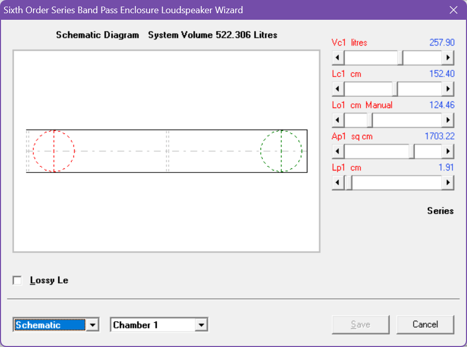

D@mn it, in the BP6S model, I should have subtracted 1.905cm from the Lc1 & Lc2 152.40cm lengths to get a 10ft total length.
That's why I was getting 522.303L vs 522.306L.
The BP6S is actually a 10'1.5" horn.
But, ya'll get the idea that they are the same enclosures.
Reactions: Jizzy
because the second resonance is quite a bit closer to the fundamental in those maybe? Or the driver is in a bit more pressure between the resonances from the skinny CSA @ start?
Thanks guy!
You'll have to ask DMB and Tom Danley those 2 questions. I'm just a basshead modeler.
Reactions: Jizzy
we Both use tapered QW pipes, but you clog up your exit Unnecessarily(?) and I don't Understand why (after listening to and measuring the difference)
The beauty of the TH, I can change the exit and the performance don't change.
I prefer MTH alternate for ease of build, driver mounting, and standing up the driver.
You can do MTH, but you might have to deal with cone sag unless lay the enclosure on its side.
Tom Danley's THSPUD provides the side exit option.
Reactions: Jizzy

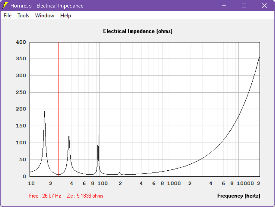

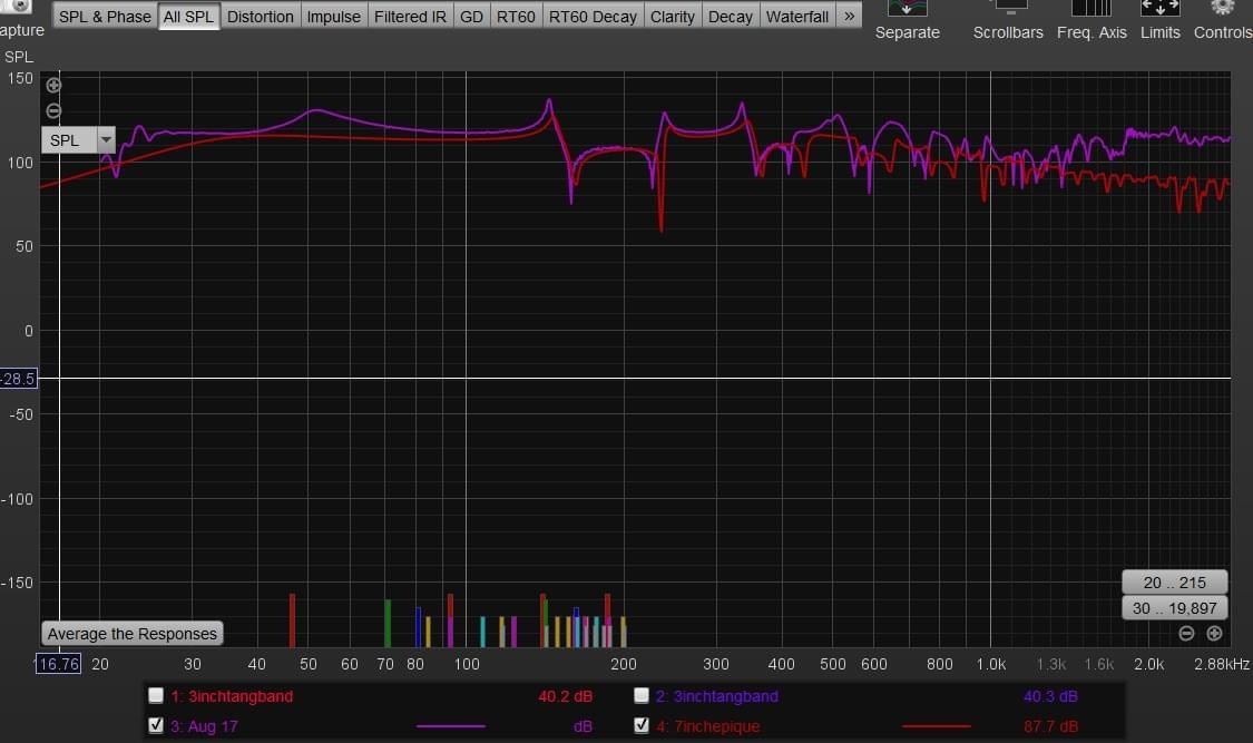

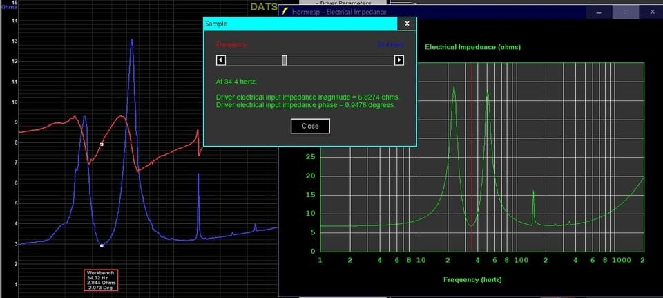

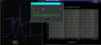

Is this a ‘bandpass’? It starts canceling out once the frequency approaches the full wavelegth of the distance between the driver entry and the vent (and other side of the driver)
Reactions: Jizzy

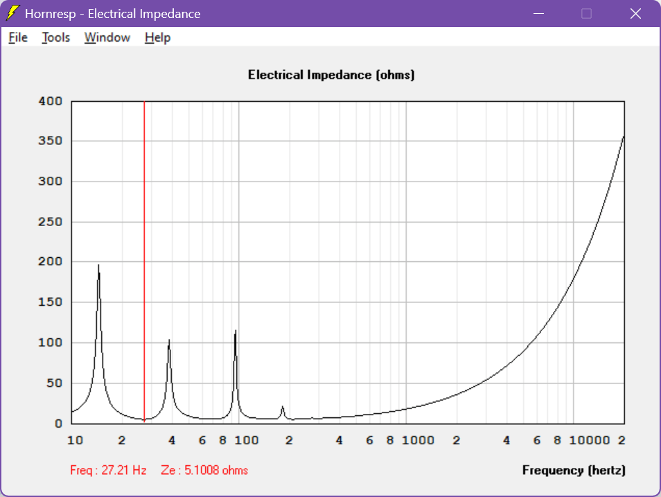

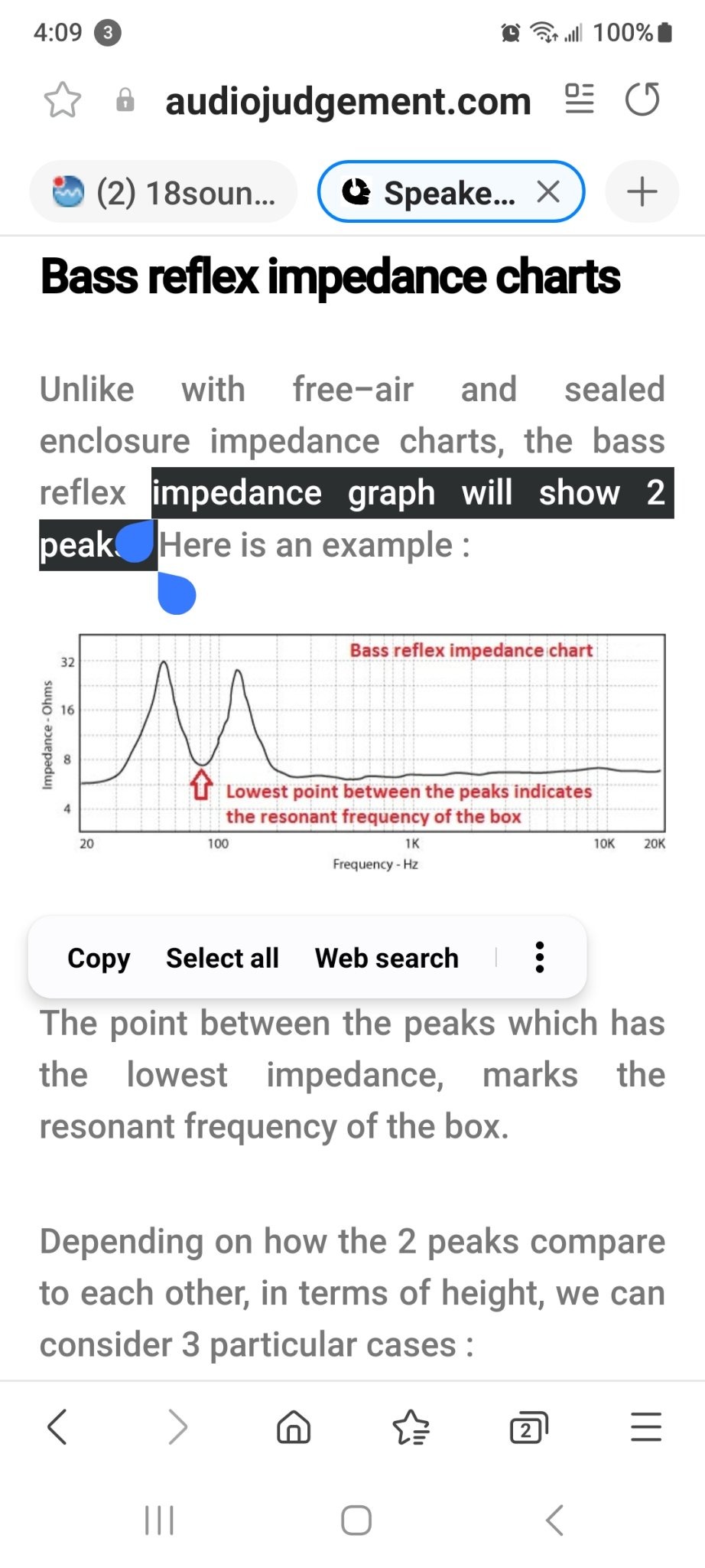

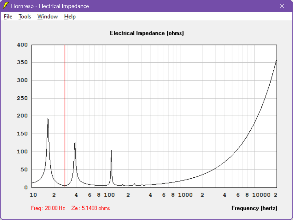

If I didn't care about physics, then I would use plain old sealed enclosures for ALL my audio.
Peaks and U's are PHYSICAL things.
You just don't like that I simplify complicated things.
Is it true that a sealed enclosure has a single peak or no U's in its impedance measurement?
Is it true that BR and BP4 enclosures have 2 peaks or 1 U in its impedance measurements?
Is it true that a BP6 enclosure has 3 peaks or 2 U's in its impedance measurement?
If the answer to those 3 questions are yes, then without PHYSICALLY seeing the enclosures, you can NAME the enclosure type...4th order, 6th order, etc.
The only stipulation to those statements is BR's and BP4's have the same type of impedance graph. You would then need to see the PHYSICAL enclosure.
Same situation with DBR's and BP6's.
Reactions: Jizzy
Why does a qw pipe have more than one resonance(1.3.5.7.9….), yet it is just a 4th order Vented ?
what makes it different than something else with more than one resonance ?
isnt it just another multiple pressure/velocity or capacitor/inductor like event ?
Reactions: Jizzy
