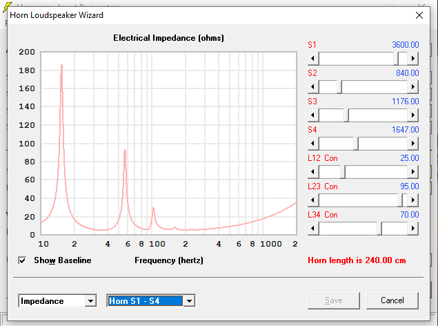

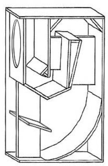

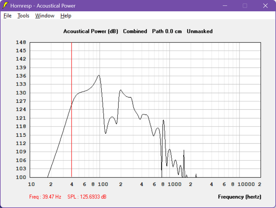

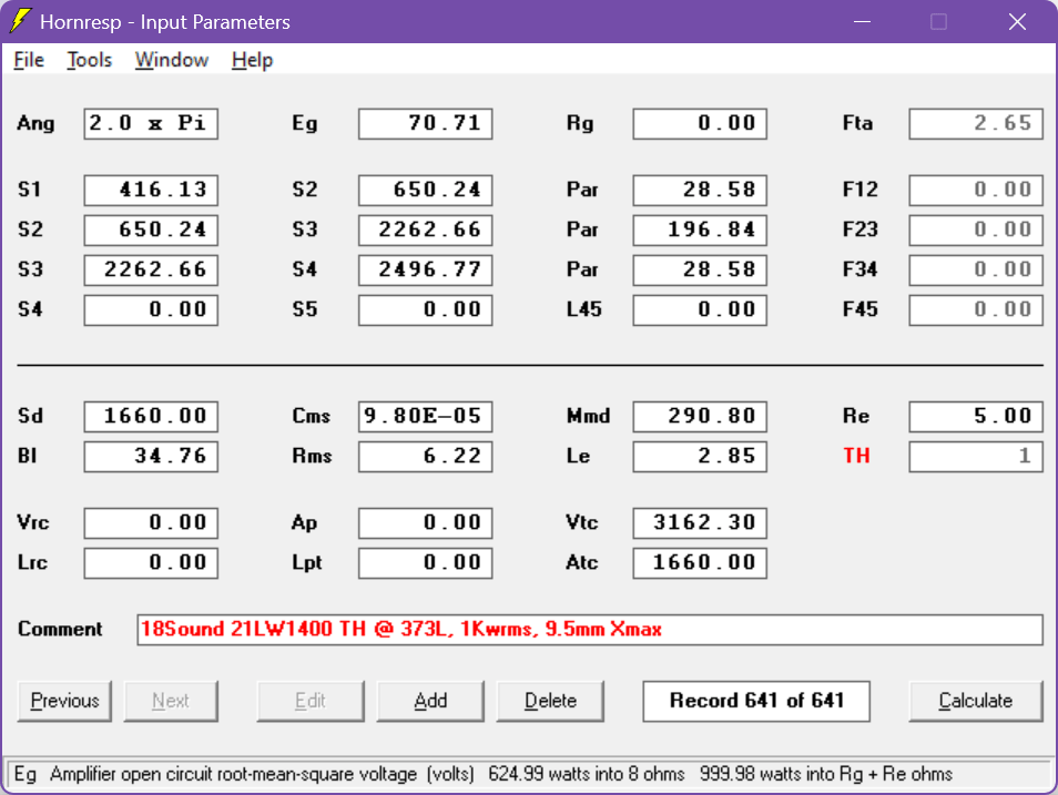

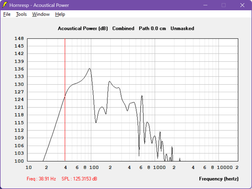

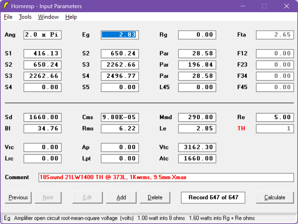

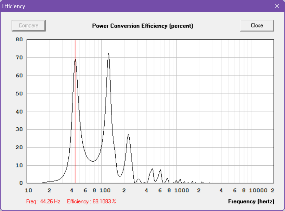

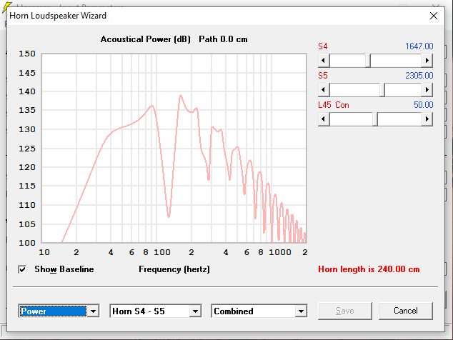

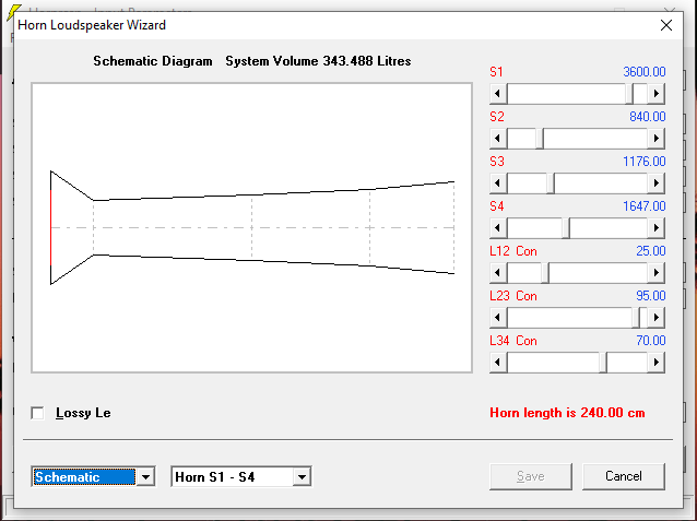

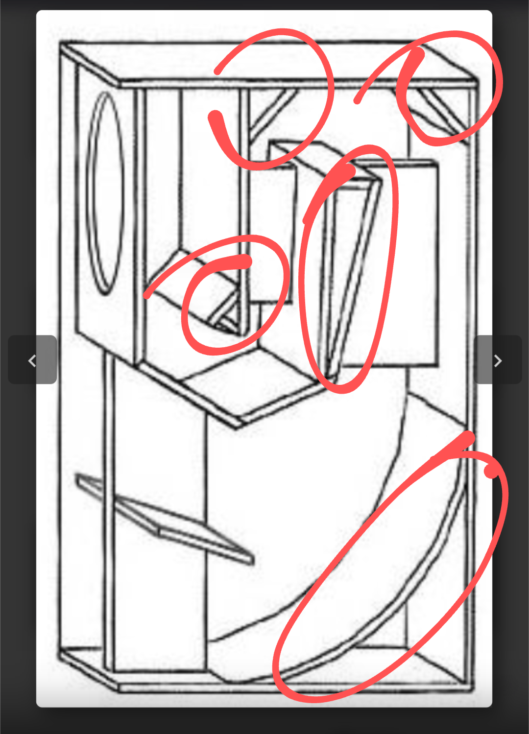

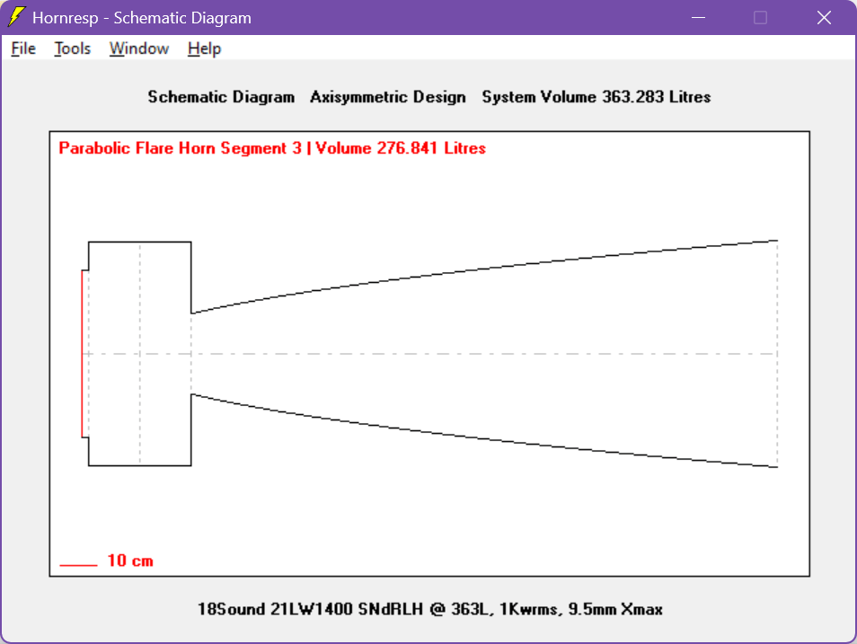

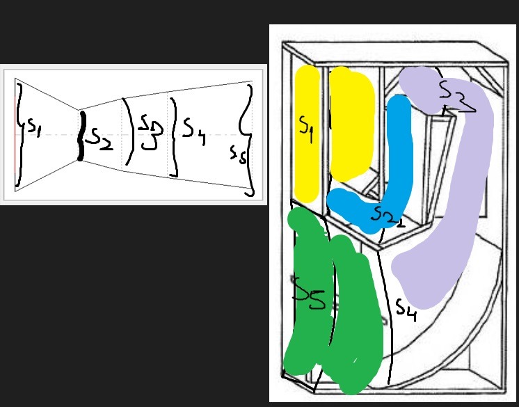

Hi! I need a little help 😀 I did some modifications to my calculations, so here are the new results. Now, i attached a photo which is the design that im thinking about to build. The problem is that i do not really know where s1 s2 s3 etc starts and where it ends. If someone may use some colors to draw on this design in order help me...

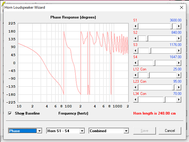

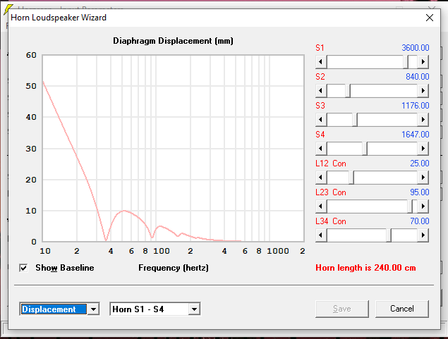

And about that phase shift, i don't know how to deal with it; i tried shortening the port but it's not worth it in my opinion
So you choose a scoop design?,but why that one? , there is wasted space in the areas shown , that kind of "drawings" are not made anymore because the not optimal use of wood.
There are so many designs already done that were built a lot.
Scoops work in groups of 4 or more just so you know.
making 2 will not work as those were designed.
If I a was you I better choose a proven design
Tested by people who actually built, tested and pulled freq sweeps with a mic.

maxolini, many people built this, i have this design too (https://www.speakerplans.eu/details.php?id=4) but idk what to say about it, idk if hog scoop is a better idea too

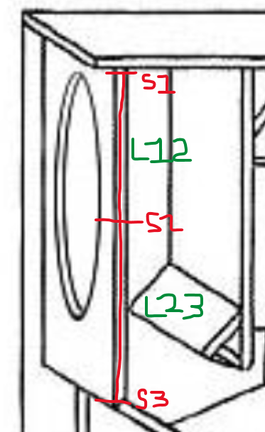

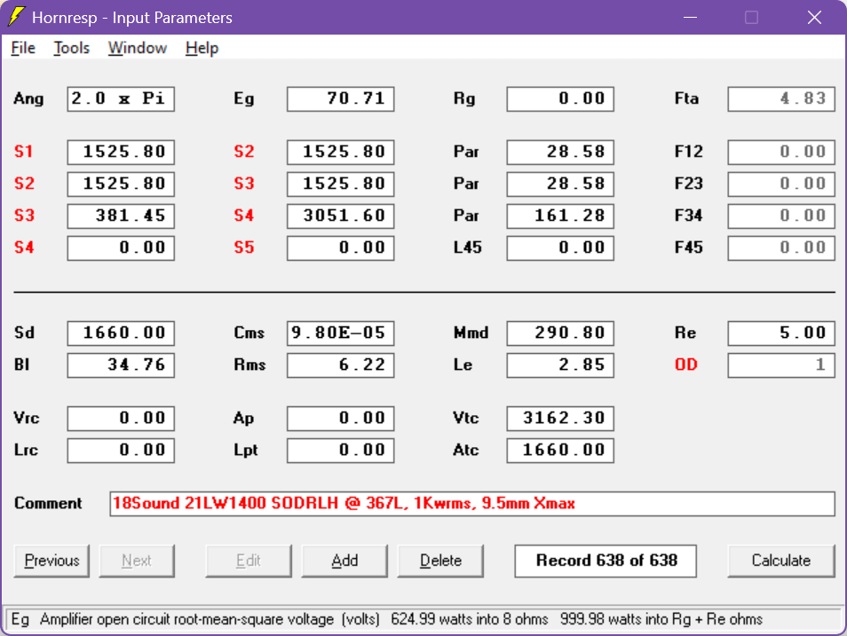

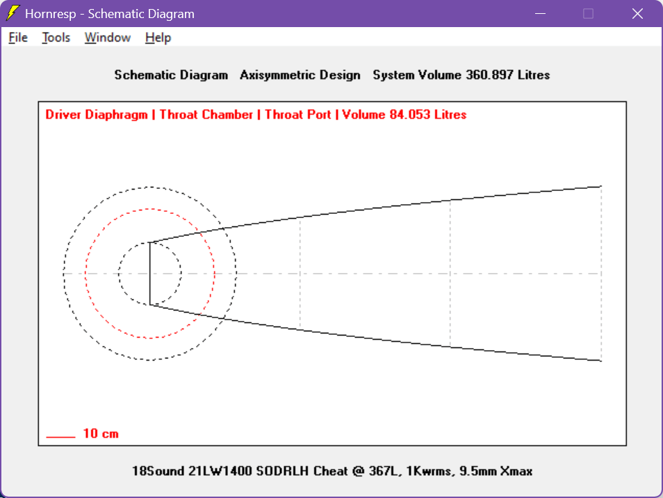

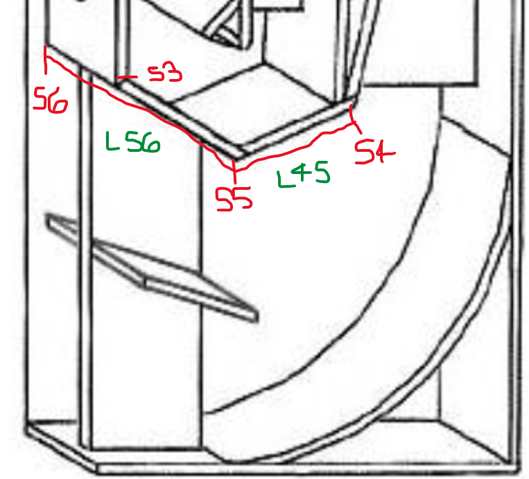

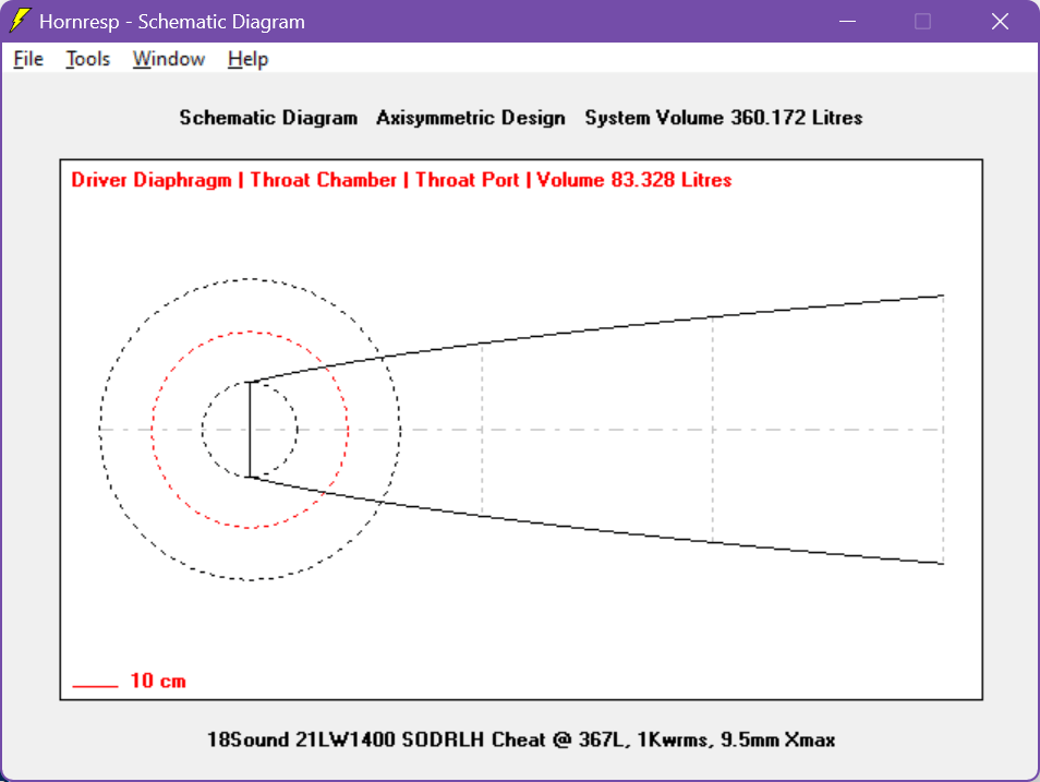

BP1Fanatic and s4, s5? Btw, this photo you posted does not make sense for me, if you can make a short explanation it would be very very helpful for me to understand the concepts better... i tought that these S are like this:

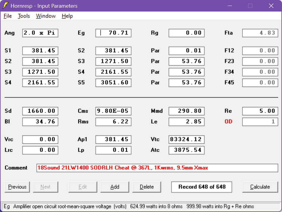

Here's the cheat.
Normal:
Cheat:
The difference in total volume is the Vtc & Ltc above. That volume = the speaker mounting panel.
Original vs Cheat:
Normal:
Cheat:
Original vs Cheat:
