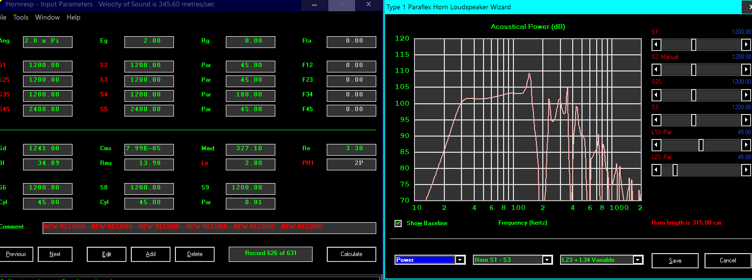

Just sim a 3:1 parallel resonator and use L45 to approximate the exit section . There’s nothing too complicated about that design that horn response won’t easily come up with a reasonable simulation even whilst ignoring the slight differences in actual path connections into that last section
HR can't sim well paraflex designs , as far as I know , those designs truly were refined the old fashion way before computers , doing prototypes ... measure...prototype ..measure ....wash .rinse..repeat
I thought the PH functions were specifically designed for Paraflex enclosures?
You can also use the BP8P function to model a Paraflex as long as there are no angles.
This is very strange, as whoever created it didn’t seem to understand what s2 (and s7) are describing in regards to driver position or centerline on the actual cone if stuck at the high pressure ends of these pipes.
but maybe they didn’t care because the distance is so short and high frequency that it doesn’t even affect the bandwidth area ? Their just dumping info into the sim at random and crossing their fingers?
with the TYPE O plan, is it possible to put the info on the HR screen , thing is that somebody who have one cabinet loaded with a driver need to measure and then we can compare, doing it just from the HR side will not tell us nothing until a physical cab can be measured and compared.
How come the bottom input sections are CON when the top input sections are PAR?
