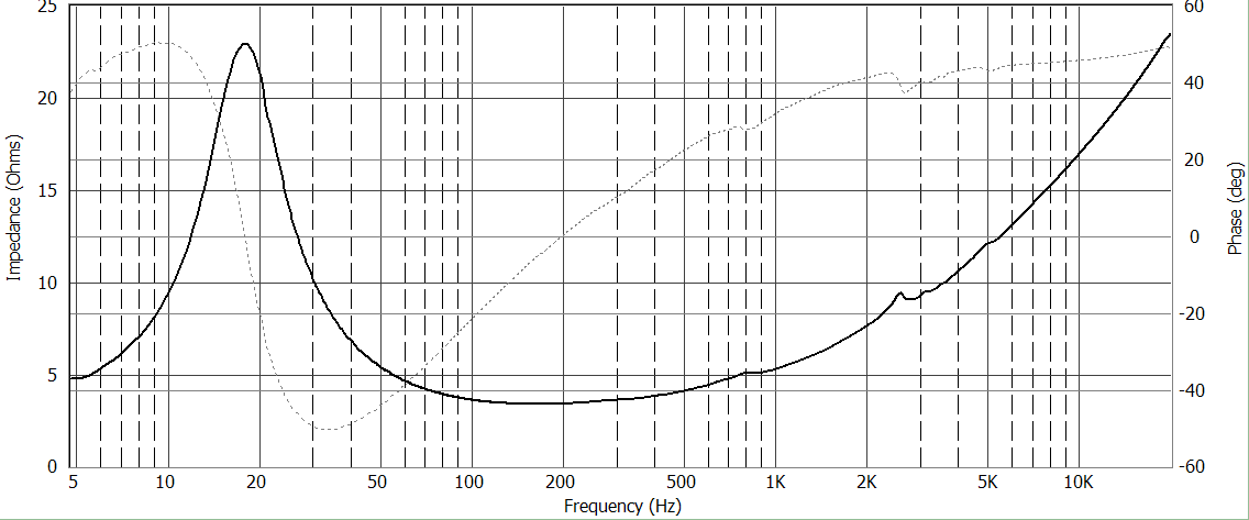

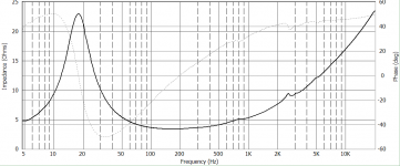

my choice for many many projects that need a larger woofer is since 2006 is the following driver:
nominal impedance 4 Ohm
(IEC 268-5) power handling 70 VA
AVG. Spl 93 dBL
linear excursion ±2,5
mechanical excursion ±6,0
Re 3,0 Ohm
B*l 8,248
Sd 510 cm^2
Cms 1,382
Mms 57,749 g
Rms 3,369
Fs 17,813 Hz
Vas 510,644 L
Qms 1,918
Qes 0,285
Qts 0,248
The price is around 26 euro.
This is a reply actualy for the first few posts, there is no problem with cheapoo drivers, till you know what to look for, and purchase the "right stuff".
I made back to back isobaric subbox for car use using this driver.
And made a few HT subs too, allso is part of at least 3 pairs of 3 way systems i made over the years.
Actualy as a back to back isobaric this thing is quite space-and cost efficient.
I consider it to be in the top 10 12" bass units i would ever purchase.
Moving mass could be less, might not do so well for guitars i never did attempt it.
It covers quite well till 2Khz, but using this driver higher than 1 or maybe 1.5 Khz is not realy advised by me.

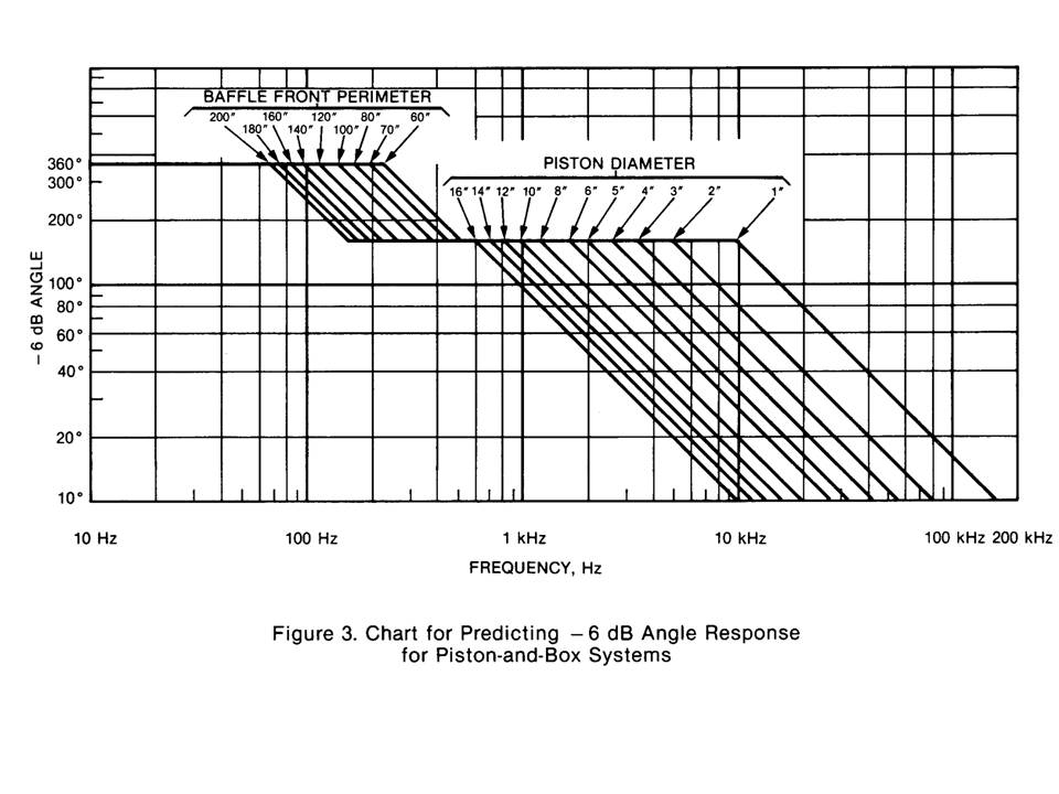

I found a chart indicating power response as a function of driver diameter in a thread in another forum.
B200 a bit shouty
Scroll down to the middle of the page for the chart.
If you cross over above 500 Hz, your drivers will be increasingly directional. At 2 kHz, the driver will be 6 db down around 40 degrees off axis. Good luck with that crossover
You need to address the issues of a compression driver operating below 1 kHz, or you need to go 3 way. Or you can put on your rose colored glasses and produce scrap.
Your choice.
B200 a bit shouty
Your choice.
I attached the drivers mesurement graphs.
(edit * for some reason only 1 pic shows up in attachments, i'm linking the otherone right now.
diyAudio
The 17 hz resonance is for real.
I can only agree, region of 20-30 Hz IS important, only problem when doing a speaker design is room gain. If You tune even this cheapoo "communist leftover" driver too low, and the room gain kicks in, it will sound wobbly/goofy.
My usual xover point for this driver in 3 way setups is less than 300 hz.
Verrrrry expensive to make a passive xover for this unit, as You can see the impedance curve demands compensation.
Other than that, in this price range I bet it will be hard to show anything that can come near to its potential.
On must not attempt to do a DIY speaker with the approach of getting the most expensive midbass as a start as he/she can pay for.
Simply not worth it.
I think a better solution is to clarify design goals, and seek a driver that can do the job right. Once found, ask around from others whom had the luck to use the selected driver(s), then decide what to do.
Btw, for 2 way systems a 40hz -3 dBL point is not a bad start.
diyAudio
B200 a bit shouty
Your choice.
Hi DougL
I looked at the graph you linked to, I normaly read charts just fine, but...
If I have a 1" tweeter, tweeting at 10K Hz, the chart indicates a 6dB point at 180 deg.
That makes no sense to me at all, at 180 deg. it must be way more down than that surely ?
Also the piston size bit seems to read X Y + find result, but I can't for the life of me figure out what your supposed to do with, or workout from the baffle perimeter bit ?
Anyone got any idea ?
I would not think myself that 6dB at 40 deg. is too much of an issue personaly, but maybe thats just me ?
Simon
(oh...is it a nomograph type thing)
