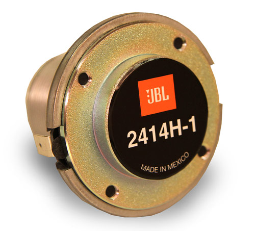

have you seen the 2414H measurements that I posted some pages ago?
This driver is difficult to filter and eq passively, and cannot be crossed lower than ~2khz, even on a big horn.
Hi pos
No I haven't seen your 2414H measurements, where are they ?
It seems that as the 2414H is only available for bespoke JBL products as a spare & is not generaly sold, there apears not to be a datasheet on it.
Not that I can find, any way.
Do you have a 2414H data sheet ?
I would like to use X over @ 2K ish.
The JBL - AC26 installation speakers HF end useing this compression driver sound suuuuuuuperb.
Guide me to your measurements pos.

link: 2414h
thoses measurement are made on the same waveguide as the AC16/AC26 speaker.
you need to compensate for the driver rolloff (on a constant directivity horn at least) *and* apply some notch filters.
in comparison the 2407 is much easier to filter/eq, and can be used lower

I totaly missed the tiny link on page 4.
Mmmmm...
Yes when I saw the AC26 cross over I was even keener to see some full data on the driver.
Also concerned about the size, after hearing Godzilla blew 2 of them.
Thanks very much for the measurements.
It really looks like trouble.
I did wonder, if they were that great & easy to use, why JBL only supply them as a spare, and provide no data.
You have solved the puzzle.
You said you used the waveguide from an AC16, was it 90 x 90 ? as I was under the impression the JBL part# for the AC16 waveguide is PT-B99HF-1.
The JBL CD is not as easy for me to get as the Celestion brand is, and the Celestion data on the CDX1-1745 indicates a 'normal' response, and weighing in at over 2Kg seems to have a bit of inbuilt cooling potential !
Cheers
Simon

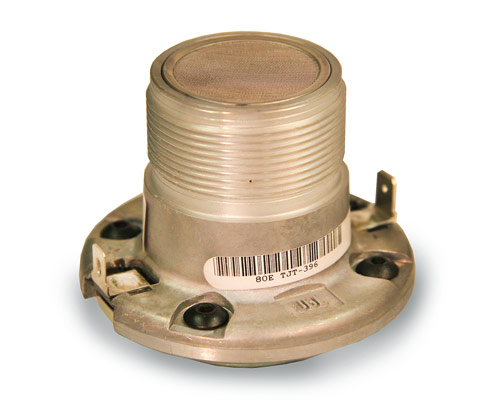

P.S. It seems a bit strange that JBL should apparently manufacture the same component in two different locations (Mexico & the USA as indicated by the stickers on the body).
The photos of the CD here, came from a USA web site 'claiming' to be selling 'genuine' JBL parts.
I was unable to find any photos of the CD on the official JBL pro spares site.

Those inductors are there for a reason:
link: 2414h

Nothing JBL is manufactured in the US now, it is all mexico or china.
I doubt the 2414 or 2414-1 was ever produced in the US.
The 2407 is a BMS 4540nd, manufactured buy BMS without much modification.
The waveguide in the AC16 and AC26 is the PT-B99HF-1 indeed.
Maybe you should look for the bigger brother, the PT-F95

PS: Somewhere I have heard that JBL licensed some compression drivers from BMS.
Don't know if true but if it is could the 2414 be one of them?
Yes.
The JBL 2407H is the licensed version of BMS 4540ND

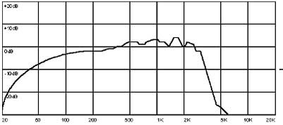

'The Versatile' - 18" Driver Update - Design Considerations - Part 1
Although the Eminence Sigma Pro 18A-2 seems to tick all the right boxes (at least on paper).
It would be nice to find some credible alternatives to consider.
Obviously there are 'dozens' of manufacturers, making 'dozens' of 18" drivers.
Power handling, to me at least, is not an issue for 'the versatile' loudspeaker.
If I am able to feed the speaker 100 Watts of good clean power, I will be a happy bunny.
This means any guitar or bass amp, any 'Hi-Fi' tube amp or SS amp, and the vast majority of studio monitor & PA amps commonly in use would all be usable.
Indeed the lowest published spec. for 18" power handling I can find is 300 Watts.
Power handling considerations in fact, ensure that 95% of the available 18" drivers out there, can be rejected straight away with little further thought.

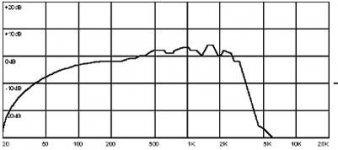

Here's some numbers:-
Freq 25 Hz - 2.5K Hz
Reso 31 Hz (bit high...sigh...)
Mms 176 grams
Magnet 8 Kg
Total weight 10 Kg
Power 300 Watts
Voice coil 3"
Chassis - Pressed steel
Max excursion before dammage - 25 mm !!!
Volt quote -3 dB @ 35 Hz in a 200 Litre bass reflex enclosure.
