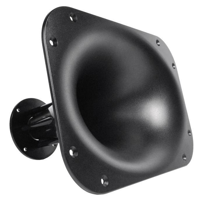

I've been looking at the photos of waveguides you've been posting. Size is not easy to see. 18" woofer.
At what frequency do you plan to cross these?
Hi again AllenB
Yes I've been looking at a few different waveguides.
I would like if possible to use the JBL PT-B99HF-1 90*x90* waveguide.
I have also considered the much larger Dayton 12" waveguide, although it's hard for me to get this in the UK (would have to import it from the USA).
I would like to crossover somewhere between 1 & 2K Hz.
I have also been looking at different compression drivers, both 1" & 2".
I would like to use a 1" compression driver with a plastic element if possible.
Also I have noticed in the frequency plot for the Eminence Sigma Pro 18A-2 there is a hump in the response between 1 & 2K Hz.
The Precision Devices PD186 doesn't have this, and seems to be more flat in this area. It also has a lower resonance and more low end output by the looks of things. So I am thinking to maybe use the PD186.
I am going to check out a few more drivers as well.

This one looks interesting.
'Faital Pro' - LTH 142
360mm x 240mm x 233mm deep
Horz 60 deg Vert 50 deg
1.4" Throat
Frequency down to 500 Hz
Recomended crossover @ 800 Hz

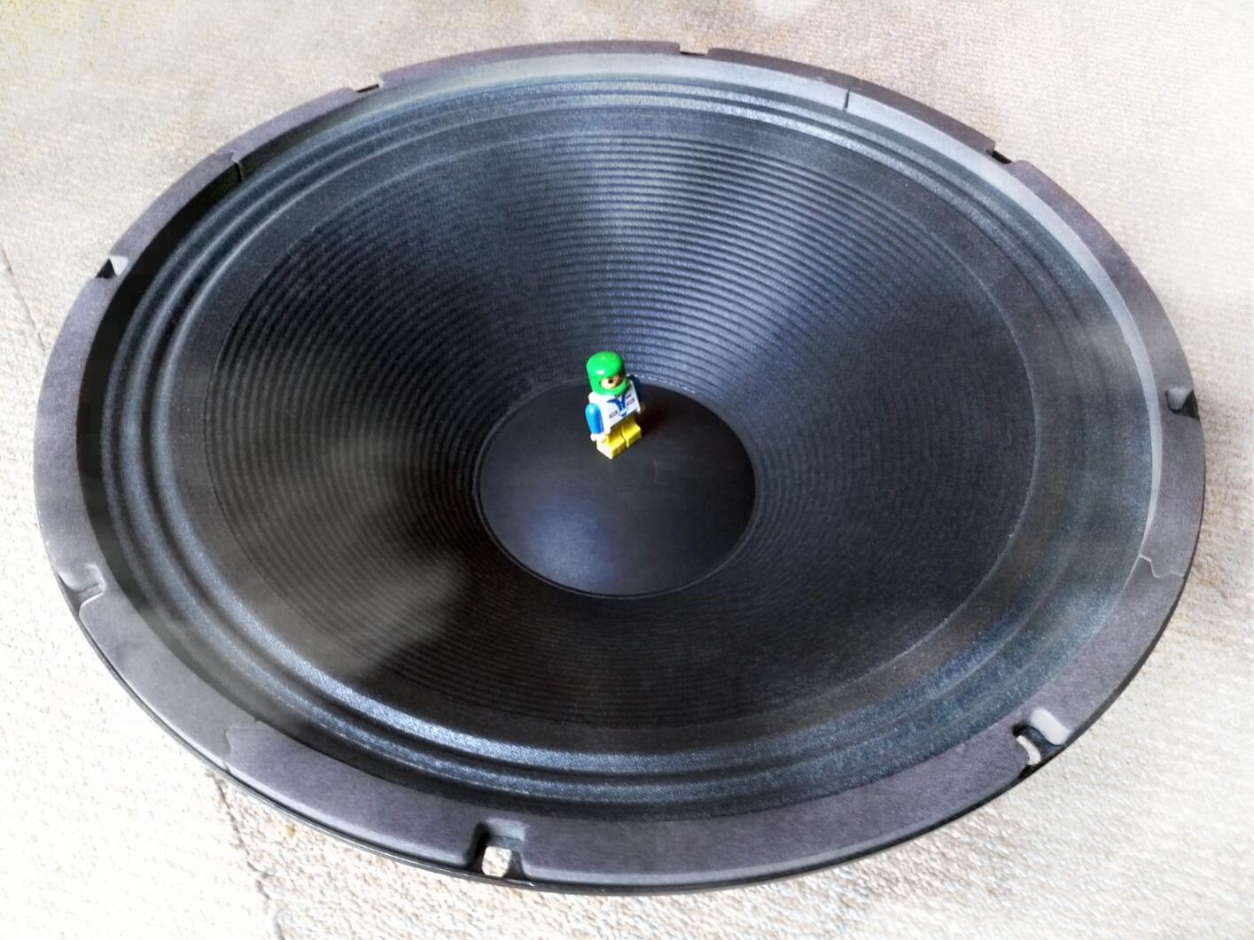

Oh ... nearly forgot ... the driver is an 'Eminence' Beta-15 ! :p
Who wooda thunked it . . . :rolleyes:

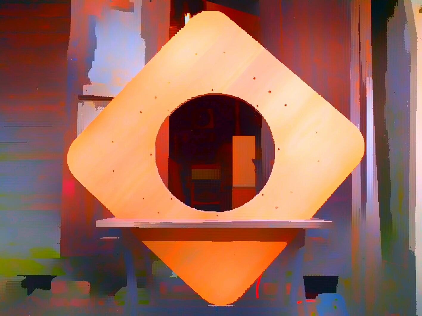

attachment.php
Kinda jumping ahead a bit ...
... but this is the baffle (ing?) bit of the new MIGHTY CAB ! :eek:
Si. :)
t.S.E.c

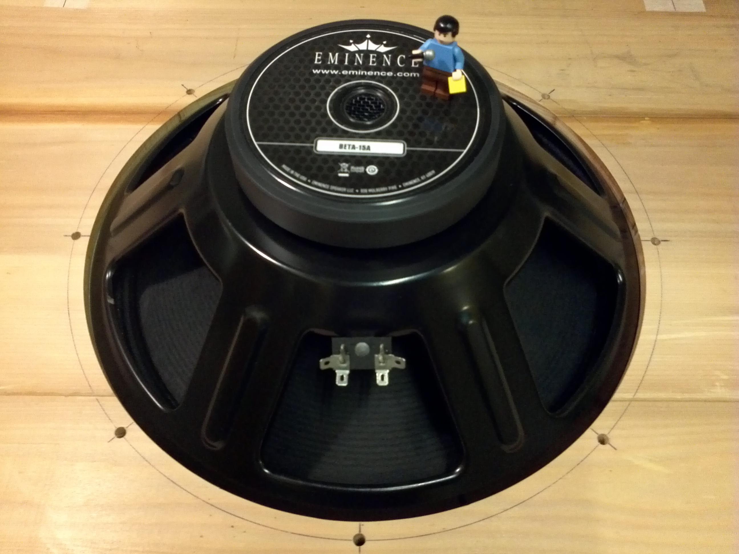

More messing about with MIGHTY CABS !
After all the umming & arring about different drivers & various design ideas ... :rolleyes:
... once I had decided to take a pretty well aimed shot at the Eminence Beta-15 ... :skull:
... things progressed fairly quickly onto the final design & construction of the cab. :D
attachment.php
It's been a while since snapping construction photos & I don't recall which bits were made in what order ! ? :confused:
But at some point we had to make the hole. :eek:
I always like that part the most ...
... then you can check out your C :cool: :cool: L new driver properly ! ;)
Perhaps even give it a whirl with some nice '70s synth OST music by John Carpenter. :eek:
N I C E ! :lickface:
