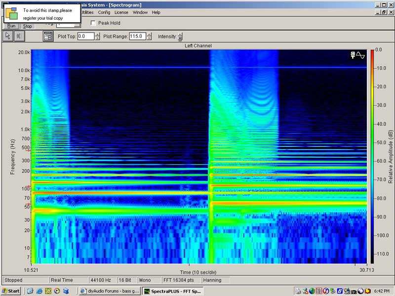

Hey S.E.C. If you have a way to directly record your bass to a computer, I'd be glad to look at each string or note for you in spectrum analysis. I'd learn something, and maybe other folks would, too. Would be fun to see the fundamental and harmonics of each string.
Does the amp head have a direct out? Most bass heads do.
30.868 Hz, 41.203 Hz, 55 Hz, 73.416 Hz, 97.999 Hz Test Tones !
Hi Pano
I'll mail you a C90 cassette straight away.
Just kidding !
You could cause me major embarisment you realise, if my tunings out !
No seriously though, yes I do have quite a few ways to record the bass.
I'm just trying to think which would be most suitable.
My guitar amp is a gorgeous 'blood & custard' 1958 Selmer Truevoice, but unfortunatly is gathering dust in a south London studio at the moment (nice dirty signal path & no polypropylene caps in that).
Here at the moment I have a 'Tech 21 NYC Sans Amp Tri.A.C.' FET preamp, which I like very much.
Also a few other Hi Z inputs to choose from.
I'm guessing one single pick up from the bass, through super clean FET preamp, as direct to digital as possible would be best.
Treat the bass as a mechanical analogue test tone generator, 5 clean twangs, with as much, and longest sustain possible on each.
Hi Pano
Just kidding !
The other interesting question is, should I mute the 4 unused strings each time, as especialy when you hit the low B zero, and with the other strings as well, the rest are moving in sympathy whether plucked/picked or not. Quite a confusing and messy waveform no doubt.
I'll probably do it to the Yamaha PAW, or Tascam SS recorder.
What's your favorite sample rate ?
Cheers
Simon

Hey Space Egg.
Using a direct input to a sound card can work, for example my M-Audio USB cards will take a guitar input. Or run it thru the amp head and then use the direct out to the sound card. Set the tone controls flat, if you do.
48Khz or 44.1Khz, (mono) either will be fine. Wave, Flac, APE or high bitrate MP3 will be fine. No C-90s excepted at the moment.
Good question about muting the other strings. I don't know. Maybe do a sample of both? In normal play they are not damped, right? I played stand up bass years ago, but don't remember much about it.
Yes, I will certainly publish the results here.
Here is one someone else did (no accreditation as I don't remember who it was). I had about 2 dozen basses at the time and mine were not dissimilar though they did vary between brand, model and construction. I can't find where I kept the files if I did at all. LHS is E, B will be worse.
