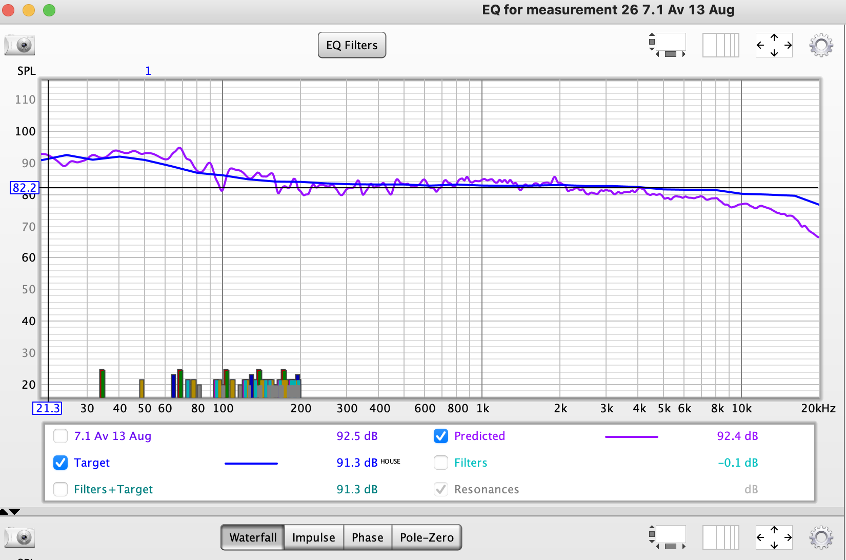

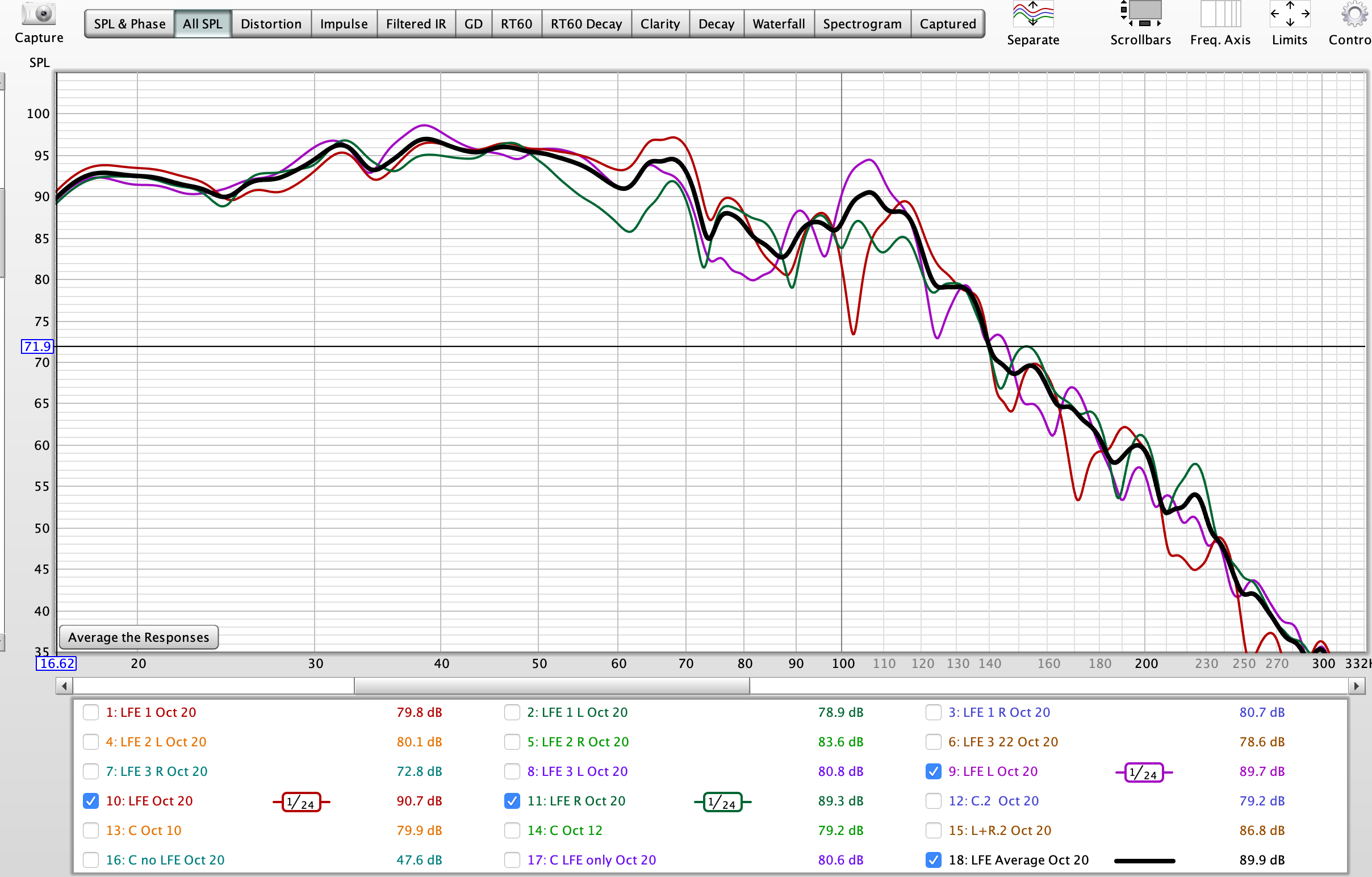

Here is the plot of my current output using the average of each channel in a 7.3.0 set up (I have manually followed a Harmon curve and only EQ the subs). The subs are three Sonus Faber Cremona which are 12” with 2 passive radiator units quite heavy - 36kg and not much output below 18HZ, I have EQd and time aligned and the bass from 30Hz up I have plenty of headroom (I use all the speakers full range and add in any bass shortfall with a 10x10 mini dsp) I have also loaded the subs shown across a 2m wide seating position as well, this was taken 12m ago and I have flattened a bit further since
It’s the recognition that a 4th sub placed in the front left corner could be easily fitted and the REW simulation supports a good response around 20Hz plus it smooths my 25 Hz null. I have managed to get the three subs to provide a very consistent response across the seating area, so hopefully I can rework the same methodology with 4 subs

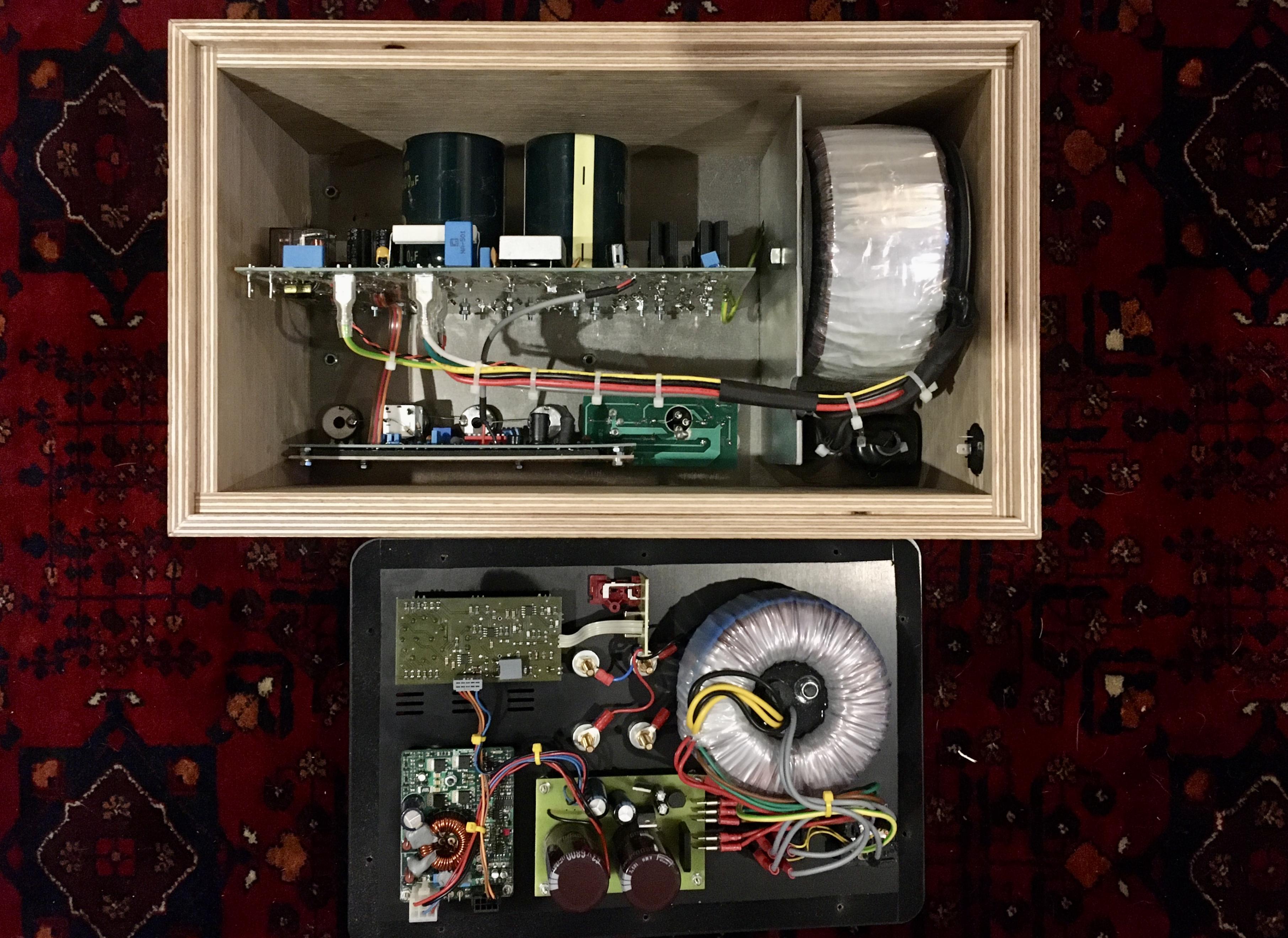

I also want to use my spare BK amp “only 500W with 1000w peaks” it does have a meaty power supply and it was a notable upgrade when I bypassed the existing plate amps in the Cremonas, pic below of the difference and the BK amp in ints separate box from underneath BSBPV500

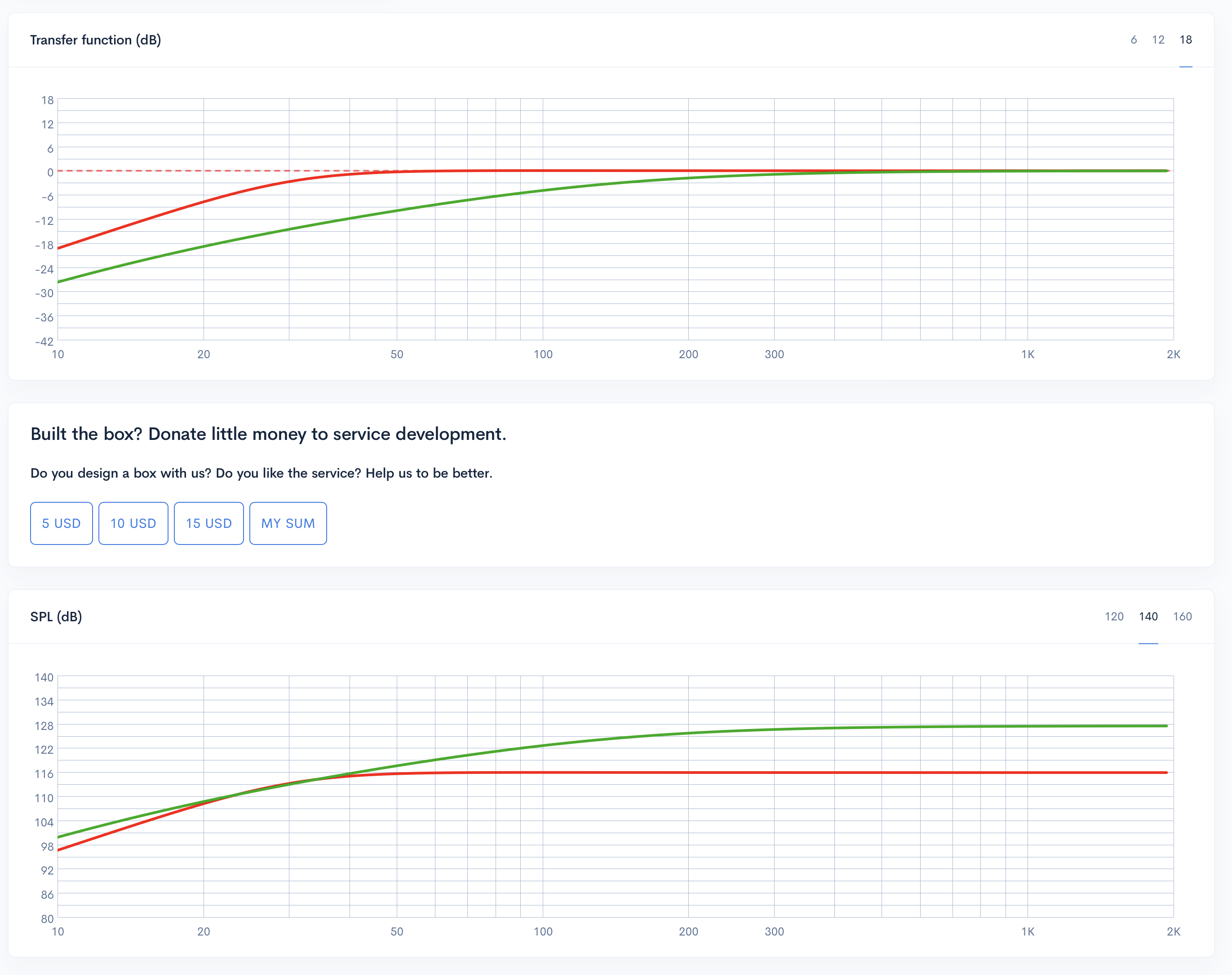

Looking at the Dayton vs the B&C in an approximate enclosure size measuring I have decided longer could work so using external 700x520x520 which give an internal volume of 147 litres
These are the curves looking at the two, because of efficiency the B&C and how it might look with EQ it might work better ? B&C Green 95-98db, Dayton red 86db

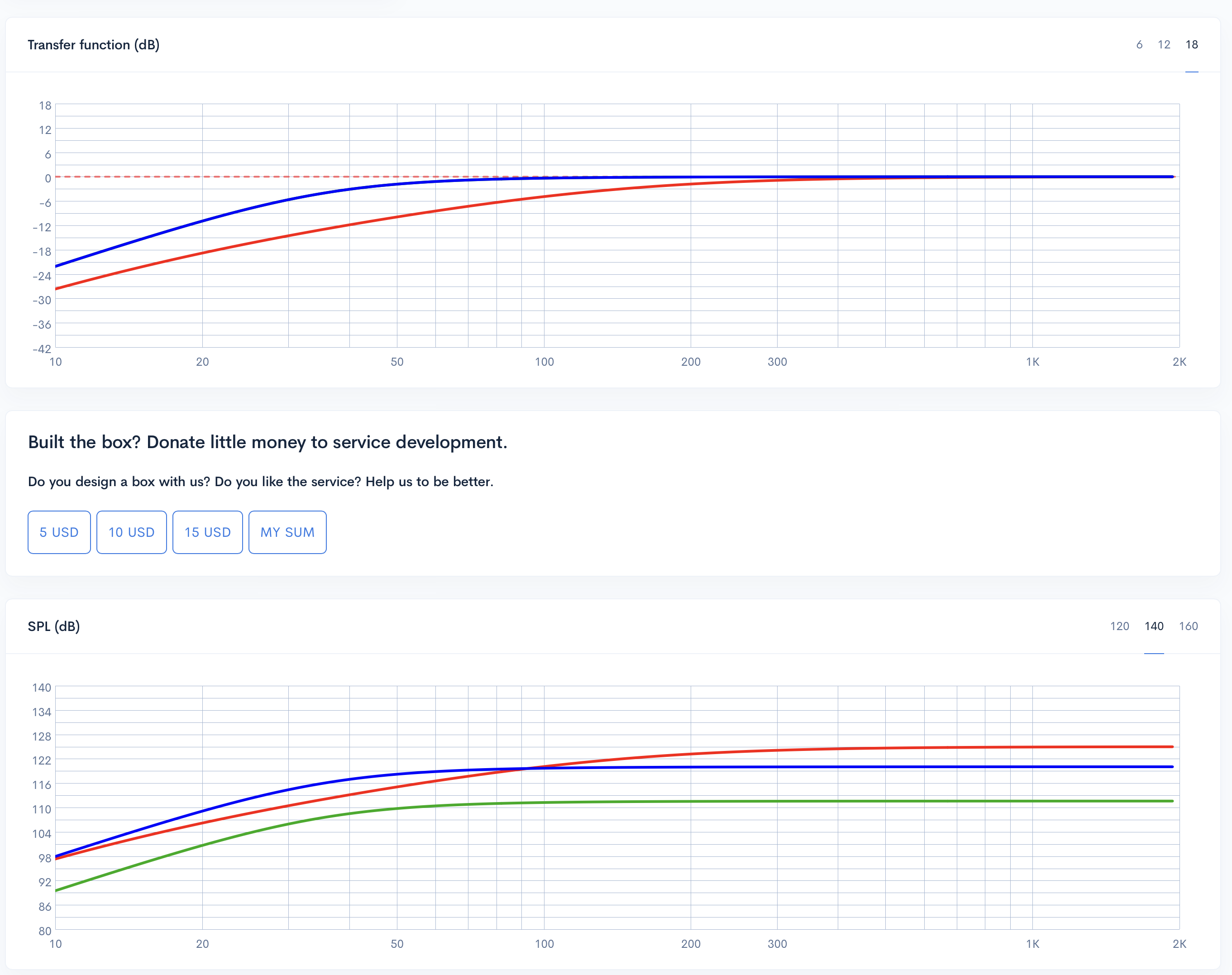

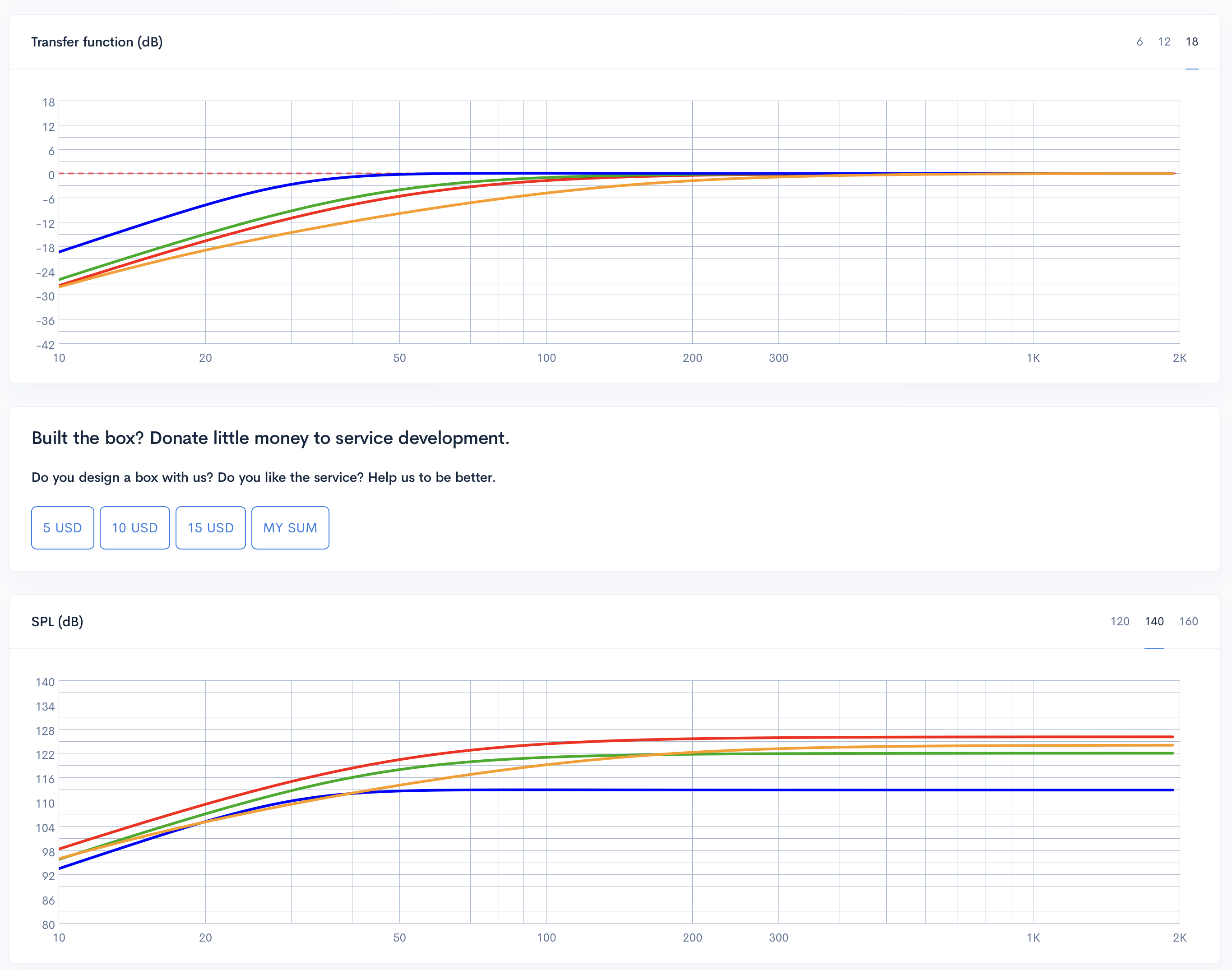

I hear you but looking at a 2 cubic foot enclosure and only 500W I am way down on the db at 10 Hz vs the B&C and marginally better by 6db 20Hz.
Green 15" (only one) 500W
Red B&C 18" 500W
Blue 15" (only one) 3500W
