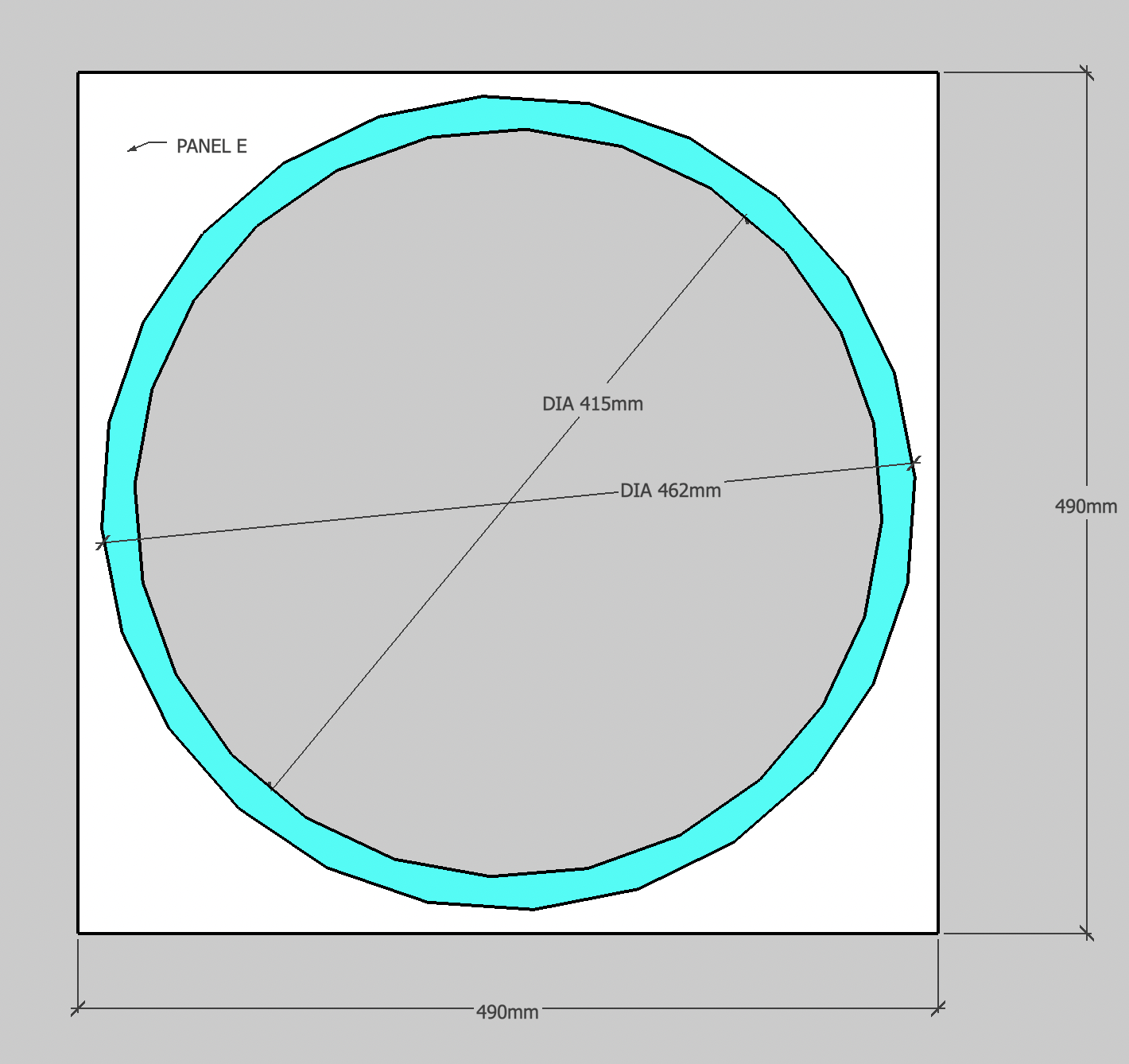

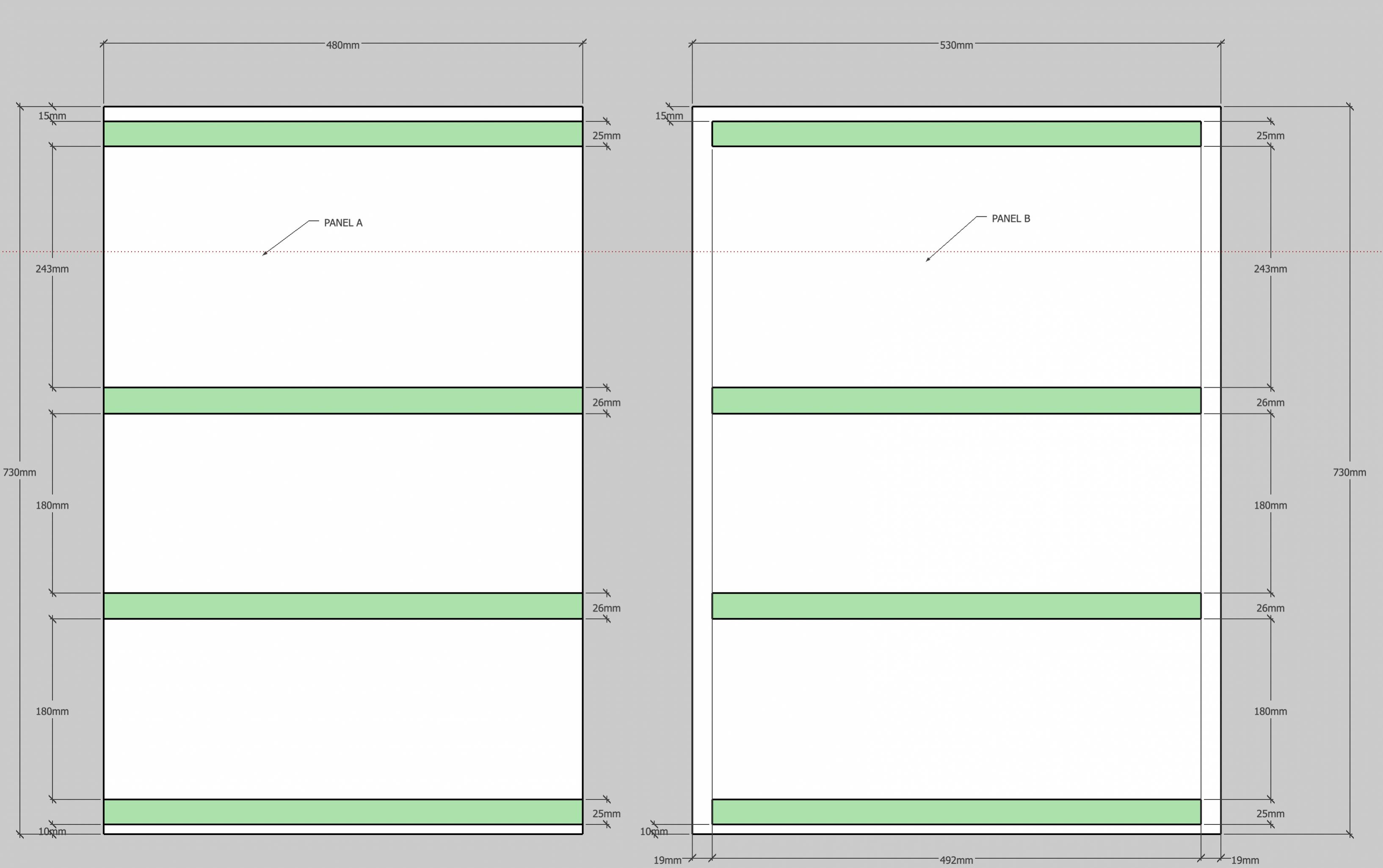

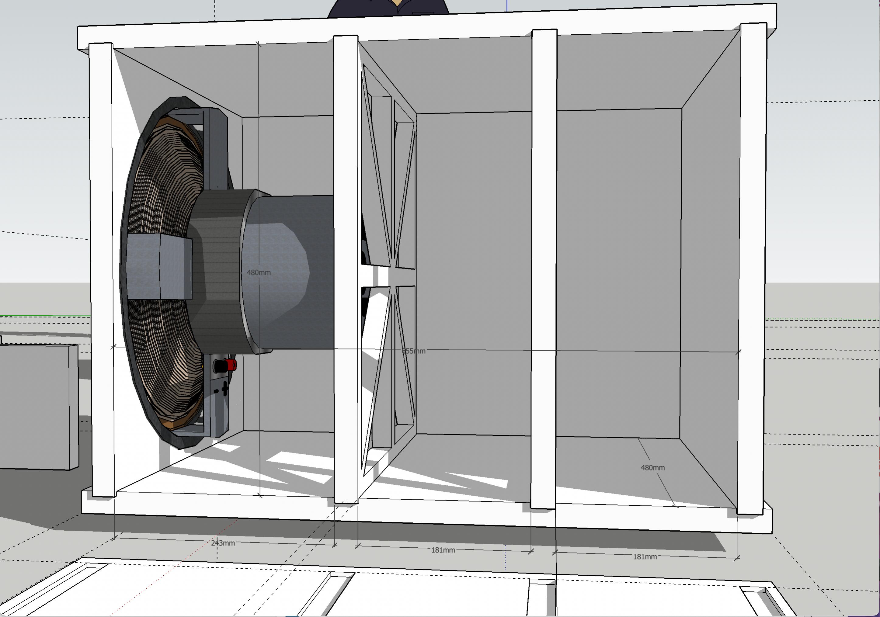

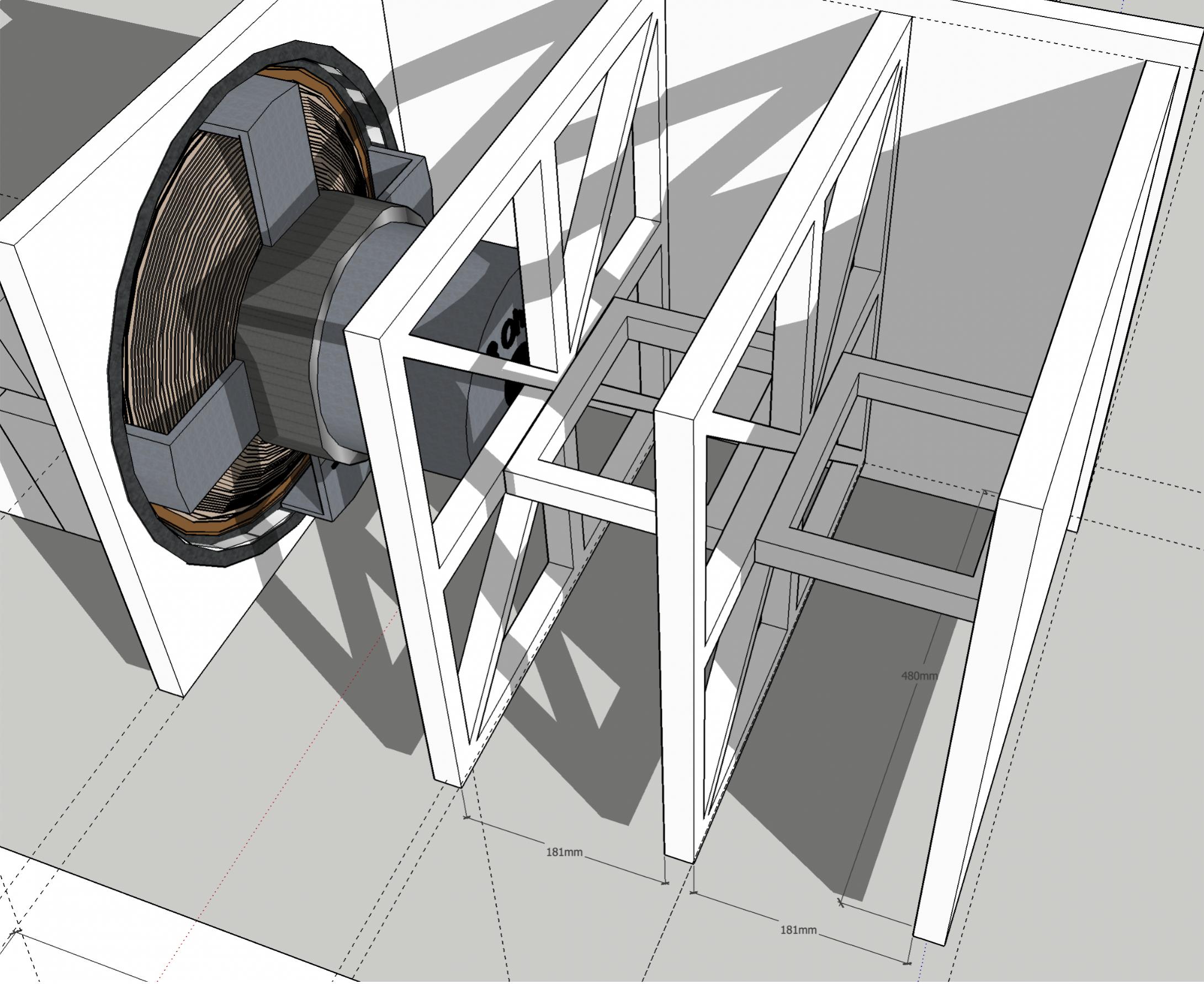

Assuming you wish to replace the driver that bracing setup might be limiting. I’d do it differently bracing front to back with a half circle cut out and then brace to the remaining side walls if wanted.
True but I think most 18's other than the car audio based designs will probably. The B&C has a different bolt circle just to be annoying as well, I might want to tweak the box size I think the box is probably going to be 1/2-2/3 the costs of an exotic driver
But wouldn’t it be easier to just have a circular cutout on the bracing a? Same cutout as the driver itself? Then a few back to front braces of 18x4x2cm between each, maybe two per section per wall total of 24? My point is to stiffen the front.
The front panel is countersunk on all edges by 5mm, which will hold the front panel very rigidly and if you look there really isn't much material left to flex, 25mm birch ply is stiff. If the front baffle was to think about flexing it is pinned very tightly with the edge detail

any advice on this would be appreciated and I also wondered if applying any internal bitumen based panel damping has ever been considered ? (will make it heavier I know !)

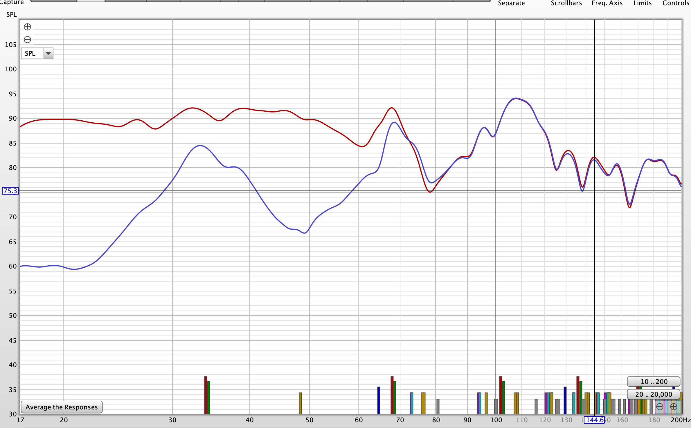

The set up is via a 10x10 Mini DSP which has active filters, it will be 8 channels in (run in parallel) so all apart from LFE to direct to amps that drive the main channels as well as to the Mini DSP so I can then add the missing frequencies for each surround and not need to roll off or EQ the bass in the main channels
Here is an example of a front channel, red is main with the connection to the DSP in parallel, blue is front channel only. I use filters on the input for each channel so when I add EQ'd subs I can remove the bump in the front channel , in this case at 34 Hz. I live with any peaks beyond 60Hz as I don't want to EQ the channels with active filters I prefer room control for everything apart from subs. Adding a 4th sub will hopefully provide a more even response so I can reduce some EQ with the three subs and also provide something below 17 Hz. My 3 existing subs use 12" drivers
