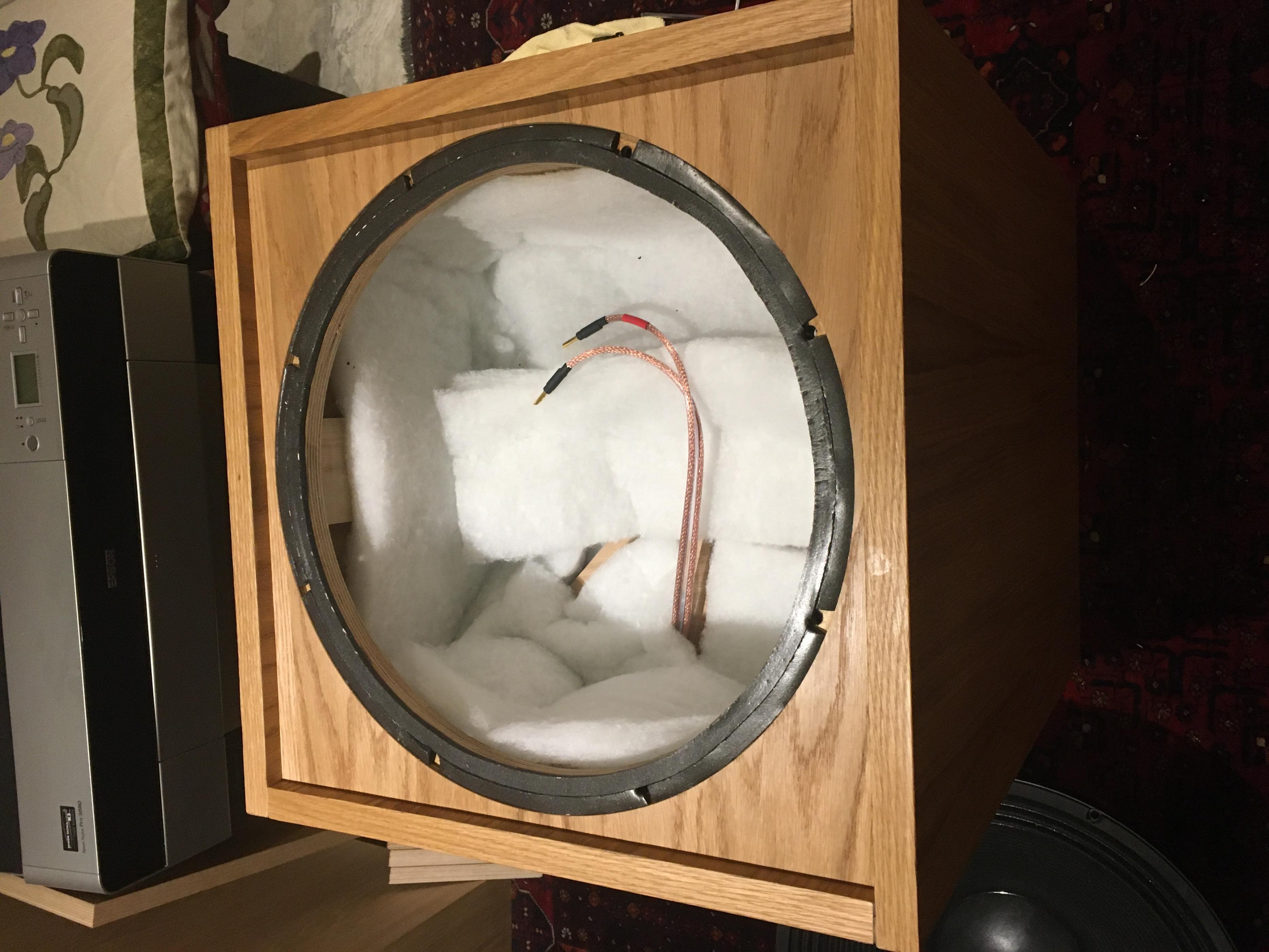

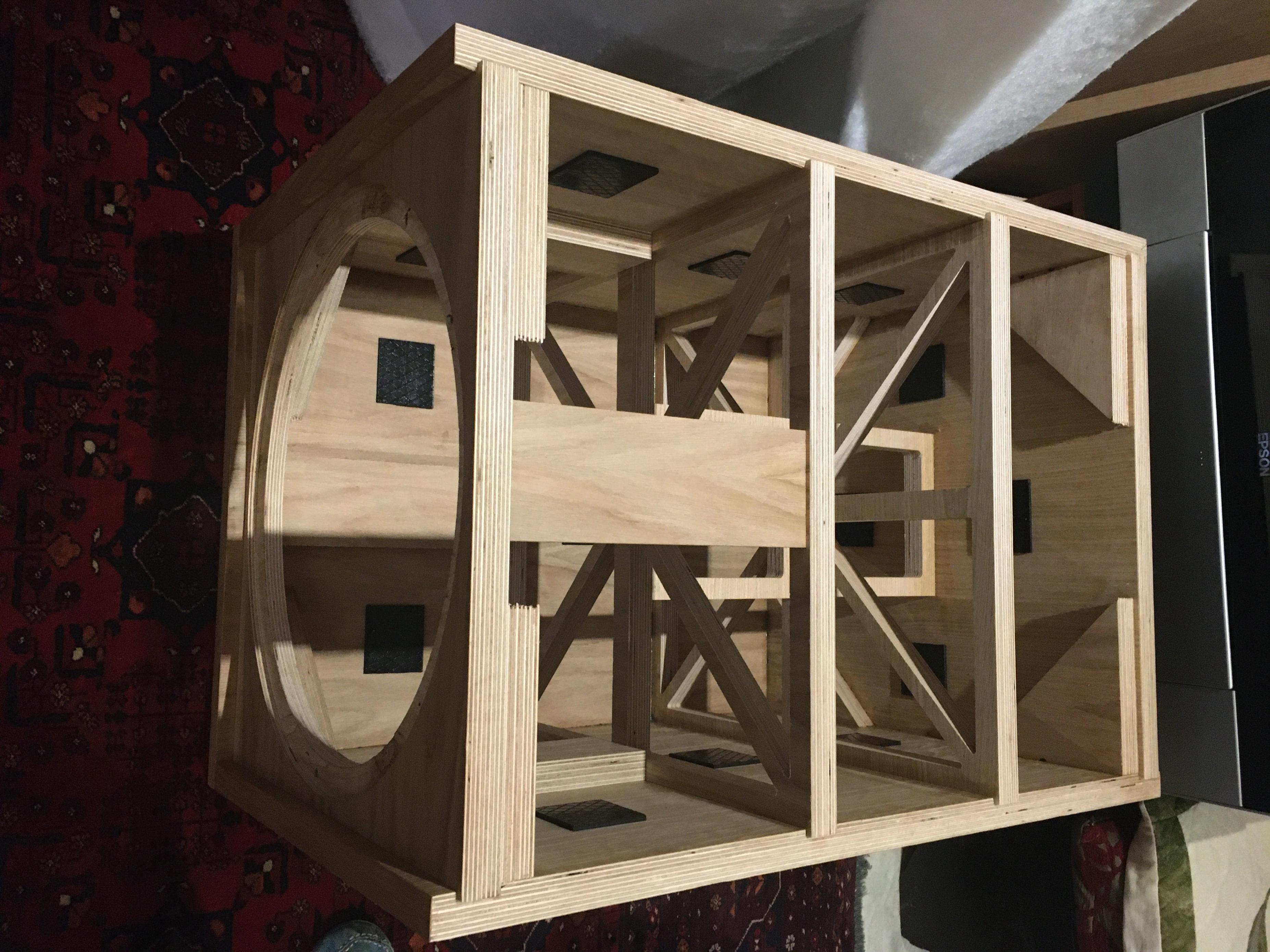

All done will EQ this weekend, 530x530x730 external dimensions

Hello, everything quite impressing, looking to IWC Doppels design. I like the use of dsp to make the frequency response work. In my experience trying out EQs showed me how sensitive the ear is to variations in loudness at different frequencies. Take 2 db too much treble and it will make you unhappy with your speakers in the long run. (For example).
I was a little bit amused about how some think that 18 inch drivers might not be able to reproduce low frequencies loud enough.
Big drivers like 18 inch should have less problems only due to driver surface than smaller drivers.
I was quite impressed with the Tymphany 15 inch bass. What a well designed monster!

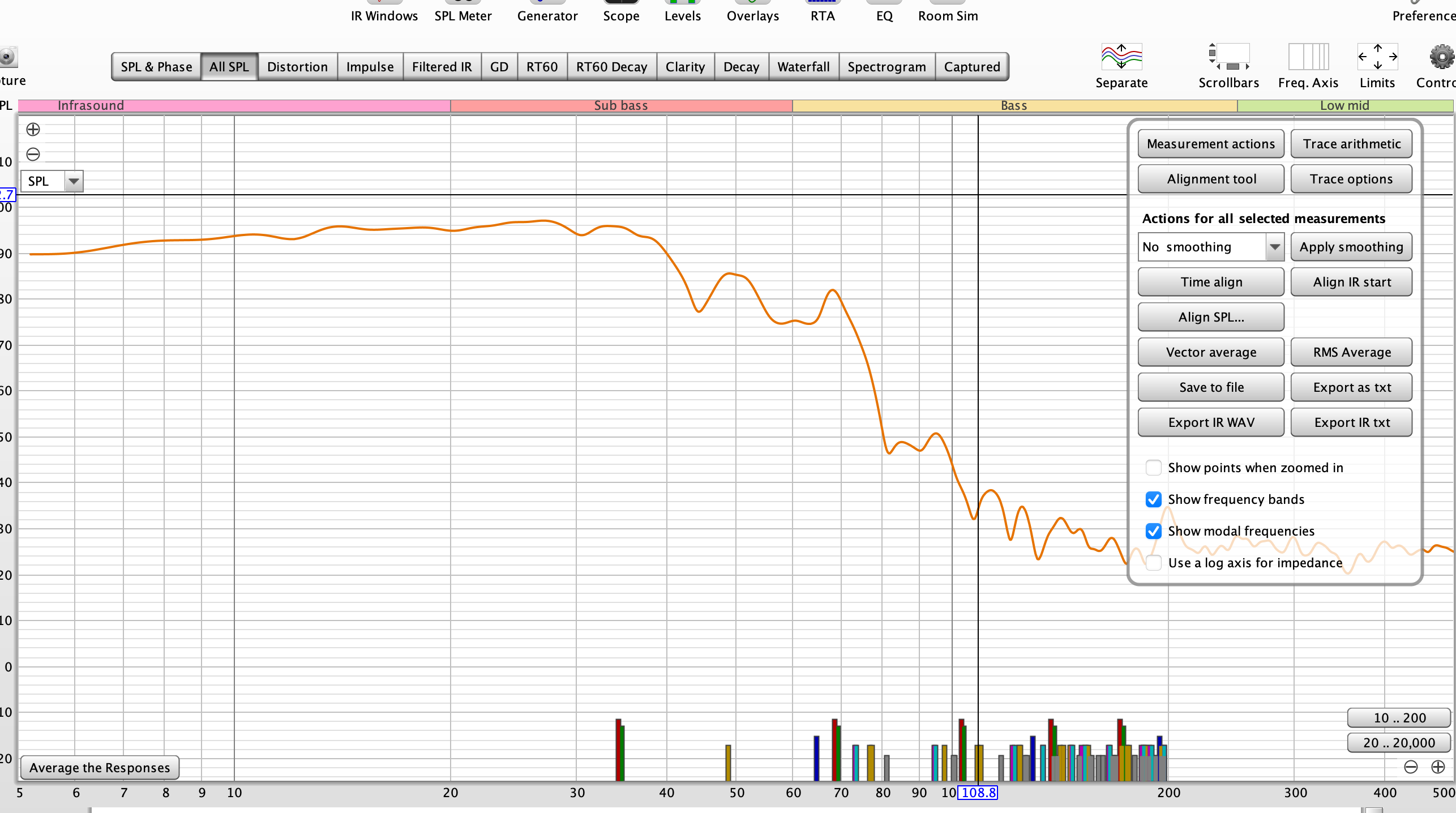

Early days, I set by ear and one expected EQ last night (room mode) and it was stunning, the film was superb effortless deep tight bass and a greater sense of scale, no boom, no drone and very impactful
This morning I EQ'd and set level to match in with the other 3 subs and time aligned, Wow this fellow goes low, measuring from 5Hz, I'll run to 40 Hz perhaps a little less. This is EQ's with just two PEQ filters at 30 and 34 Hz and rolling off from 40 Hz, I'll probably roll of quicker
