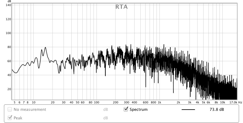

You can see the spectrogram of the final seconds of that band below. Yup, 16 Hz.*
Ben
*I wish anybody believed that's from a mike in my music room. Alas, no. From the electric feed. Amazon has a copy for $30. Or you can join the Montreal audiophile club and ask for Disque Test CD #3, band #9.

Not calibrated: relative dB. Noise floor in bass for this set-up is around 0dB. I have no idea where sub-sub-sonic garbage is coming from. Quantum mechanics?
All electric.

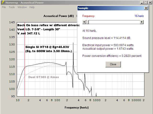

Hi Bach On,
So your first try will be w/ 2ea. ST385s, and the 7-3/8"I.D. x 30"long vent. This should give you a very good idea as to where you are with your project. It's a lot of effort, but I think it will be worth it. I recommend you use a lot of fiberglass in the bottom of the enclosure. It should be far enough away from the drivers not to give you any problems, or you can use polyfill too.

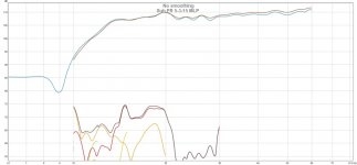

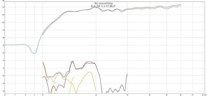

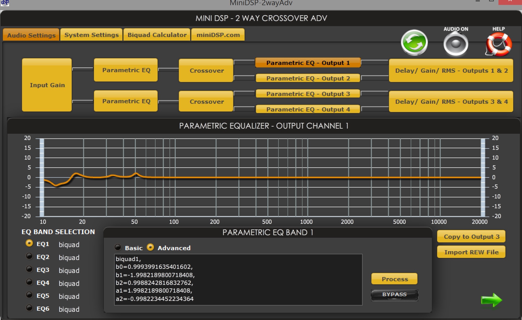

Hokay, here we go!
First pic: Subwoofer response at mlp, volume at -20 position.
Second Pic : EQ settings used to get there.
Youtube link: Screen capture of OmniMicV2, playing last 2 minutes of Passacaglia and Fugue in C minor, BWV 582 (because that's the file I already posted the spectogram of)
Warning: Subwoofer level was increased +5 db from where it normally is, so if the video seems bass heavy, that's correct. I did that because I wanted to show SPL capability of the subwoofers, without having massive screaming pipes in my ears. Plugs can only do so much.

Hi Bach On,
Thanks for the additional information. Did you install the drivers front to back (as in my sketch), or both on the same baffle?
The SI HT18 has to be the current price leader. I have no personal experience with this driver, but from the simulations a single HT18 will outperform a dual ST385 in your box using the same enclosure and port dimensions. I'll attach another simulation comparing the single HT18 @ the Eg that corresponds to its rated Prms, and the dual ST385s @ Xmax. This shows the single HT18 providing clearly higher output, it does not show that the peak port velocity has doubled (to about 32m/sec); so, some of that additional output will be eaten up by turbulence in the port. As far as I'm concerned you'll need a second enclosure for the second HT18, or a much larger enclosure for both; naturally you can just stuff both into the current box, and see what you get (maybe, close of the port?).
There is so much that can be seen from the simulations, that I can only ask you to take the time to learn Hornresp:
Hornresp

DrDyna's trace sure is impressive. The EQ quite minor.
What's the smoothing?
Where's the mic - listening position or up-close-and-personal with the speaker?
Is the THD 85dB down or is the scale different?

No smoothing, mic at MLP, about 12 feet away from mains, and about 6 feet from the subs.
Edit: The db scale in the REW screenshot is probably not entirely accurate, but the scale in the video is dead on.

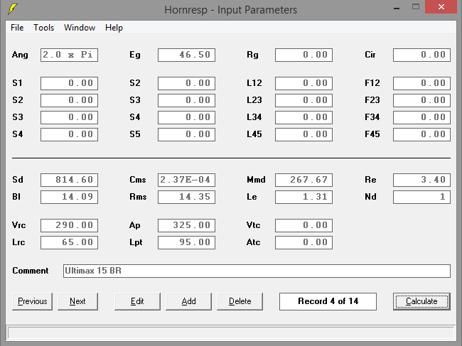

The measurements in the room are quite different from what HR predicted, there wasn't a port "hiccup" like it says, and the F3 is about 5 cycles lower, but I'm blaming that on having them jammed tight in corners. From what I can tell with my at times shaky vision, the excursion graph seems to be pretty dead on, though.
Here's the HR input screen.
It's entirely possible that some of the inputted figures aren't spot on, as this was really just a test cab to see what would happen in 13 cubes with that vent..I just happened to like them enough to not take a hammer to the cabs yet 🙂
Edit: Actually, the F3 is closer than that, now that I'm looking at the prediction harder.

Sort of near field, yes. Around 6 feet away from where the mic sits, which I have on a stand. It sits straight up in the air where I normally park my butt. When I take measurements with OnmiMic to generate biquads for the MiniDSP, I sit with the microphone just above my head while I'm slinked into the couch, and with one hand I move the microphone around in a 3d area about twice the size of a basketball, while clicking on "more averages" inside OmniMic. That's where the correction filters come from, I let it do all that stuff automagically, and it's pretty good at it.
Yeah, the distortion is low in the FR plot, but that plot was taken with the volume knob at -20, and REW's measurement generator (which I use after I'm done with OmniMic, as I just think REW is prettier.) sits by default at like -12, so it's really not that loud. It's actually just slightly higher than my perception of the tones it's generating.
So, I would expect that the distortion is more or less in line with what you'd expect a pair of 15" woofers to be when I go from -12 rew sweep with the volume at -20 to the media player at full tilt and the receiver volume..uh, up around -4? when I recorded the video?
I can re-do another distortion graph and try to calibrate rew's chart to match omnimics, which I just haven't done because it hadn't mattered, I didn't need both pieces of software to be spl calibrated.
INBD though, I'll try to do it tomorrow, if you are genuinely curious to see what the distortion really is, but I'd imagine it's probably right where you'd expect it to be, starting it's journey through double digits.
