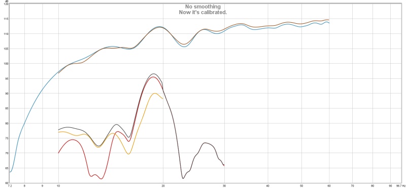

Ha! The um driver's cone is actually quite rigid, when you knock on it with knuckles, it makes a sound sorta like knocking on a door.
Nah, the rew FR isn't averaged, I only move the microphone when I'm taking OmniMic measurements to generate the filters, I switch to REW to measure the "after", just because I think the graphs are easier and prettier (plus I'm lazy and I haven't tried to get OmniMic to display a THD overlay.
Give me about 30 minutes and I'll go measure the THD with rew and with the volume cranked closer to where it was at in the video.
Edit: This is much louder. As it turns out, REW is calibrated by default, as the OmniMic cal file contains level information, whoda thunkit?
Interesting, the FR changes a bit...but at this volume level, both of the doors in this room take off on a little acid trip right around 15 cycles, so I'm not sure if REW is interpreting that as distortion, or changing the response...but nonetheless, this is what the distortion looks like when I'm half a bubble away from flicking the clip indicators on the NU4-6000 that's driving them (on two of it's channels.)

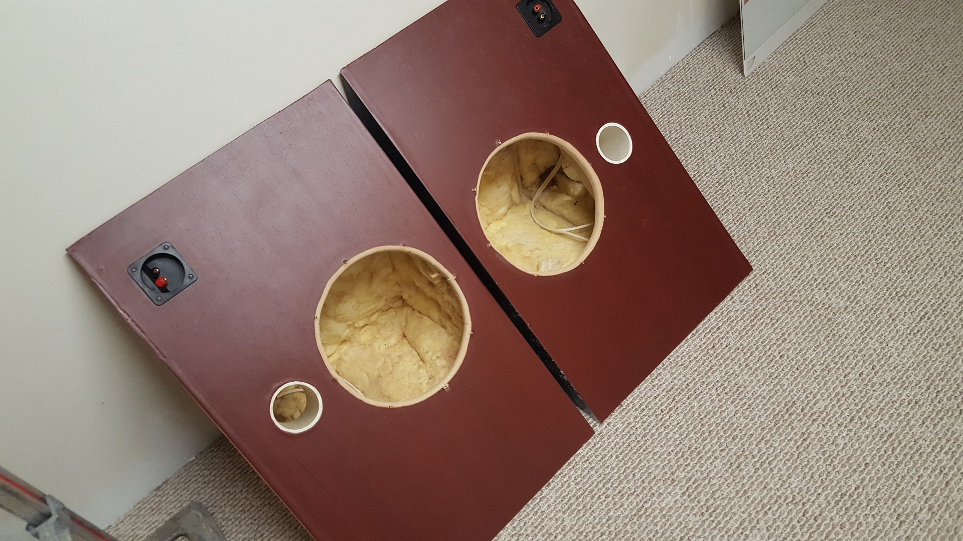

Hah, triangles! I just happen to have a couple of those as well, but they're for 12s...and they're only tuned to around...oh, I think 27 hz? or so. They do work really well though, and in the corners, they take advantage of corner loading. They could EASILY be made taller for more internal volume, and a lower tune.
