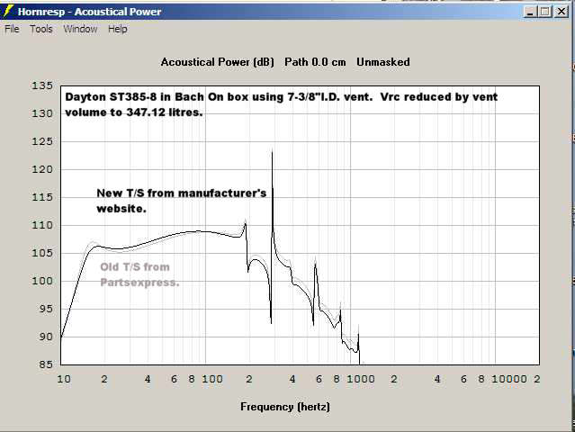

Which driver are you using in your simulation from Post #452?
From the manufacturer's data sheet for the Dayton ST385, and using Hornresp recalculation feature I get:
fs = 18.80 hertz
Qes = 0.33
Qms = 8.31
Vas = 300.90 litres
Qts = 0.32
the rest you can see from the Input screen in my simulation, e.g.: Post #434.
Just trying to make sure that I have the correct T/S parameters.
Small variations should not matter, but you have a considerably larger Vas=545litres, and a lower fs=15.46, that's too much of a difference for my liking.
I've taken the T/S parameters from the manufacturer's website:
http://www.daytonaudio.com/index.php/st385-8-15-series-ii-woofer.html
Hi Icsaszar,
Thanks for the link.
I compared both in Hornresp, and the difference is smaller than I thought. I reduced the internal volume to 347.12 litres [12.258ft^3] to make up for the lost vent volume of 21 litres.
Hi Bach On,
The sim in Post #467 shows that the different T/S parameters provided by the manufacturer, and by Partsexpress will both work in your enclosure w/ the 7-3/8"I.D. x 30" long duct.
