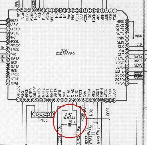

Guido Tent said:
the redbook spec covers a max deviation of +/- 100ppm
I think this shift range spec is not master clock diviation.
16.9344MHz master clock of CD decorder (like CXD2500BQ ).
That is CD format 44.1kHz sampling frequency, it is not
And consumer digital signal transmission format in IEC-60958 recognize +/-1000ppm for PCM Encoder unit 44.056kHz.
