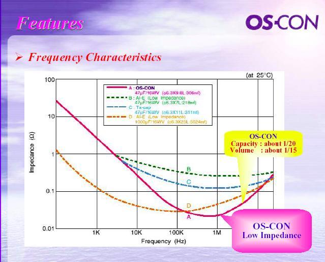

OSCON's are good, aren't they...
They can feed the noise from Vcc to the ground (common) plane, and they do excellent job.
Now, please consider what will happen if you lower the noise OF THE COMMON (GROUND PLANE) and you keep the OSCONS?
This is why I recommended to ground the oscillator to the SACD PCB ground plane with the least amount of noise.
Boky
Boky

OS cap Low ESR
SANYO OS-CON is very low ESR and good frequency characteristics.
http://www.edc.sanyo.com/english/pr...n/download.html

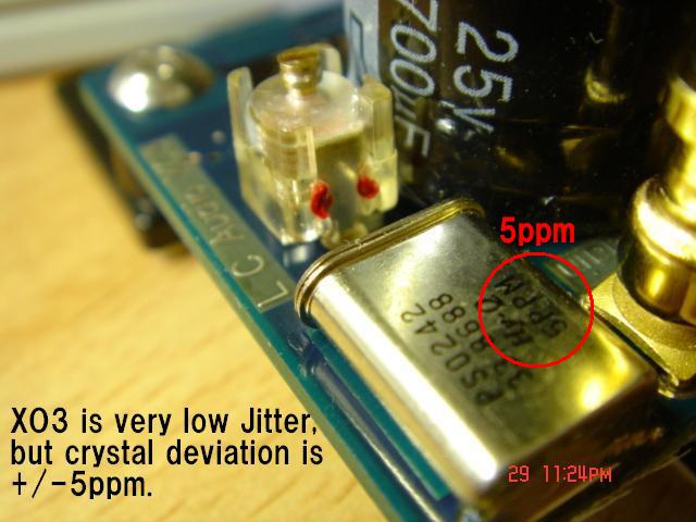

Re: XO3 is good C/N but +/-5ppm deviation
parts per million deviation is not that important; the important thing to know (or measure if you have the equipment that can do it) is jitter performance at around 10Hz.
5 PPM means that you will either LOOSE or GAIN for example 5 seconds in approximately 11 days' period (Wikipedia), and this is not important for us at all - AS LONG AS THOSE seconds "keep coming" at exactly the same intervals.
Boky
nagaesan said:Let's stop minding clock deviation +/- 1ppm or not.
Boky

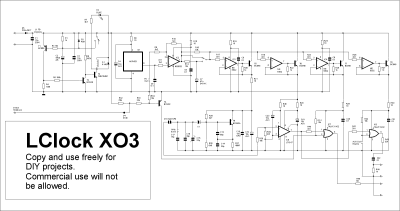

This is XO3 schematic
Let's refer to low JITTER good C/N clock schamatic.
(It is different my original clock unit)
http://www.lcaudio.com/images/LClock/xo3dias.gif
Yes, the amount of jitter at around 10Hz will directly affect the timing of our clock signal, and our ears are very sensitive (actually, our brain!) to these variations.
The lower the power supply noise - the lower the jitter - hence - lower disturbance and more accurate timing of our clock signal.
Some prefer sine wave output, some square wave... it is academic...but I am sure many would discuss this topic to the Nth degree.
Boky
Boky

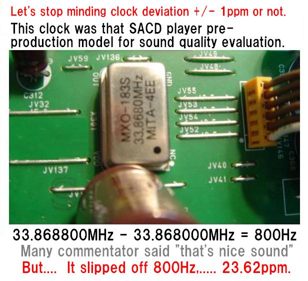

This is pre-production model for commentator & reputator sound check.
SACD decorder module frequency is 33.868800MHz.
But this was 33.868000MHz clock.
Because, even if 800Hz (23.62ppm) slipped, people did not notice it.
EXACTLY!
as long as "whatever quantity of MHz remains" ARRIVES AT THE EXACT SAME RATE everything's sweet!
Boky,
Boky,

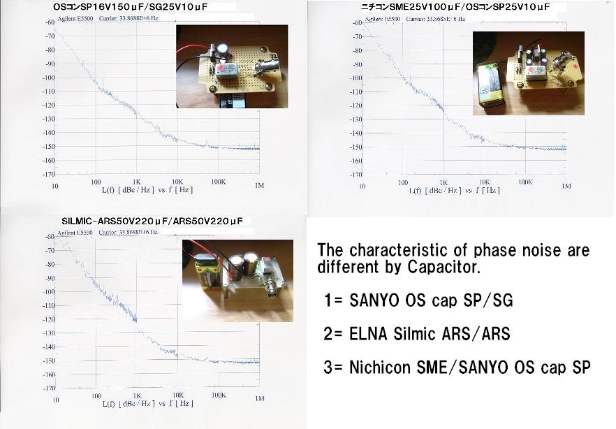

Re: Jitter = phase Noise
MAX2620 is better.
nagaesan said:Dear oscillator researchers
clock deviation ..... +/-1ppm, = not jitter
clock purity.............C/N, phase noise,-130dBc@100Hz = Jitter
I measured several crystal oscillator's Phase Noise with hp E5501B.
Attached file is LcAudio XO-3 jitter.
It is very nice jiter than usual SPXO and TCXO oscillators.
Crystal oscillator produces undesirable phase noise near the output frequency.
�@Phase noise is measured in the frequency domain, and is expressed as a ratio of signal power to noise power measured in a 1 Hz,10Hz,100Hz,1000Hz, bandwidth at a given offset from the desired signal.
MAX2620 is better.

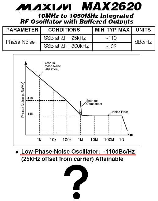

Re: MAX2620 is better?
Page 6 of the datasheet shows SINGLE SIDEBAND PHASE NOISE 10dB lower than the LCaudio. And this is with a cermic resonator so I guess it will be much better with a good crystal.
nagaesan said:MAX2620 is better?
Tico wrote:
>As you are still using the Tent module it can't be better than that<
Why not? The TENT with our powersupply is HUGELY improved over the TENT with other powersupplies. And even cheaper oscillators with our powersupply sound pretty much equal to the TENT.
>You supply looks primitive to my eyes.<
Primitive? You can tell circuit topology, circuit concepts and circuit values from looking at a photo? Opinions don't count for much with me. What do you like then?
Regards, Allen (Vacuum State)
Re: Re: MAX2620 is better?
Don't get too excited, the Offset frequency on that grapph, is KHz
not Hz away from carrier. 🙂
So we are talking -105dBc/Hz at 10KHz not 10Hz.
This is to be expected it is a cheap chip solution.
cheers
T
cheers
T
