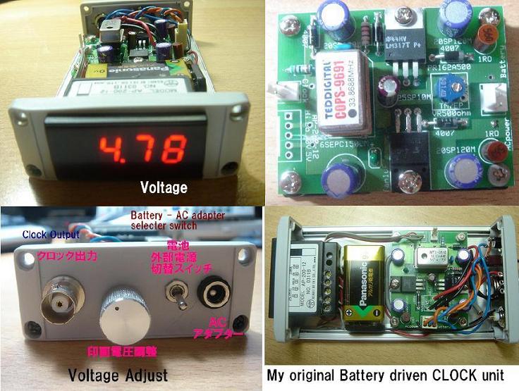

Battery drive clock unit
Hi! Clock reserchers!
I made some clock unit, this is battery/AC power selectable unit.
How do you think this idea?
Joke? or Serious?
So,I held "clock audition" No.723 IKEON DCD-SA1 special audition.
http://www.ikeon.co.jp/impression/audio214.htm <---sorry Japanese
People like battery driven unit.
Joke? or Serious?

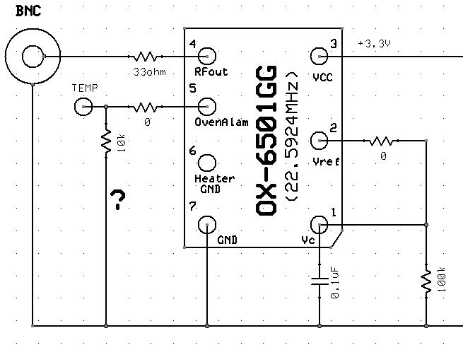

How do you think this OCXO for Audio? Some one sais this is +/-0.5ppm deviation.
I think so, but recently a famouse maker adopted this +/-0.5ppm OCXO for their SACD player.
I don't understand why this diviation is +/-0.5ppm?
Please tell me if someone know what is "+/-0.5ppm"
EPSON/TOYOCOM OCXO(Oven Controlled Crystal Ascillator)
OX-6501GG
http://ndap3-net.ebz.epson.co.jp/w/...06f002d9d79/ab225a188f4a26264925750400074959/$FILE/OX-6501GG_E08X.pdf

And if someone know how to use "Heater GND" of OCXO, please teach me the problems when RF out GND connect Heater GND.
Nagesan,
>>And if someone know how to use "Heater GND" of OCXO, please teach me the problems when RF out GND connect Heater GND.<<
The schematic you posted looks like just one small part of a full data sheet or application note. Where did you get it, maybe the full data sheet is also there.
The schematic you posted does not make much sense, as I suspect the oven heater will not be connected if there is no earth connection for it.
I suspect the full datasheet will give much more information, that's what we need to find.
Regards, Allen (Vacuum State)
Nagaesan,
You ask:
This is the frequency SHIFT in percentage that can be adjusted by the user by changing the voltage on the control pin, Pin 2 "Vc".
This of course is really NOT wanted for a clock in audio equipment as any noise on that voltage on Pin 2 will be DIRECTLY turned into an FM modulation, which is JITTER!
Nagaesan,
do you have equipment that allows you to make jitter measurements on oscillators?

The schematic was not datasheet but SACD player
Hello
That application was new high price SACD player's OCXO oscillator.
I don't really understand why they use OCXO with SACD player.
And also this SACD manufacture said this XO6501GG is +/-0.5ppm.
