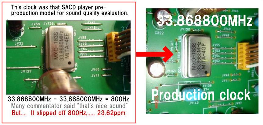

We JAPANESE, -23.62ppm diviation can not in fact audible.
Re: Re: Redbook vs. Good Sound
Few years ago, I have held clock unit audition party.
I made variable voltage clock power suplly, and hearing test.
We JAPANESE can audible -20ppm difference, if +3.3V clock unit's standard supply voltage change to +2.85V.
But in this difference, cause was increse phase noise, not clock speed fast.
