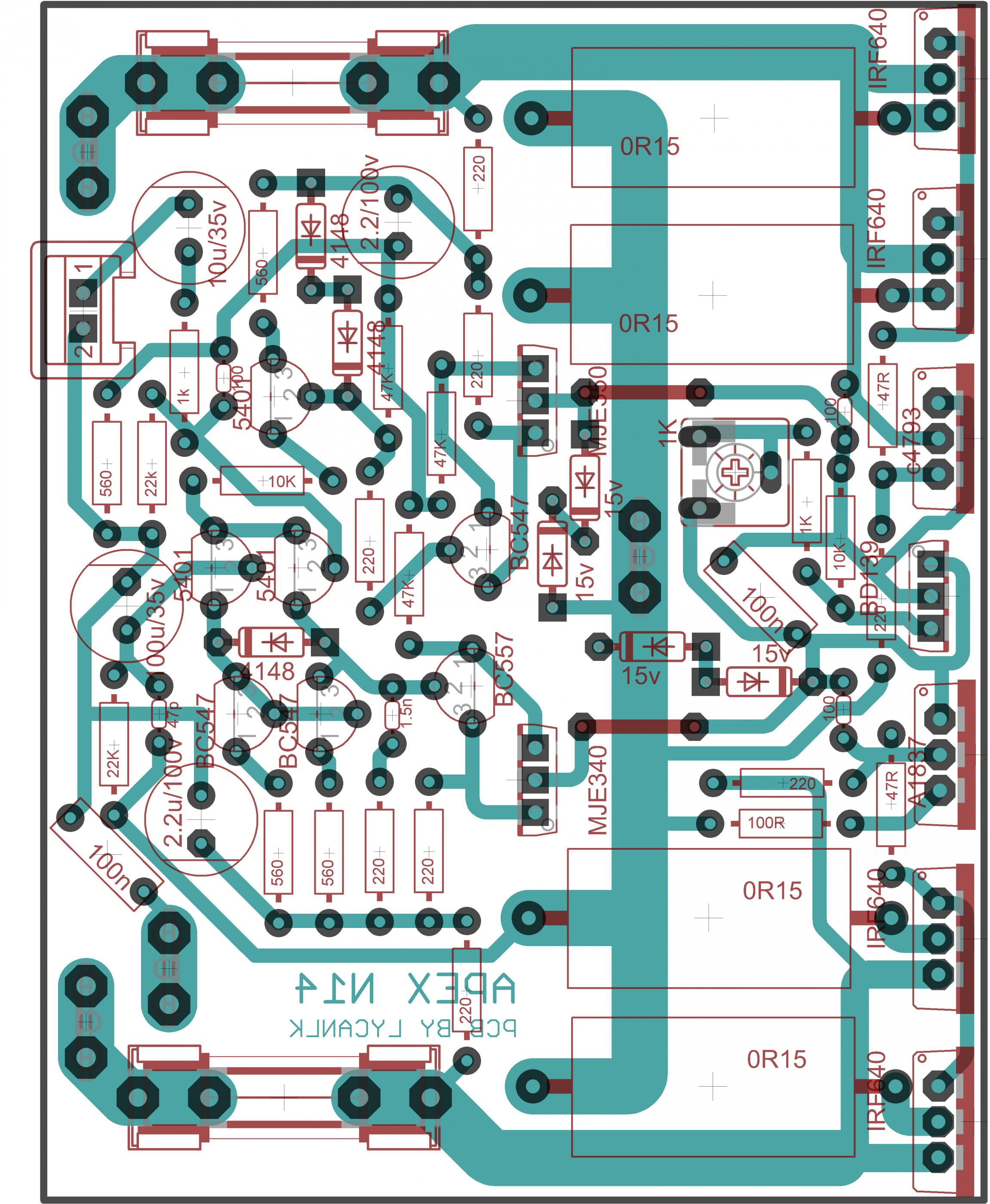

Can I drive NX14 with 2 pairs of IRF640 without any changes to the amp?
regards,
Lycanlk
Yes you can,
Regards

That's alright! 🙂 You have given us more than enough. Anyway it looks like a pretty simple amp.
Lycanlk
2pair of 640 on +-30Vdc using 0r15 as Rs should be OK.
Try 25mA (4mVrs), 50mA (8mVrs), 75mA of bias (12mVrs)
Monitor temperatures as well as bias, for long enough to ensure you are seeing typical fully warmed up operating conditions.

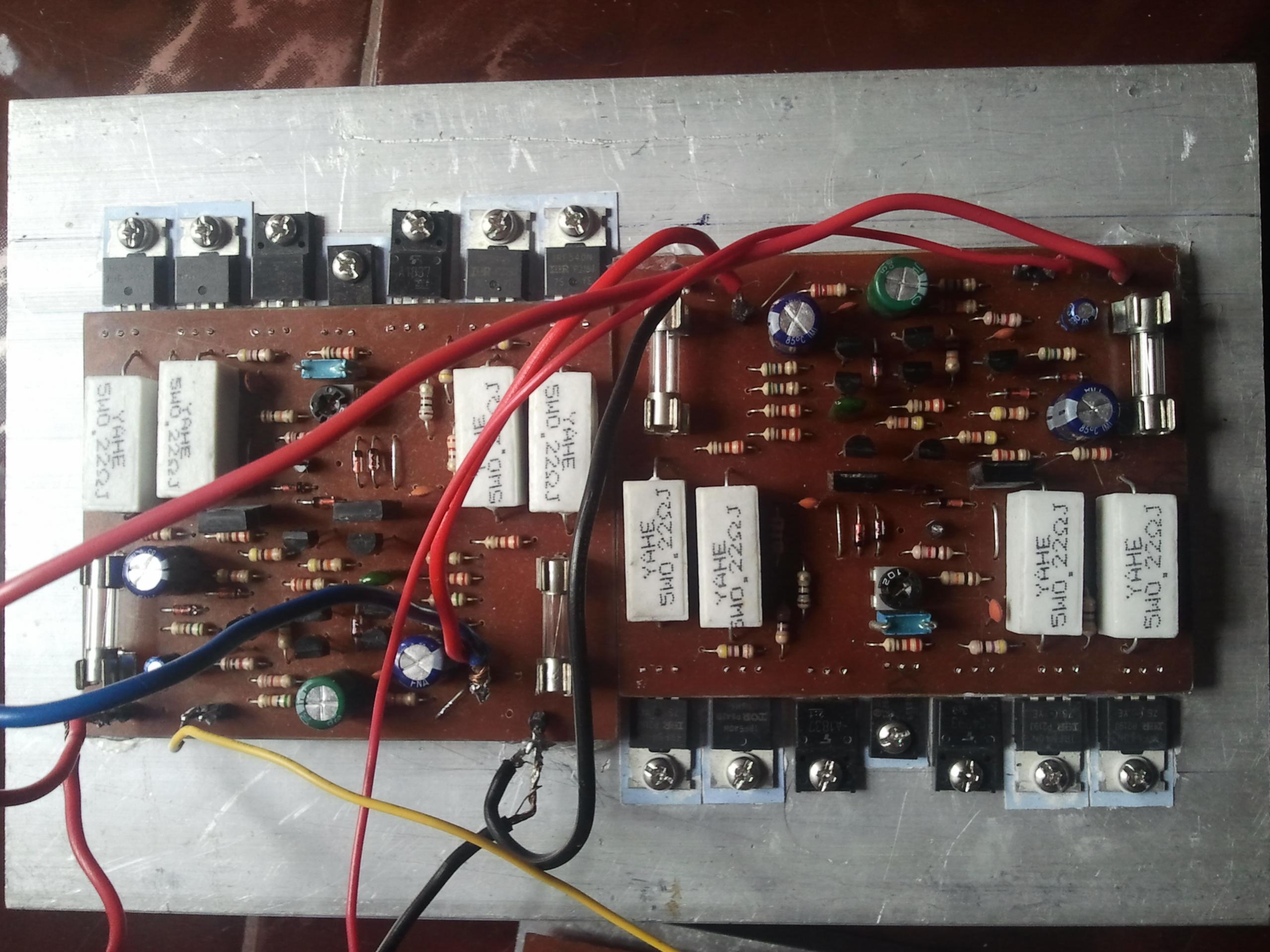

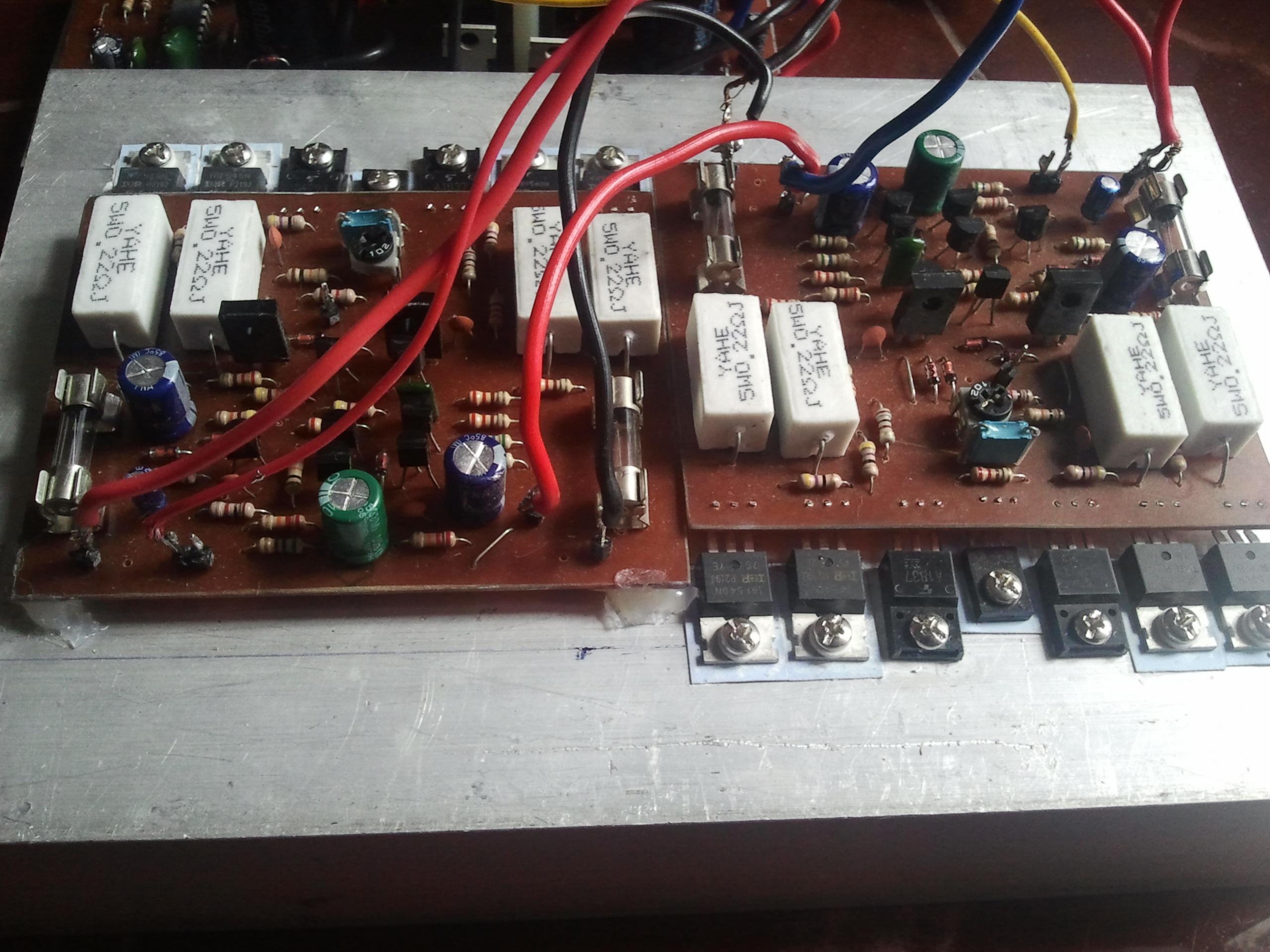

Bridge mode
Supply +/-35v
Removed 100n between signal ground and power ground and connected.
Used external inverted/non-inverted input for bridging.
Bias current 25mA
Insufficient current in my power supply to drive both amps. Used it just for testing.
Thumbs up for the amp!
Cheers!

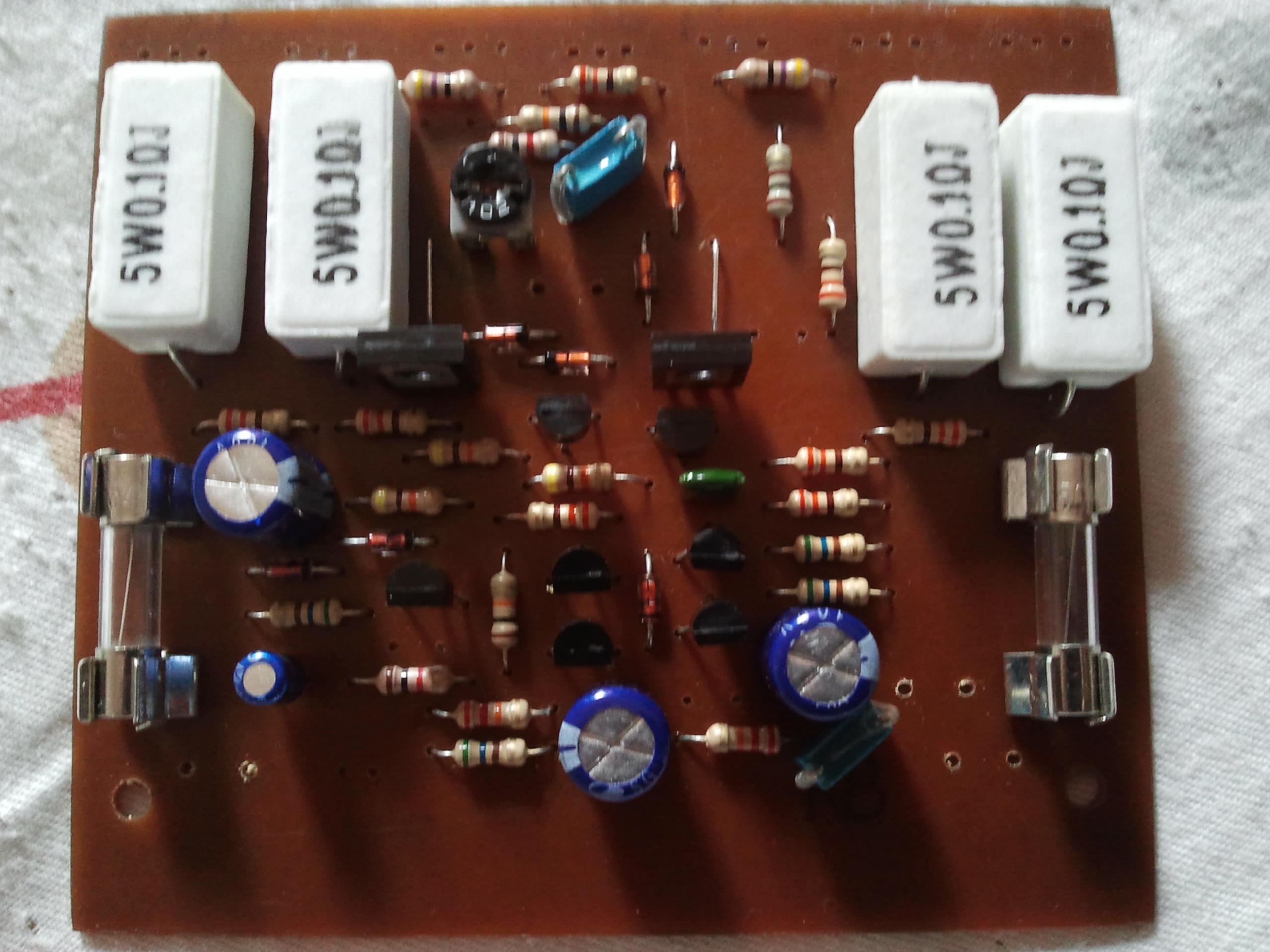

Hi lycanlk,Dear Mile,
I designed a board for me to drive NX14 with T0-220 type outputs. There can be mistakes which I have done with tracks. Could you check them for me please? (I'm not good at designing)
Thank you!
Can you share this pcb? i have some FQA70N10 , can i use it for NX14?
