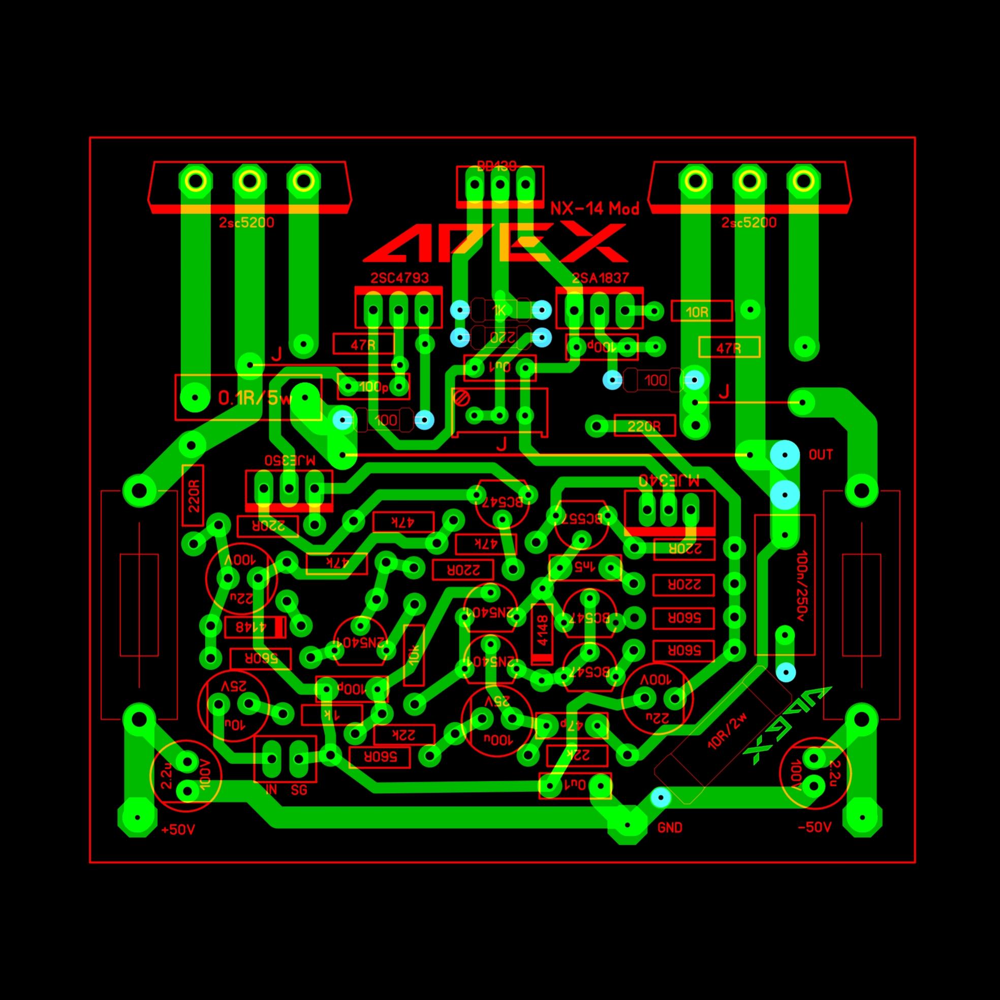

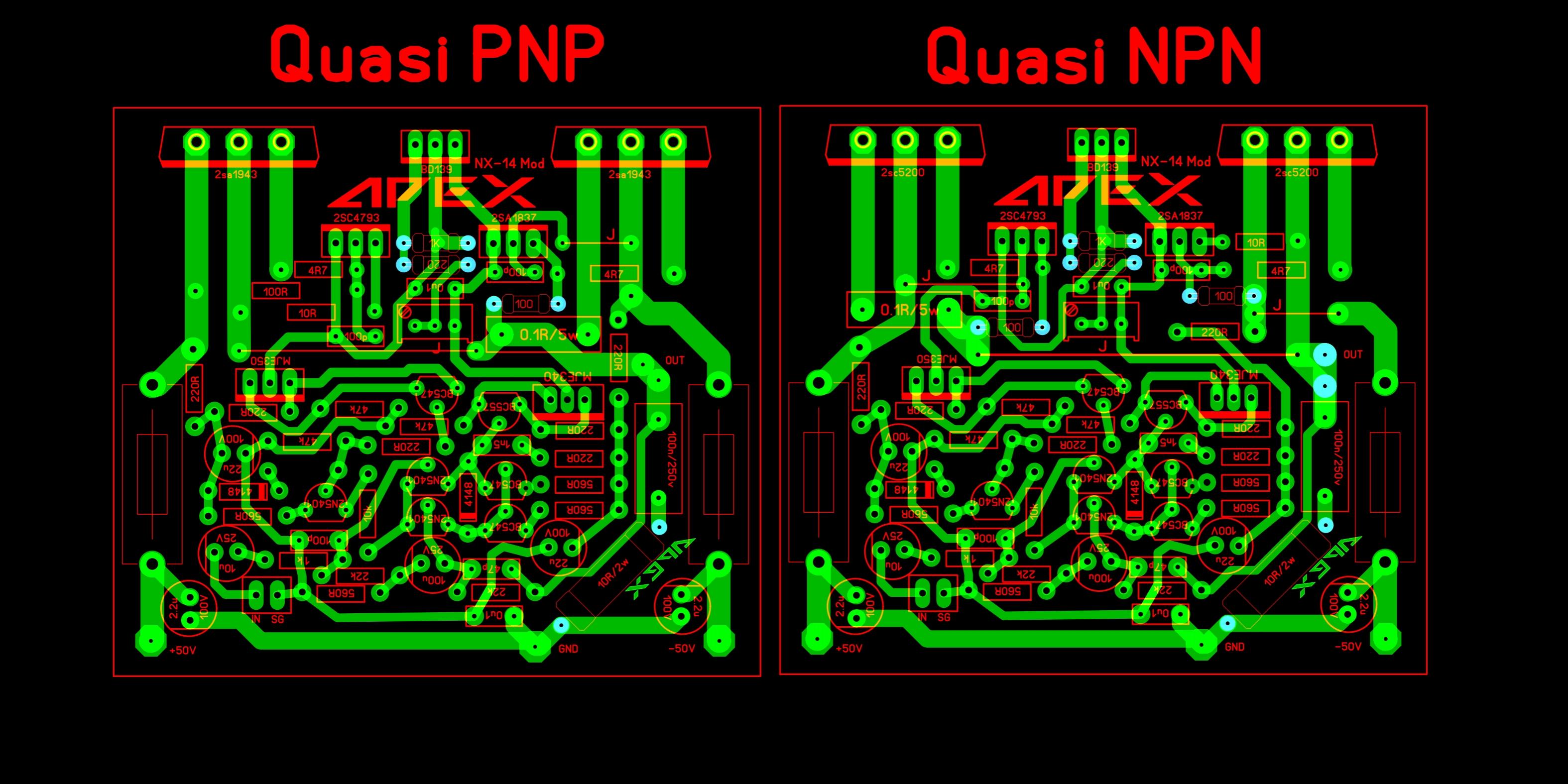

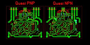

Apex quasi 2n3055 NPN only
Need some advice.... Thanx
Regards
Quasi PNP
Regards

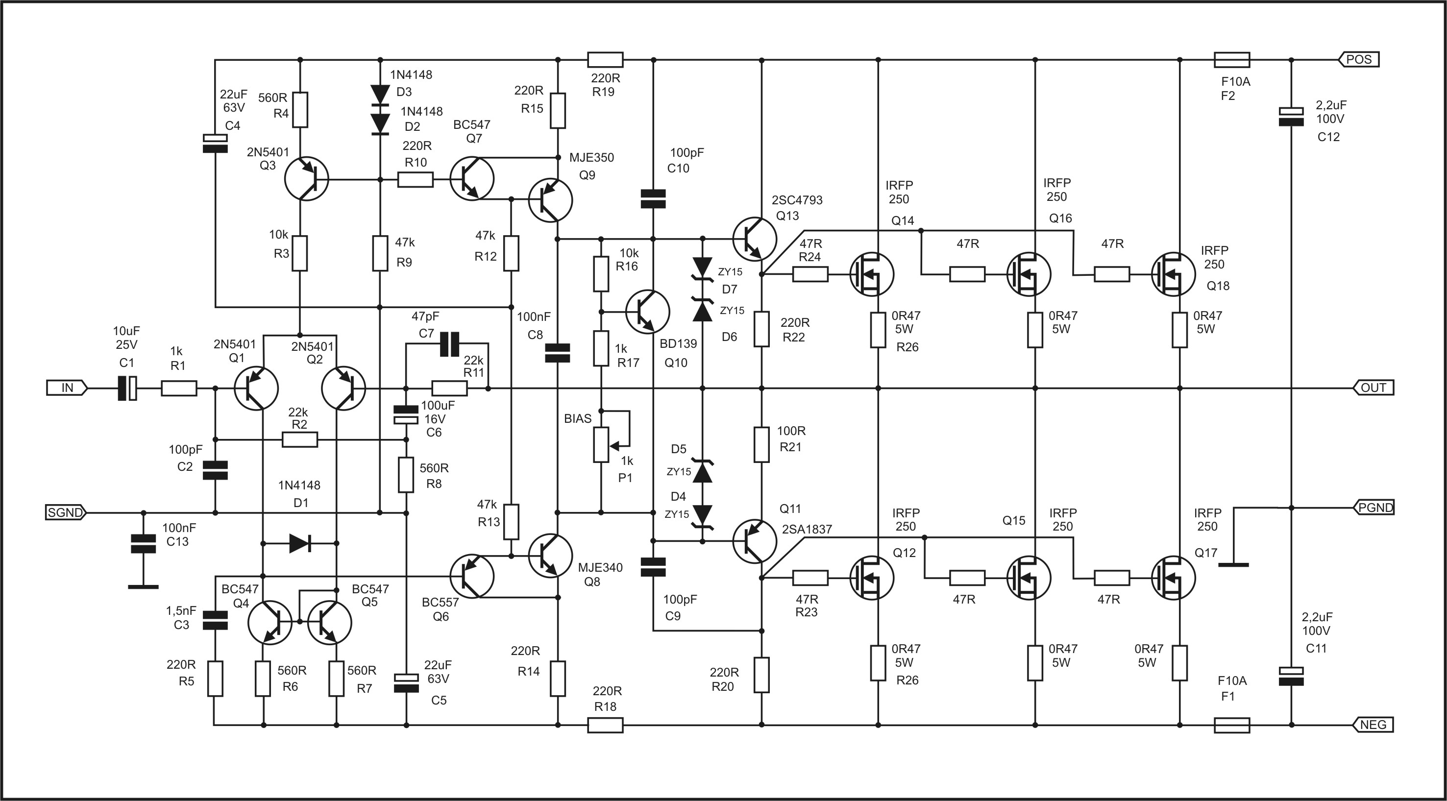

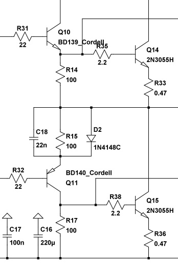

baxandal??
hello bimo, can you show/write in schematic. (baxandal improvement). sorry, i'm beginer. i just draw schematic from mr. Mile schematic. thanx
regards
regards
regards
Thank you bimo, i will try to build, so it can compare with criminal schematic. I hope will increase improvement. Justeru wait comment from mr. Mile about this.
sorry for mistake typing
criminal -> original
justeru -> just
regards
justeru -> just
regards

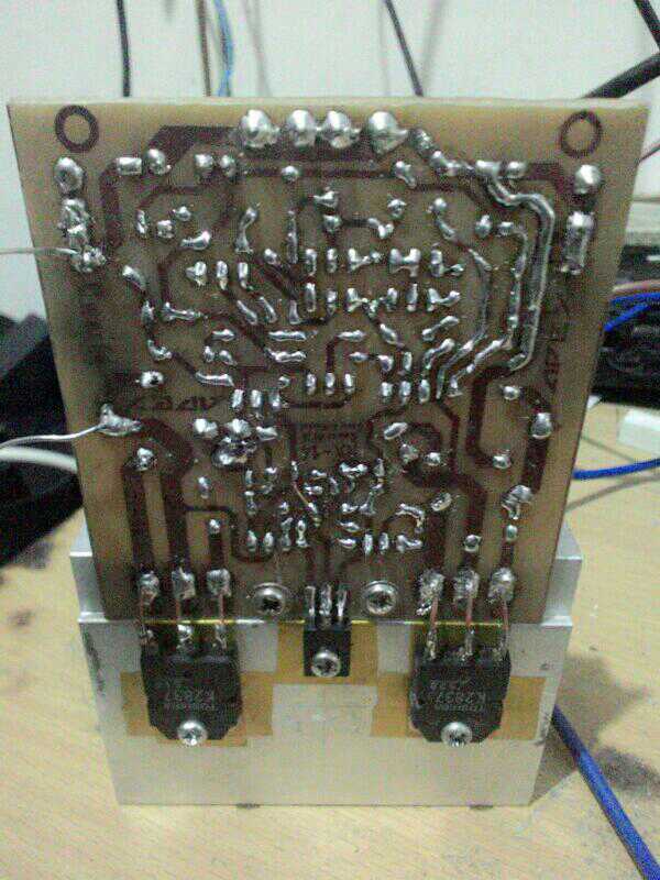

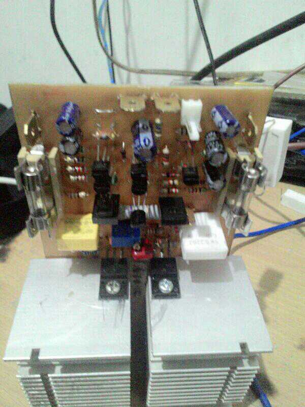

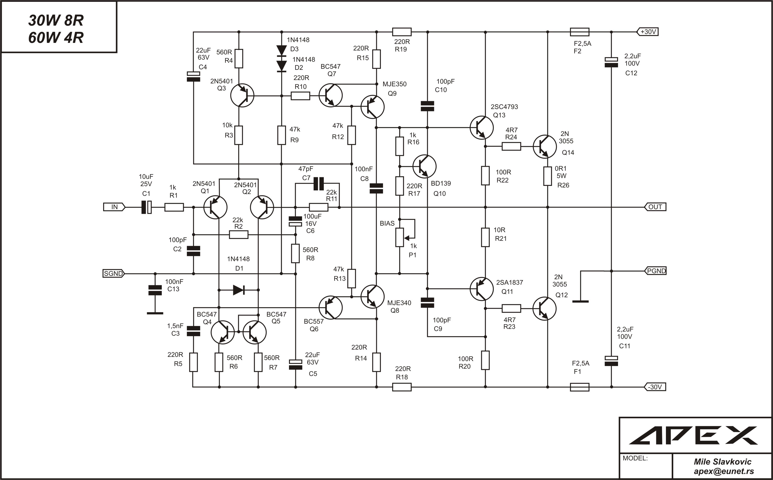

Any change part??
Hello mr. mile.
Any change part if use IRFP260N & 2SK2698 in NX-14??
i still got DC out 29V, use 2SK2698, i dont know where is the problem.
NX-14 with some mod. thanx
regards
Hello mr. mile.
Hello mr. mile.

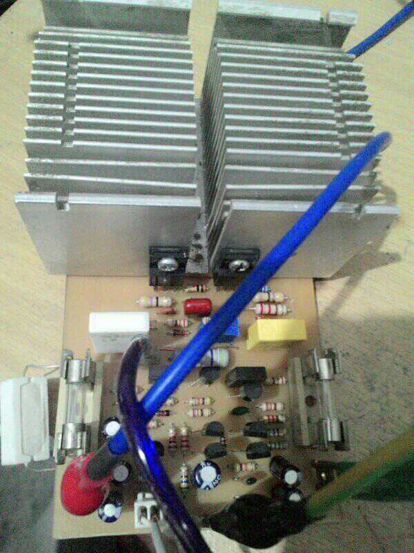

Conect input gnd to psu gnd
Find the problem. Fake transistor. Singing now. With 30volt, bias 10mv only(test). Thank you.
Regards
View attachment 464761View attachment 464762

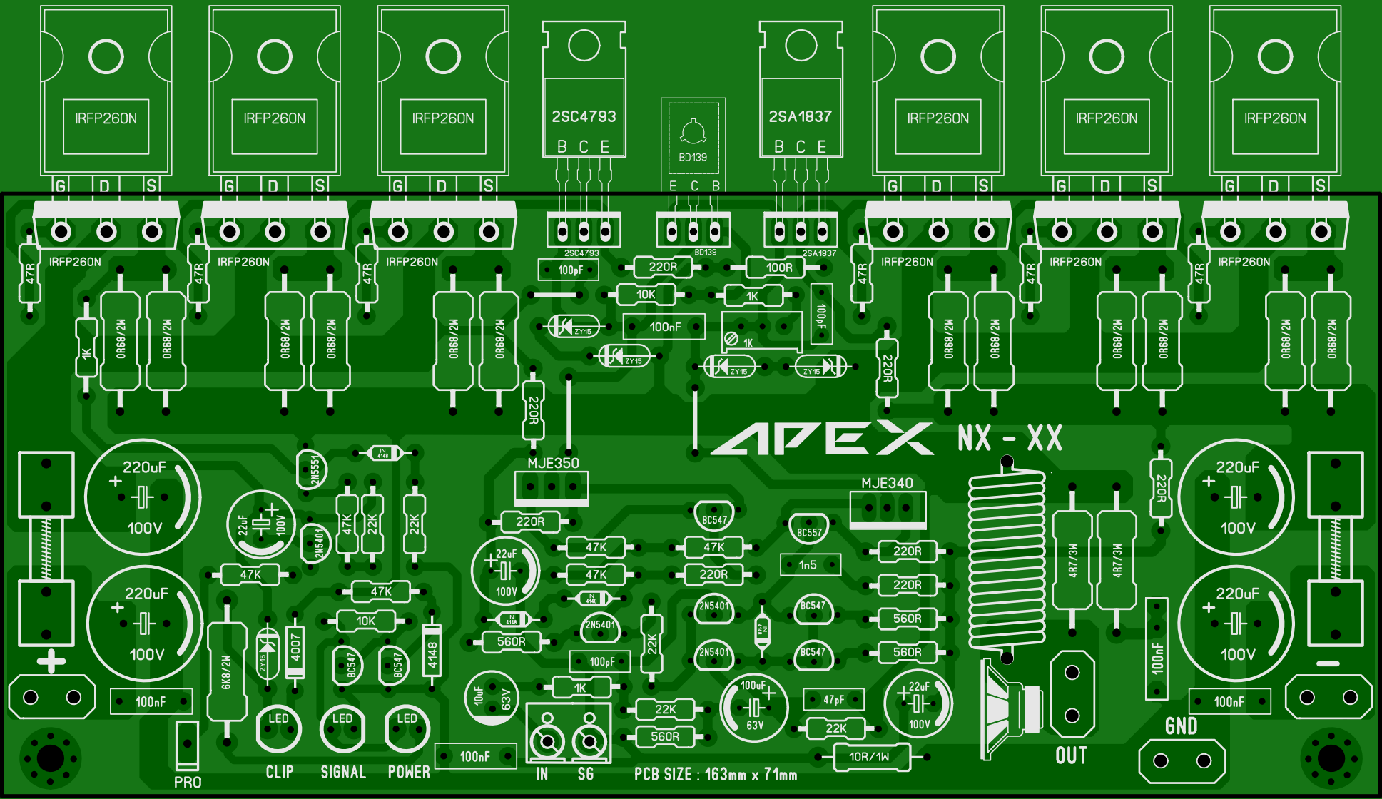

need more output
can add more mosfet, like AX-400?? maybe NX-400 shematic please.
this mosfet amp can have more output power N-mosfet? like 3 each side?
i have a lot IRFP260 from smps scrab.
thank you
regards

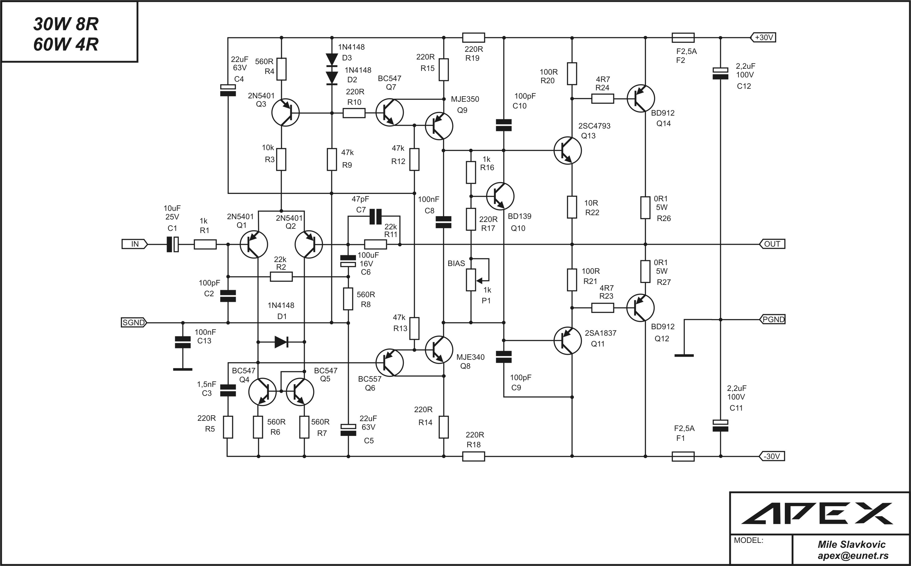

Use this schematic for 3 pairs,
Regards
