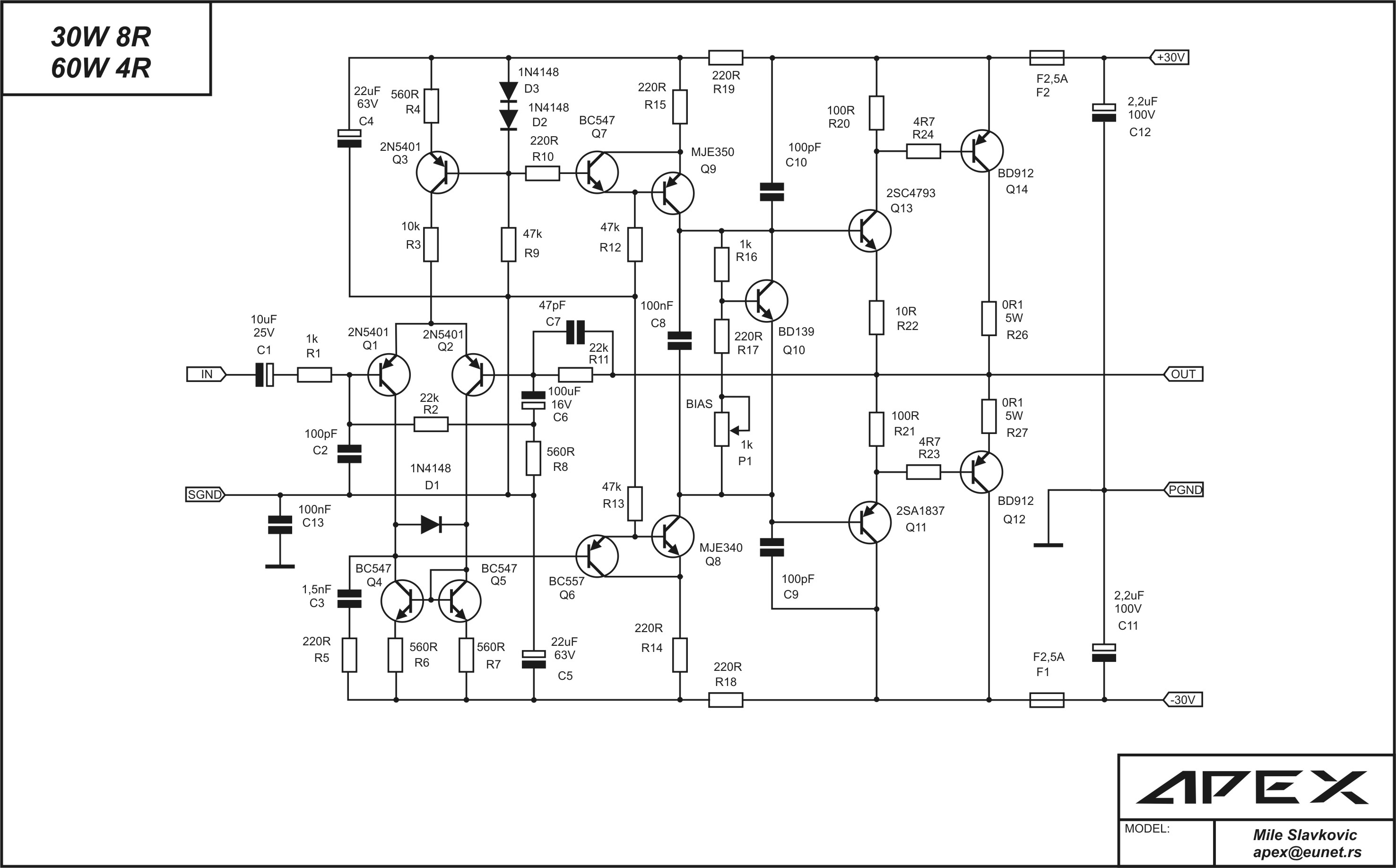

Hello Mile,

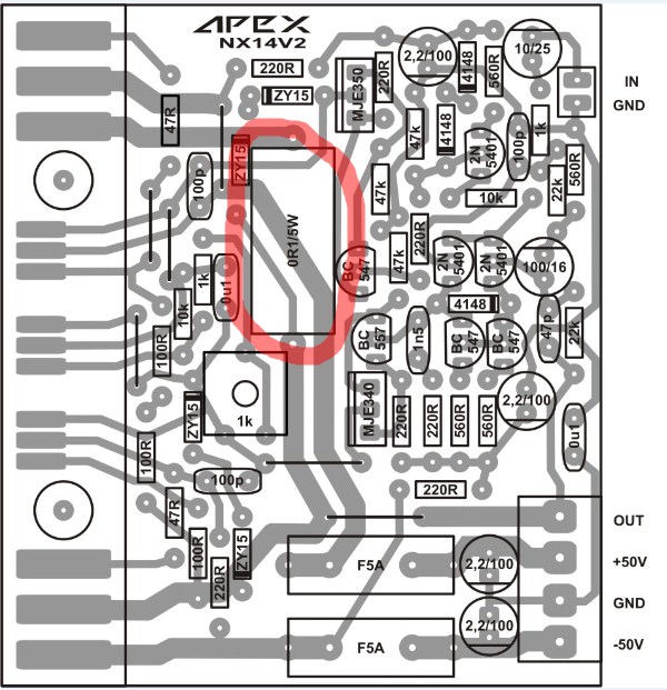

I'm an new hobbiest, and started an subwoofer amplifier which is simple and choosen making D14 from post #31 Sch and Post#34 Wiring Daig and PCB. (Selecting this amp cause its an autobais)
My PCB is ready for further. Here i have some queries as follows.
1. C4, C12, C11 polarity is reverse - Schematic or PCB-Post #34.
2. R3 - 1K Missing from part list. Plz correct me.
3. R18, R19 - 82R instead of 220R - is it ok.
4. R17 - 330R instead of 220R.
5. May you suggest any PSU and Protect for this amp.
Thx & Rgds, Anjan

Hi Mr.Miles..
I'm so interest about kelvin amp.but any problem for me about some part like the transistor
in my place is so hard to find it.I need your suggesting..can I replace MJE340/MJE350 with BD139/BD140 and BDW83D/BDW84D with 2SC5200/2SA1943? thank

With +/-40V dc rail you can use BD139/140 instead MJE340/350 and TIP142/147 or similar darlington transistors, 2SA1943/2SC5200 can't be use it's not darlingtons.
Hi..Mr.Miles
How about 2N3055/MJ2955 can use instead BDW83D/BDW84D.thanks
Regard
No, only darlingtons can be used, if you have promlem to find it I suggest AX11...

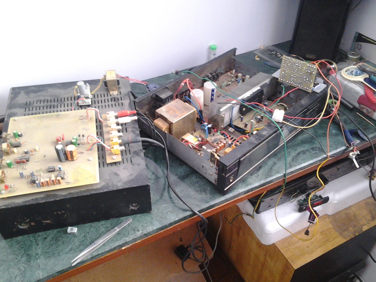

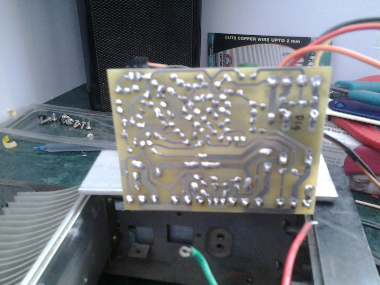

Hi..Mr.Miles
I was tried build the kelvin amp and I follow your advice for the part where I can substitute.MJE340/350 instead BD139/140,MPSA13 instead BC517 and the final trans.I use TIP142/147,and the result have a problem.the out put current is 6 volt more and sound come hum.what is a wrong there? I made PCB with transfer toner and I was checked for the polarity
is correctly.thank for the answer
Hi..Mr.Miles
Post pictures and don't forget to connect input gnd to psu gnd with separate wire.
I was build like this,and I put the gnd from psu directly for input and output.I tested with 12V,than I checked the output current come 6,13 volt dc.please tell me if any mistake with this picture.

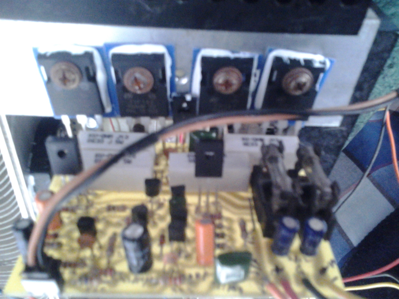

one more I have finished build AX11,when I test with 12v it is no problem,and sound is good enough I checked dc current from the output is come 0,03mv.but when I connected with 30v,one resistor with value 47R is burning.I used 47R / 1/2 W.Should I use up 1watt?the resistor is burning from positive rail.thank for all.
Best Regard

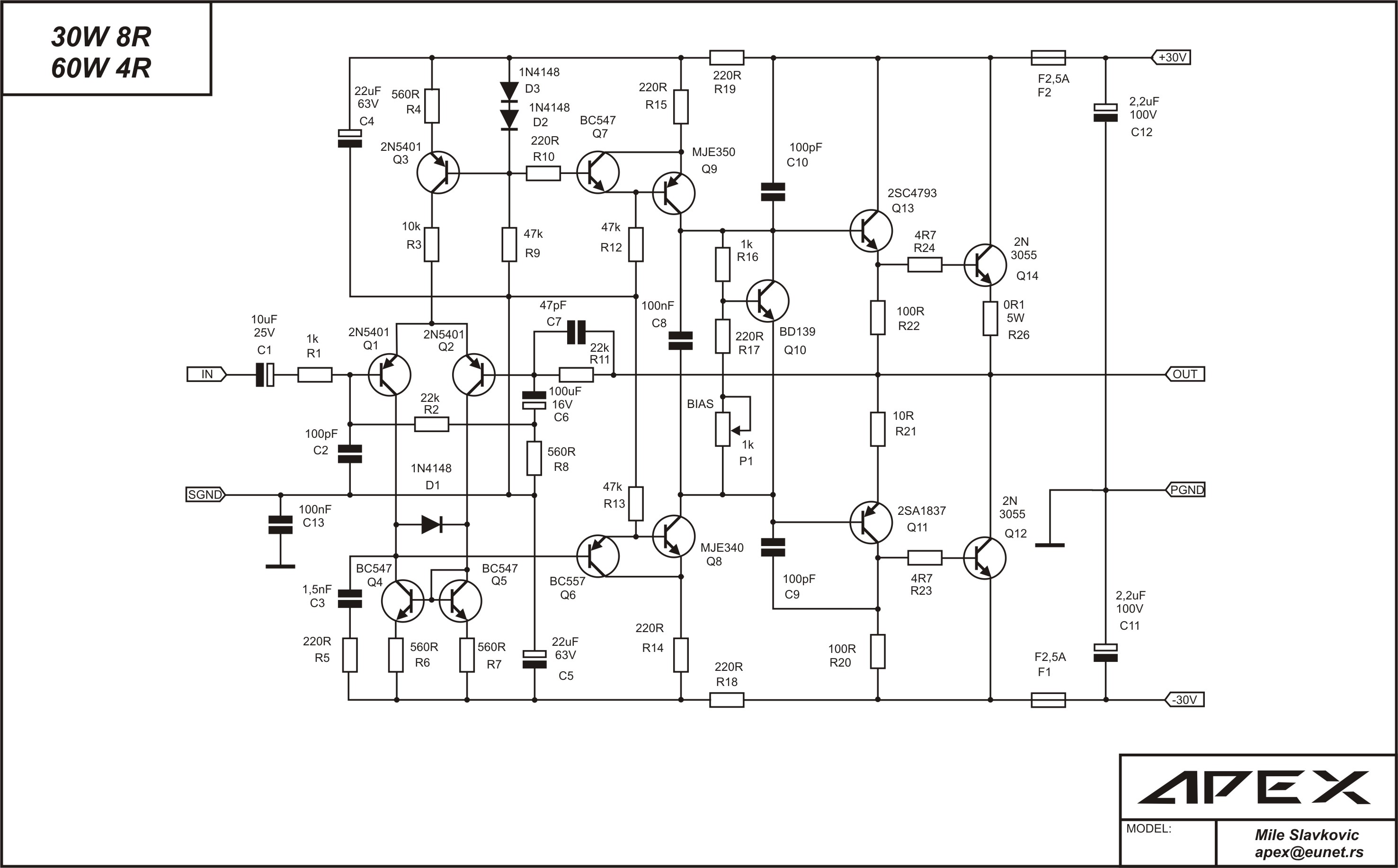

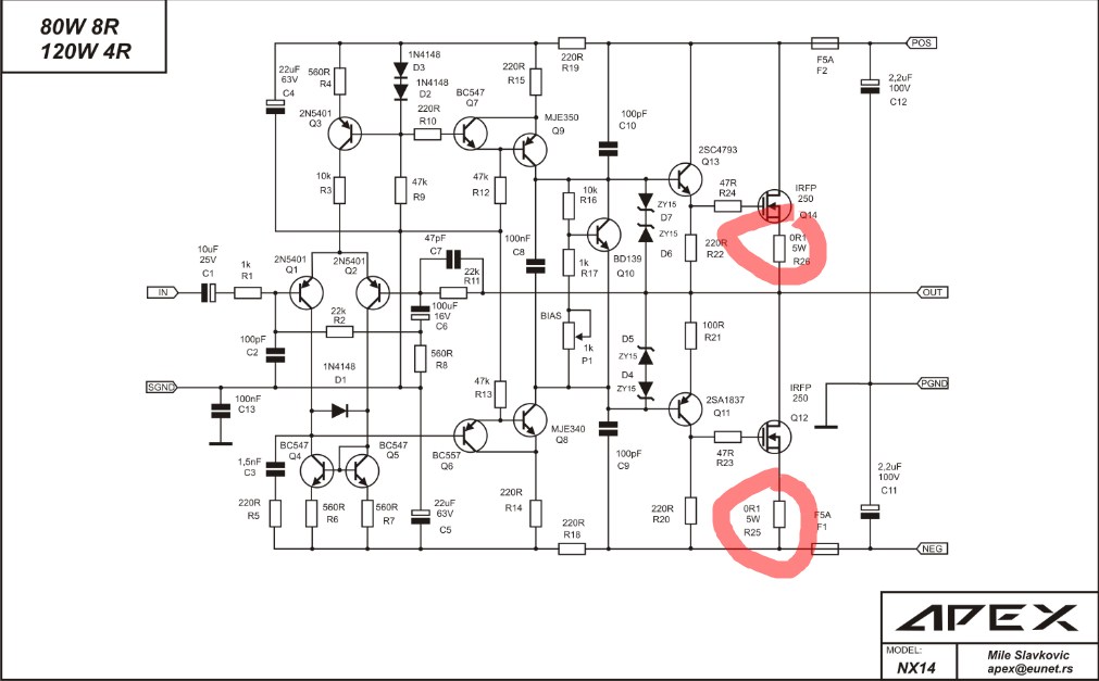

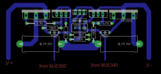

Ask for schematic difference

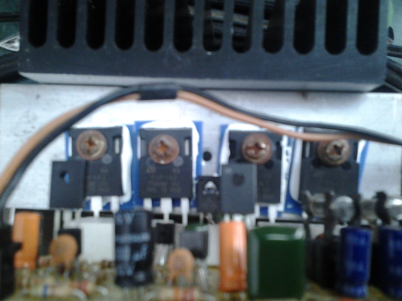

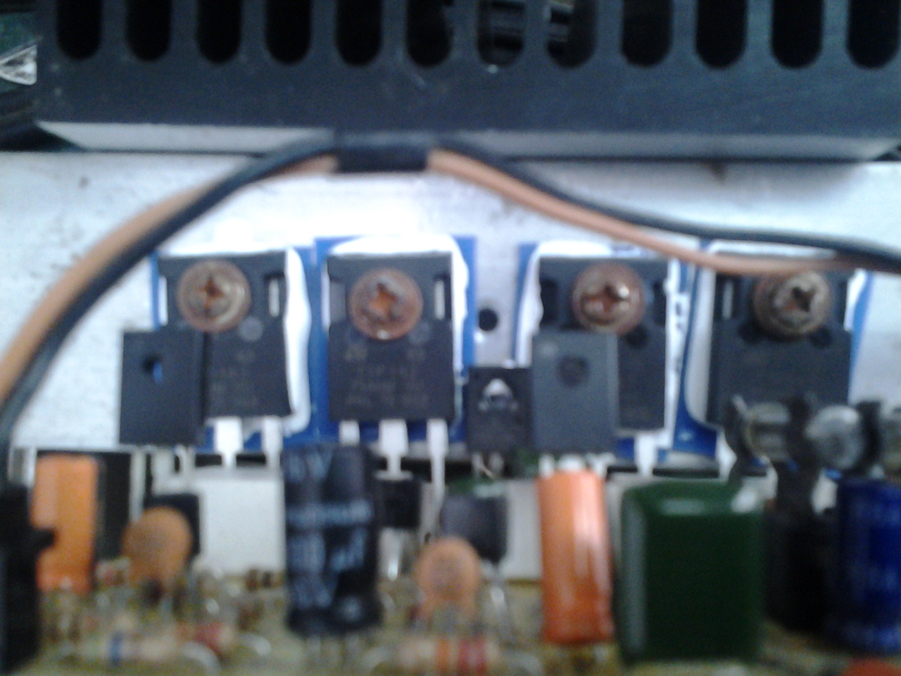

Mr. Mile, in your schematic use final NPN transistor only, how to change for use PNP only, i have a lot off PNP trans with no pair.
second, why in your schematic use 2pc 5w resistor, but in pcb use one only???
Quasi PNP
Thanx Mr. Mile for replay, so just little modified from ax14 pcb & schematic
